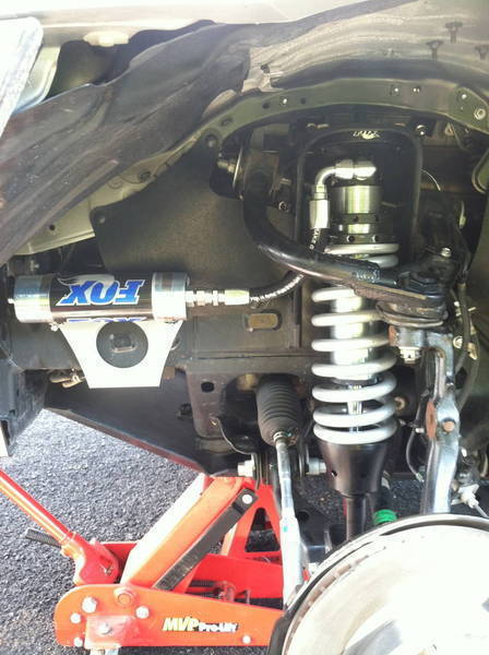

    Yes, the limit straps will prevent top out of the shock and also prevent ball joint binding. I think they will really help me dial in the down travel of the shock.
    With my set-up, I got the regular travel fox shocks and lifted the truck 3" leaving little droop... 1.5" or so at the wheel....75" on the shock. You can top the shock out pretty quickly with that little droop limit. I am pulling the shock apart tonight to take the spacer out to make them extended travel. A little birdie told me there is a 1/2" spacer in there that prevents them from being extended travel. So, thats coming out tonight. That will give me more down travel but I still want to prevent the shock from topping out with the limit straps. I think I may also drop the lift to around 2.75" or less to get even more out of the shock.
    The Icons come with rubber top out spacers inside the shock which prevents you from hearing the slap. The Walker Evans have that too I believe. Fox does not.... thats why you hear the slap in them. Fox claims its ok to hear it... I don't believe any topping out of the shock will be good in the long run. Thats me though. So, thats where the limit straps come into play.

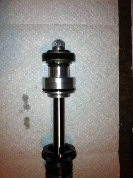

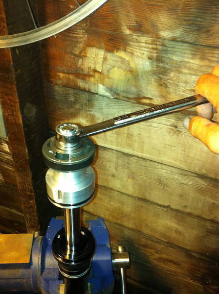

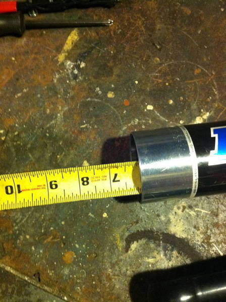

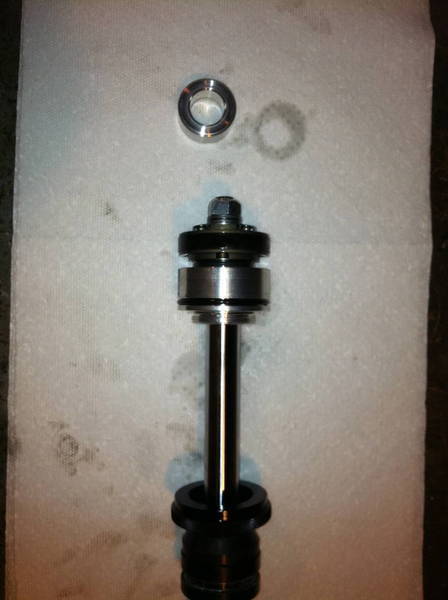

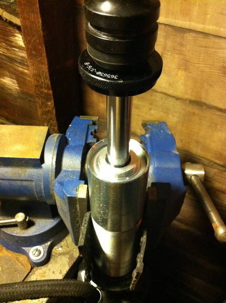

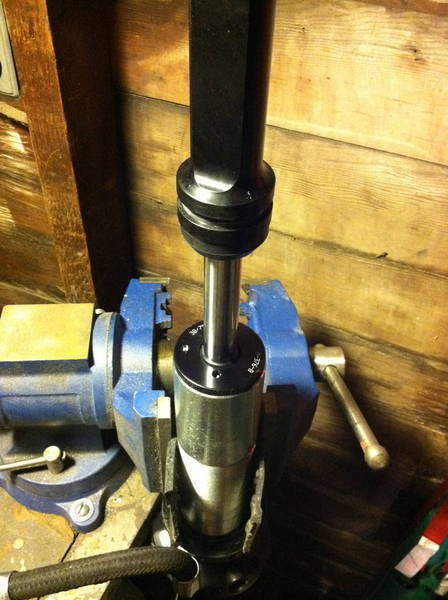

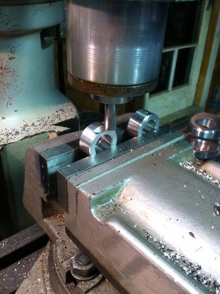

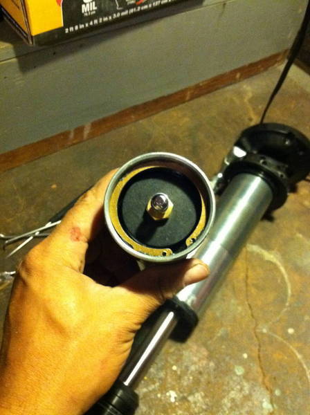

    So, I took the FOX 2.5's apart to extend the travel this past weekend. Fairly simple straight forward job. I followed this link to take them apart and put back together. The one thats taken apart in that link are 2.0's but are very similar.
    I pulled the springs off with a spring compressor and
    Discharged the Reservoir and took the cap out. There was less than 100 psi in each reservoir. WTF FOX!!! Apparently, this is common with not only FOX. So, check your pressure!
    measured the depth of the IFP
    Put the shock body on the bench vise.
    Pulled the bearing cap on the shock body
    Removed the piston from the shock body
    I then removed the top nut from the shaft, pulled the piston, valves and spacer out.
    My friend has a bridgeport so, we milled down the spacer to .415"
    I then installed the shorter spacer back in place, dropped the shaft with piston back into the body, bleed all the air, installed the bearing cap, put the spring on and charged the reservoir with the correct 200psi.
    Rides really nice!
