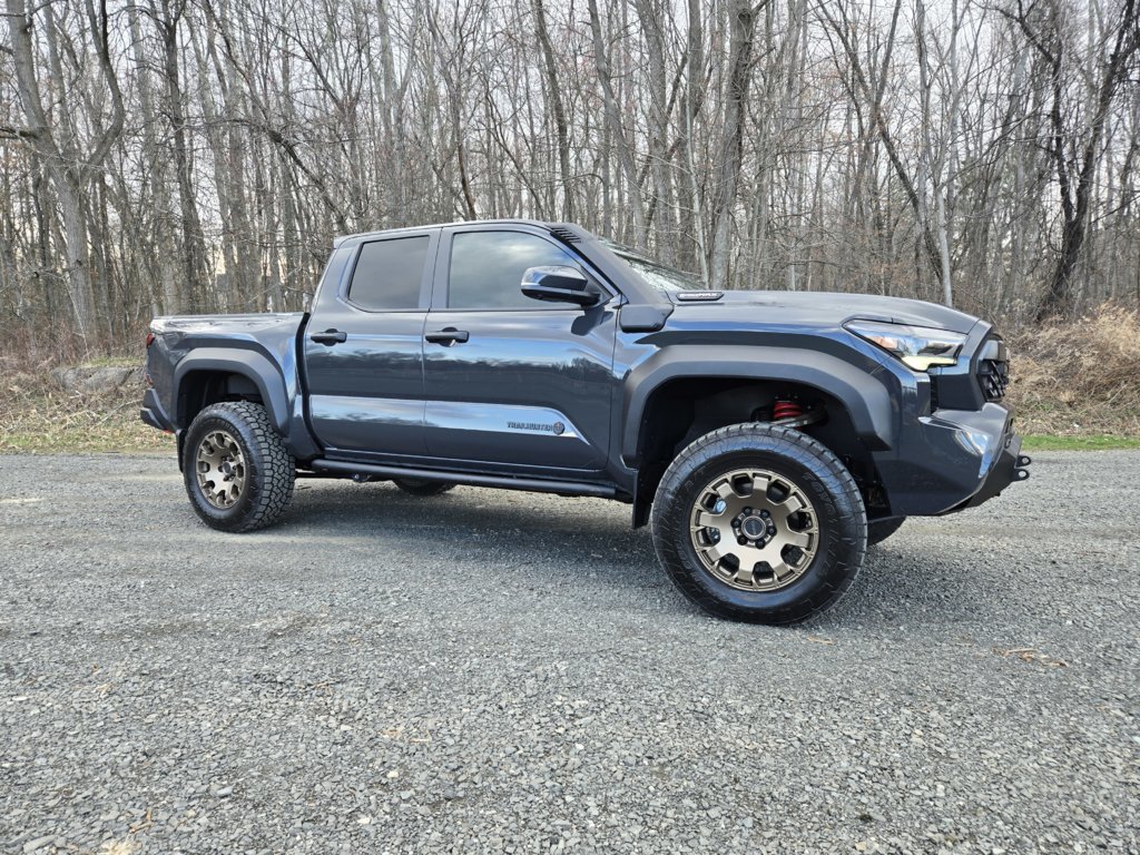

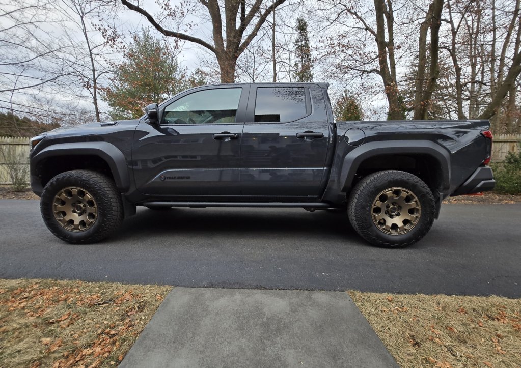

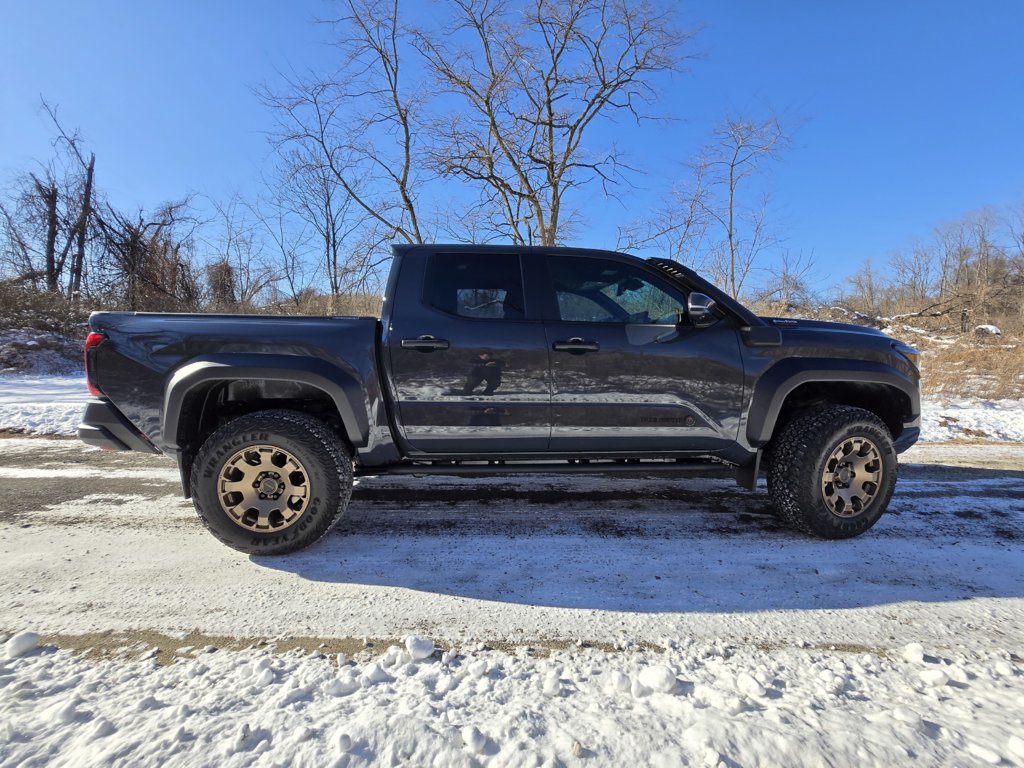

    Here's the Trailhunter stock

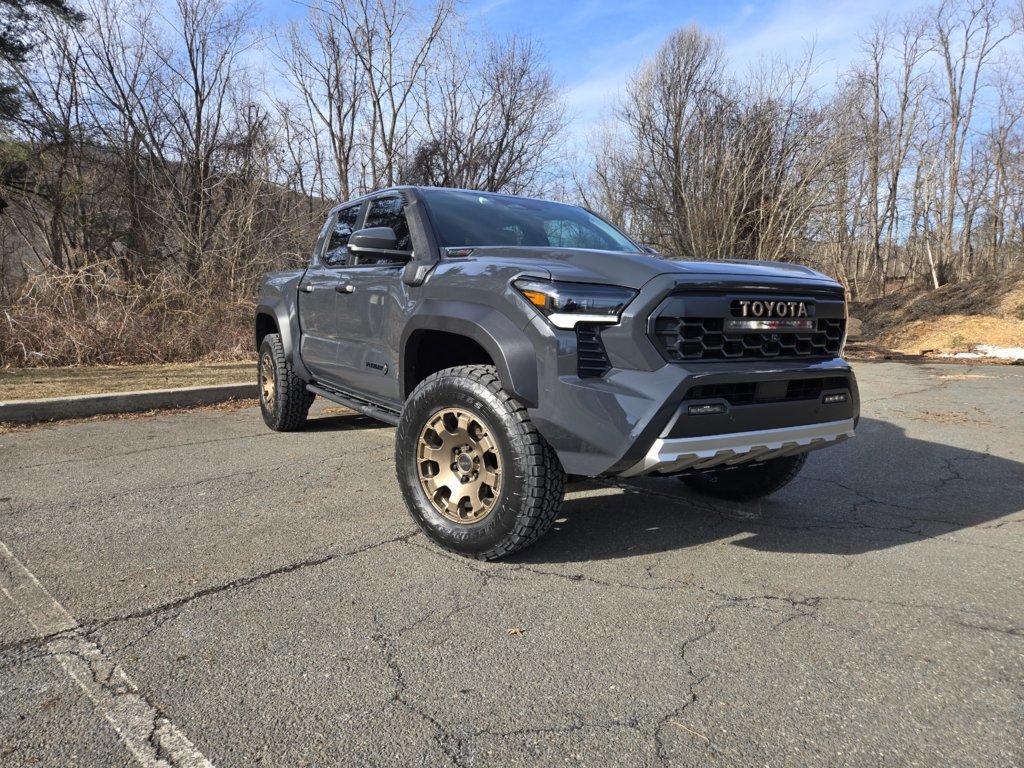

    This is the Trailhunter prior to lift

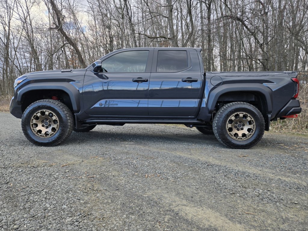

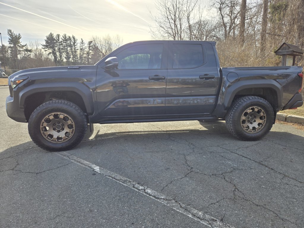

    This is the Trailhunter today

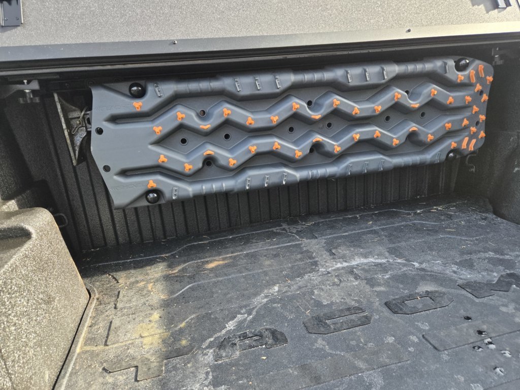

    Added arb traction boards and the hi lift. Made some brackets to mount the boards to the hi lift. The hi lift is mounted to the bed rail t slot

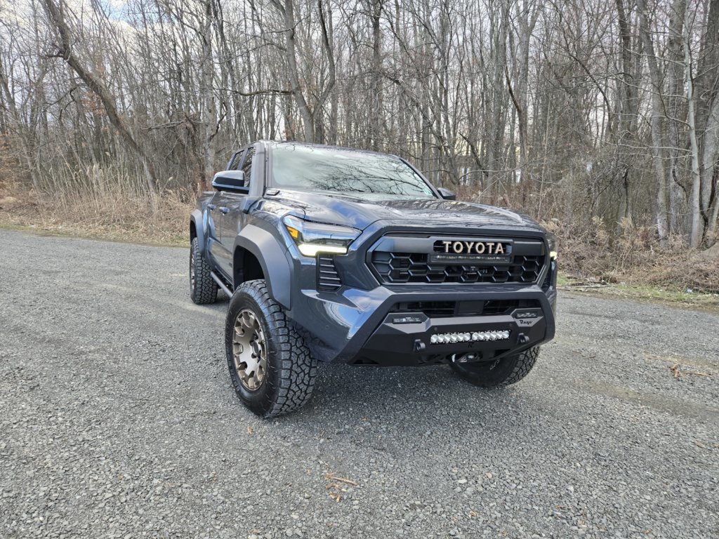

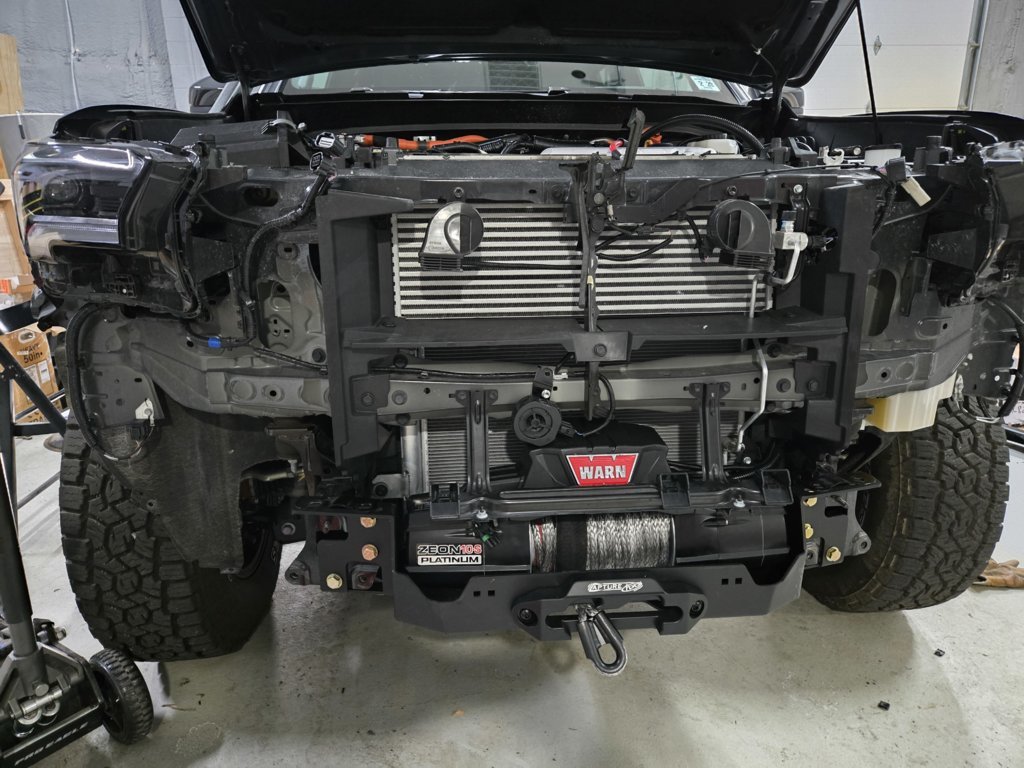

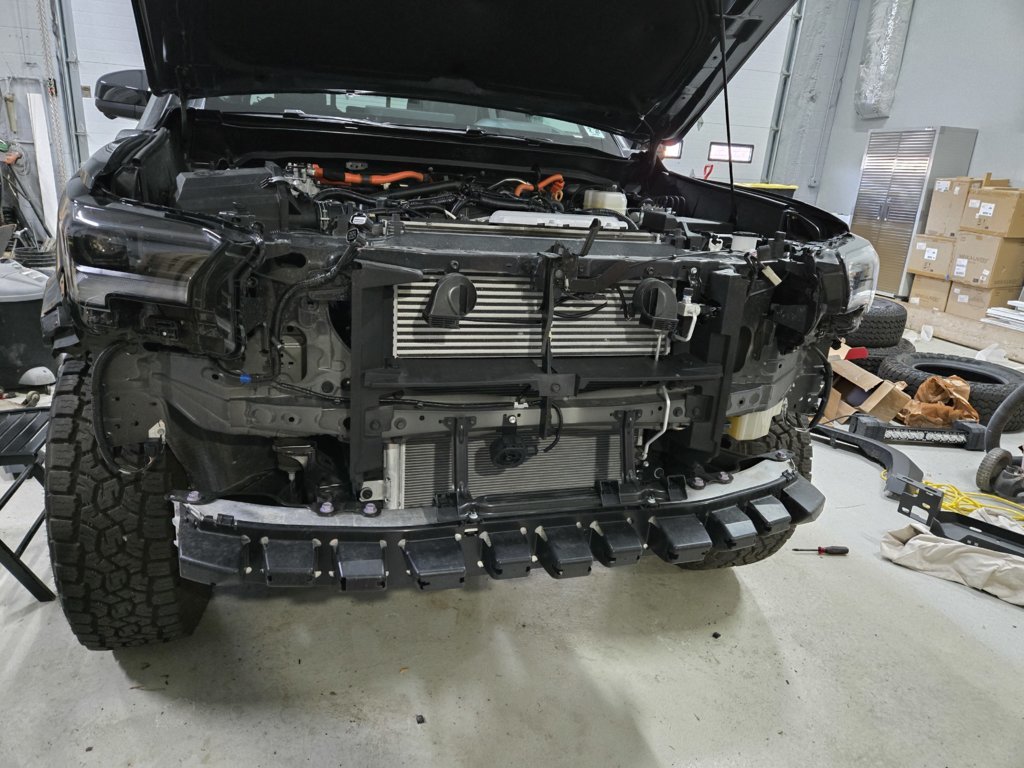

    I ended up going with the Rago center mount bumper, warn winch and Stinger relay hooked up to Aux 2 switch.
    I received the Rago bumper Friday. They gave me a deep discount on it try out as they never fit them on a Trailhunter.
    Beautifullly made and very robust. Fitment once I made some modifications to the bumper for the TH is perfect. I installed it yesterday.
    Rago only accounts for the standard model fogs. The rigid fogs project out further (about 3/8")so I had to modify the opening with a die grinder to be 1/16" wider each side of the opening. I assume all other fogs on the Tacoma are recessed more and sit behind the bumper.

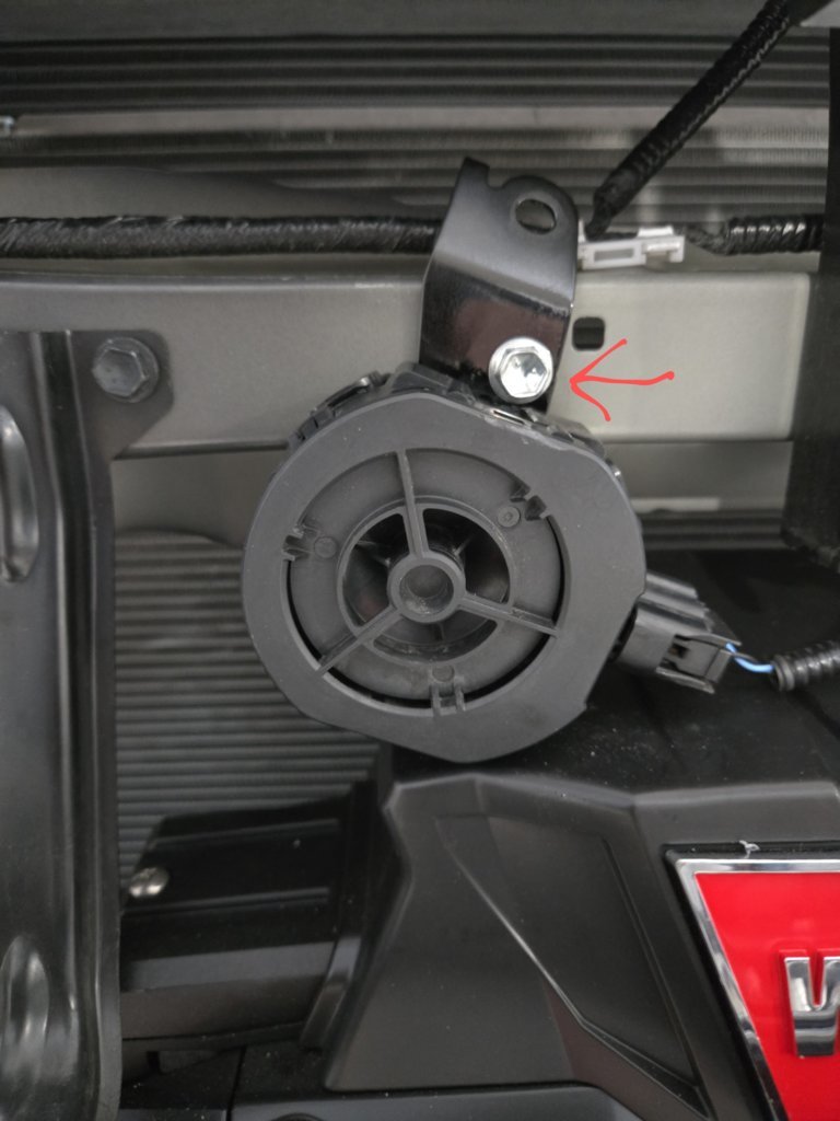

    I also had to relocate the hybrid noisemaker behind the grill to clear the winch. Very simply drilled a new hole in the bracket to move it up and out of way.
    To maintain the existing factory metal grill support and if Baja design fog lights are utilized, you need to cut the bottom of the support bracket lip off. It contacts the Baja design light bar when trying to install the bumper. i believe the metal grill support is critical for additional support. Some just remove it all together.
    Minus modifying the bumper.... Easy for me... this bumper works perfectly with our TH. I gave this feedback to Rago and hopefully they will have a bumper for us TH and Pro owners.

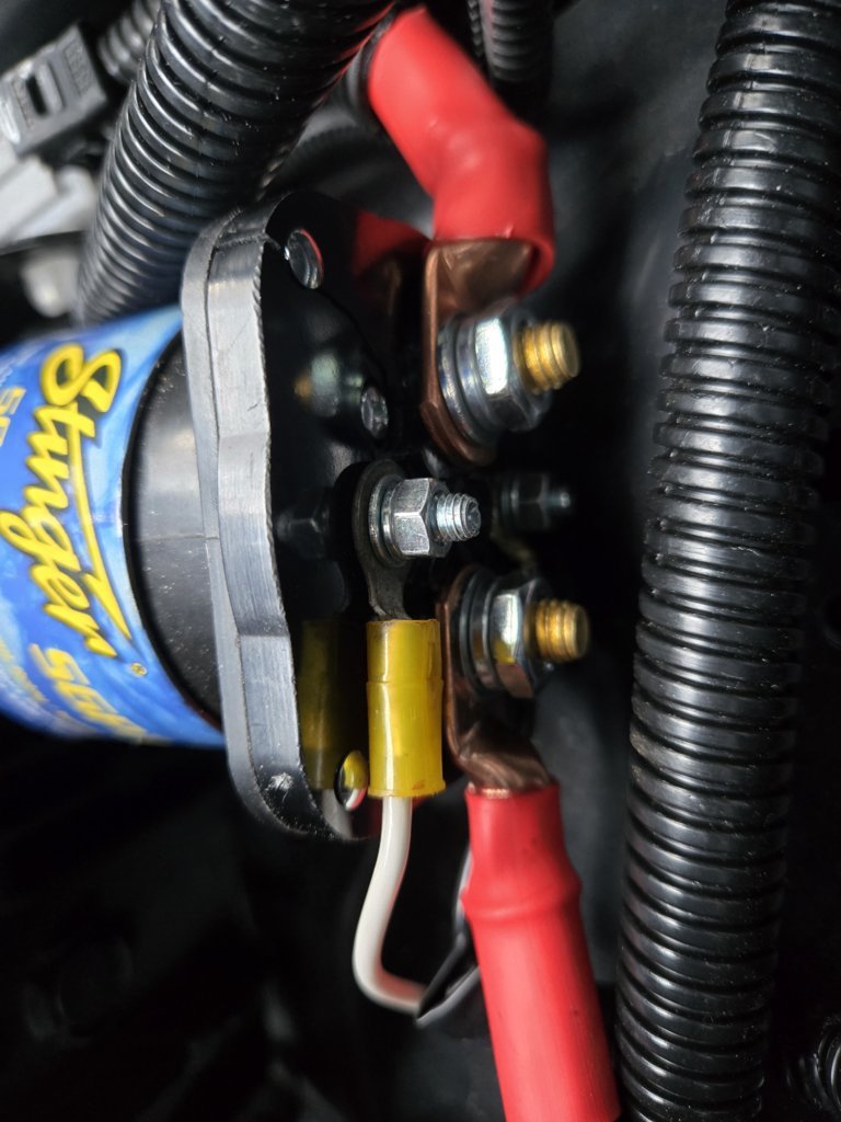

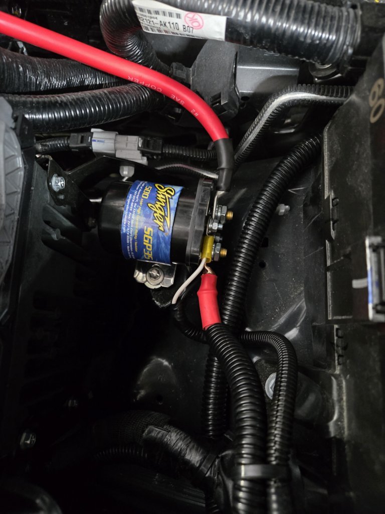

    This is how I installed the wiring for the winch:

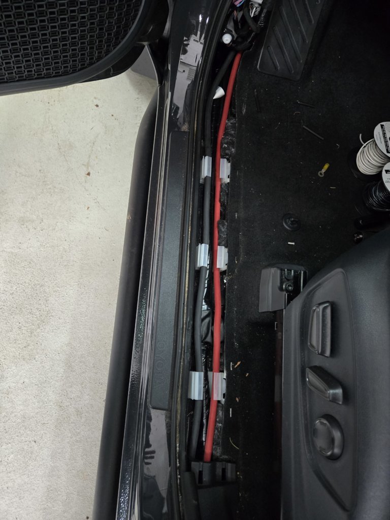

    Stinger relay located on on driver's side towards the front of the wheel well. 2 gauge power cable goes from there back to the battery under the rear seat. 2 guage ground cable goes from battery to the winch. (2) 14 gauge wires (power and ground) start at the Stinger relay and go to Aux 2 located in the left side of the drivers side panel. All the wires were protected with wire loom after install.

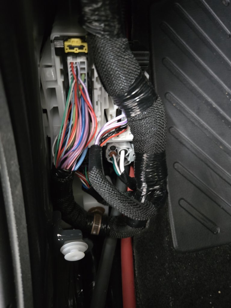

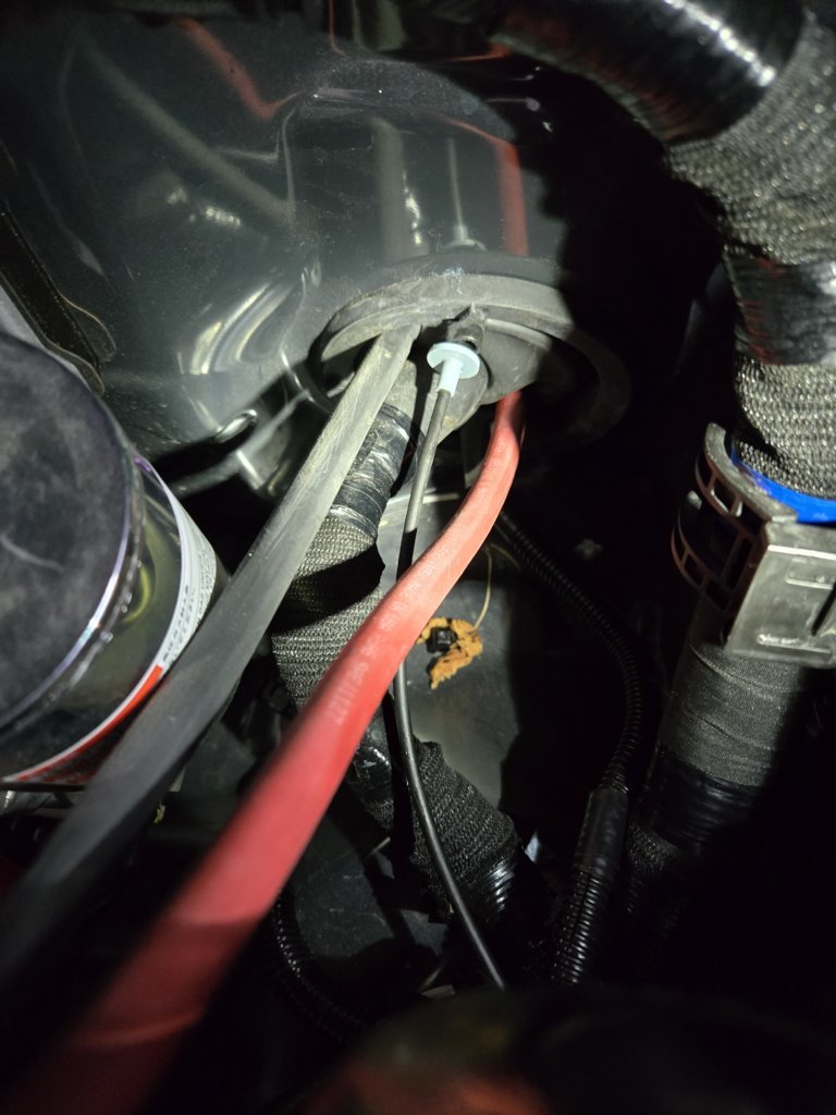

    Both sets of wires go through the fire wall gromet. I made a tiny slice in the rubber gromet to pass the 2 gauge wires through. The 14 gauge wires go through the rubber gromet nipple. Just cut the end of it off.
    This is where the aux 2 connector is located. Toyota provides the pig tail to make the connection. You will connect both of the 14 gauge wires to the provided pig tail.
    Here's where the 2 gauge cables pass through the front door sill
    This is where the 2 gauge cables pass through the rear door sill and connects to the battery
    Rago tray and winch installed
    Back together after a bunch of hours. The red circles are the areas I trimmed off the bumper to fit the Rigid fogs

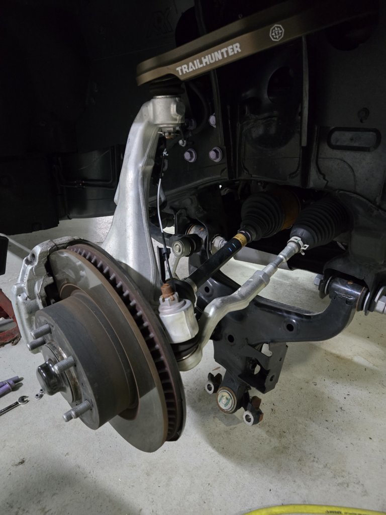

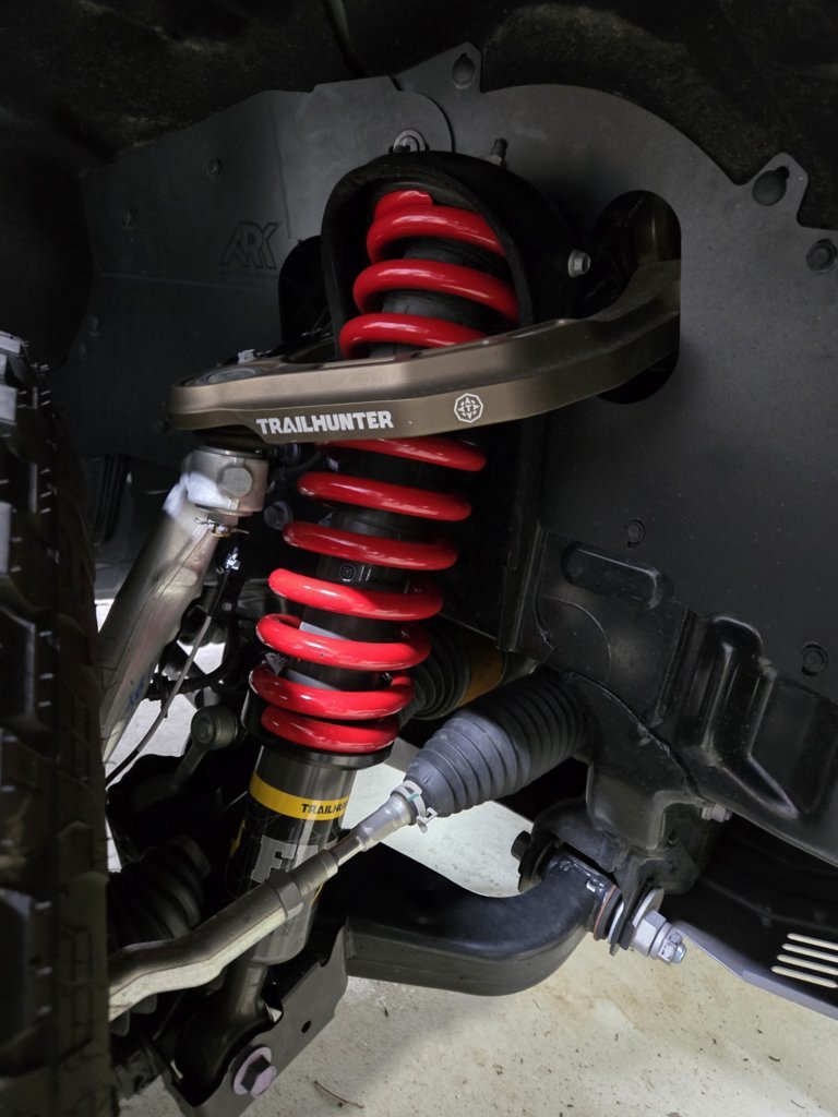

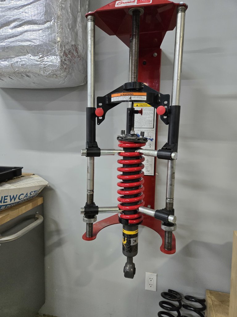

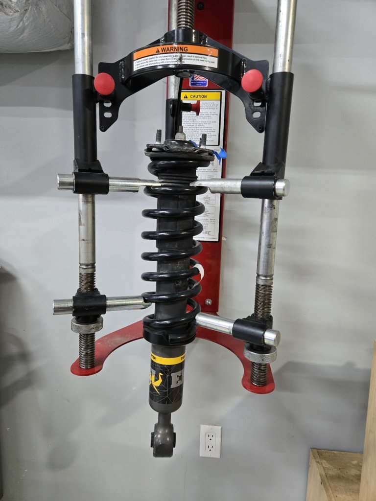

    I added Dobison springs to the front to compensate the newly added front bumper/ winch weight. It also raised the truck by about 1 1/2". I also order the rears but they are on backorder so in the mean time, I installed 1" peak spacers.
    Changing the suspension on this Tacoma might simply be the easiest I've done on any vehicle. Such a pleasure.
