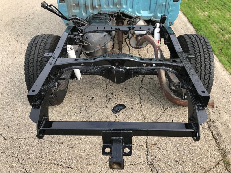

    I picked up my 95.5 Taco with 148k miles in august of 2016 and have learned a lot building this truck. The best part has probably been the people I have met through off-roading and the adventures. This truck has turned into a more crazy build than I originally anticipated but I love it.

    Stuff already completed:
    -Add Safe-t-Cap frame kits to whole frame
    -Paint whole frame with Chassis Saver
    -all new brake components
    -braided front and rear brake lines
    -New air intake hose

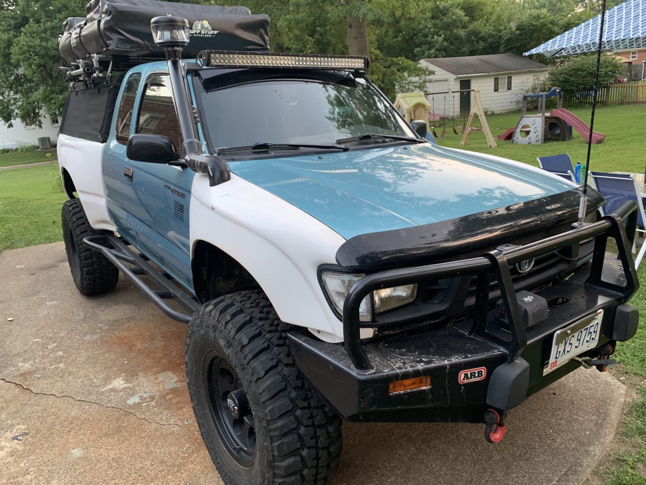

    Body:
    -1in body mount lift
    -AVS bug deflector
    -weather tech window visors
    -Bushwacker fender flares
    -new OEM rear bumper
    -had friend strip the rocker panels down, fix rust and repaint. he also added some chip resistant coating.
    -Had roof repainted
    -Line-X bed
    -Can-Back soft topper
    -window tint
    -Can-Back roof rack (welded tabs to allow 4 bars)
    -Tuff Stuff Overland RTT
    -CB radio
    -ARB off-road front bumper
    -SmittyBuilt 10k Synthetic wench
    -40in light bar with slang mounts
    -Custom made snorkel using 3” exhaust pipe and pre filter.
    -relentless fab Rock sliders w/kick-out
    - front and rear fiberglass 3” over fenders
    -front tubbed to fit 35s
    -Custom rear tire swing out

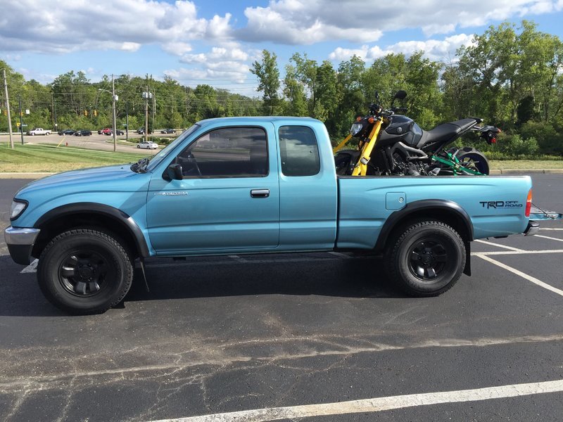

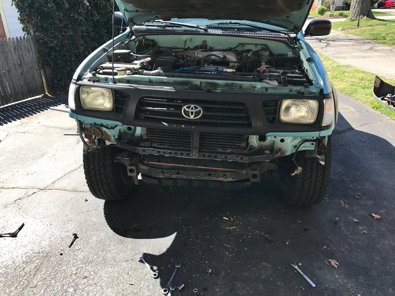

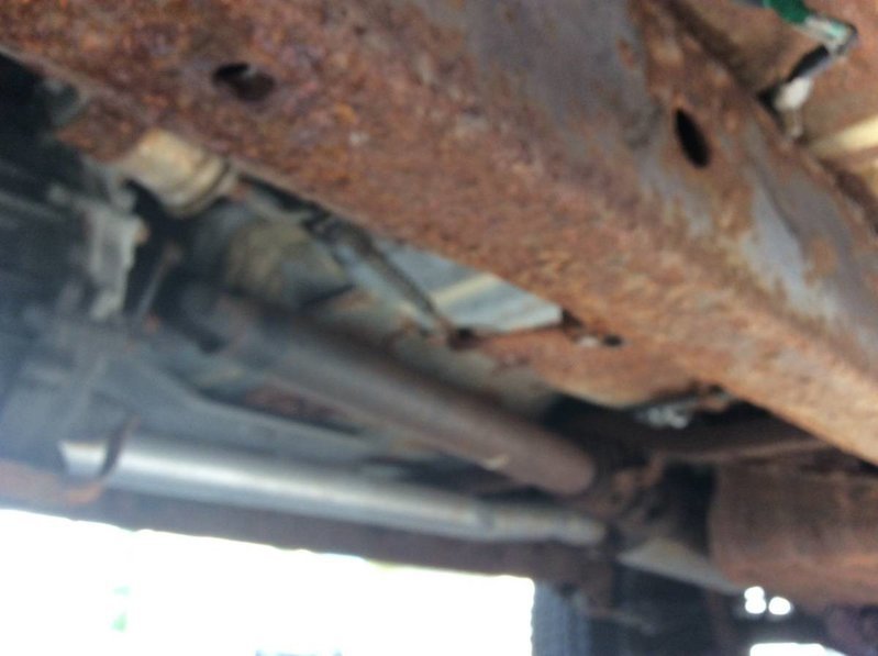

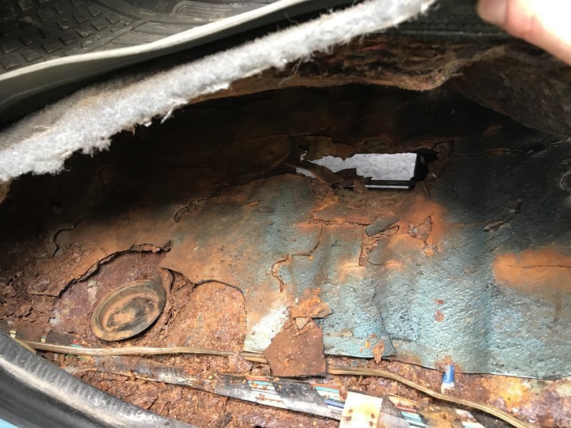

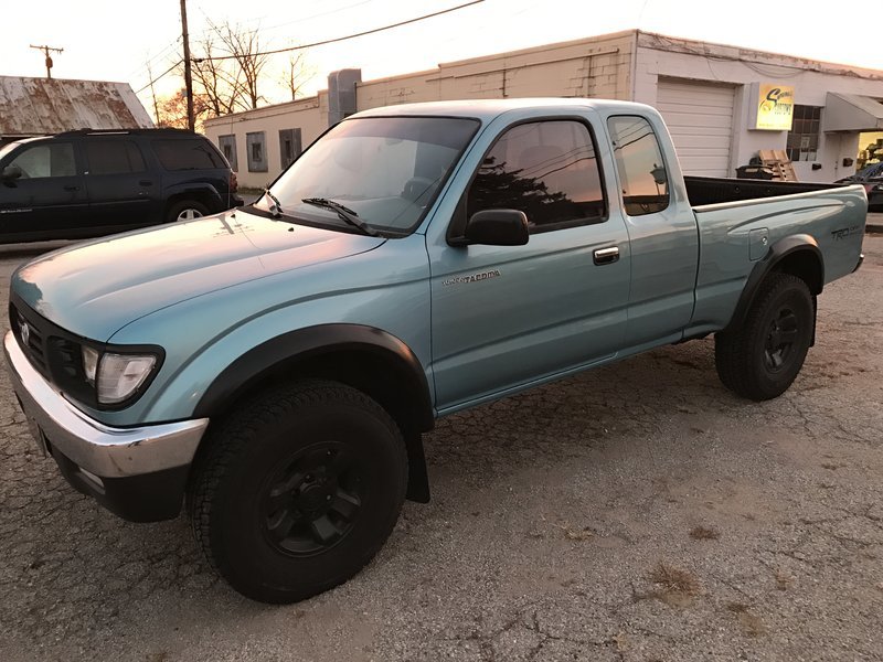

    here are some pics of when i first got the truck

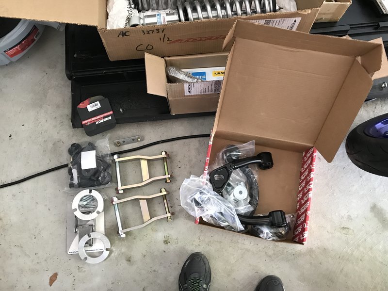

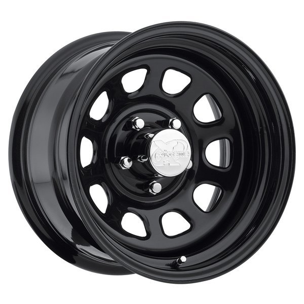

    Update: Here is a little update to my build. Just got a bunch of things in.

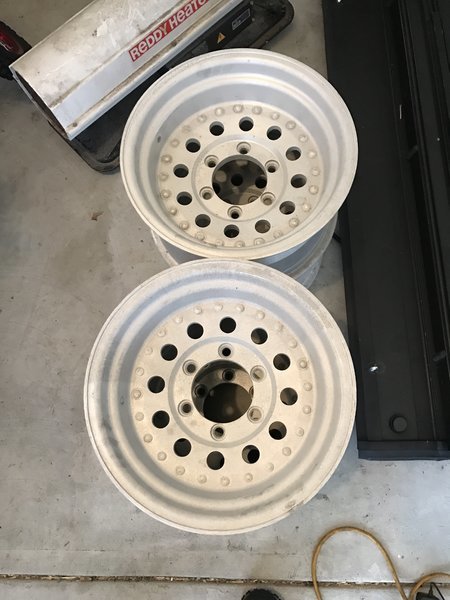

    -15 x 8 rims (pictured) are getting painted black
    -blistein coilover lift kit with AAL
    -diff drop
    -extended Ubolts
    -1in DayStar body lift kit
    -also picked up a used BakFlip tonneau cover
    The only thing I need to purchase before install is my tires. Just trying to find a good deal on some BFG KO2s. going with 33x10.5 r15
    hopefully going with tires not as wide and the extra inch of body lift will keep me from rubbing at all.

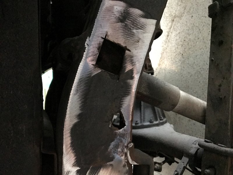

  7. Apr 27, 2017 at 8:37 AM
    halo07
    halo07 [OP] Well-Known Member
    Nov 17, 2016
    #202601
    226
    Aaron
    95.5 Tacoma ExCab LX V6 5 Speed

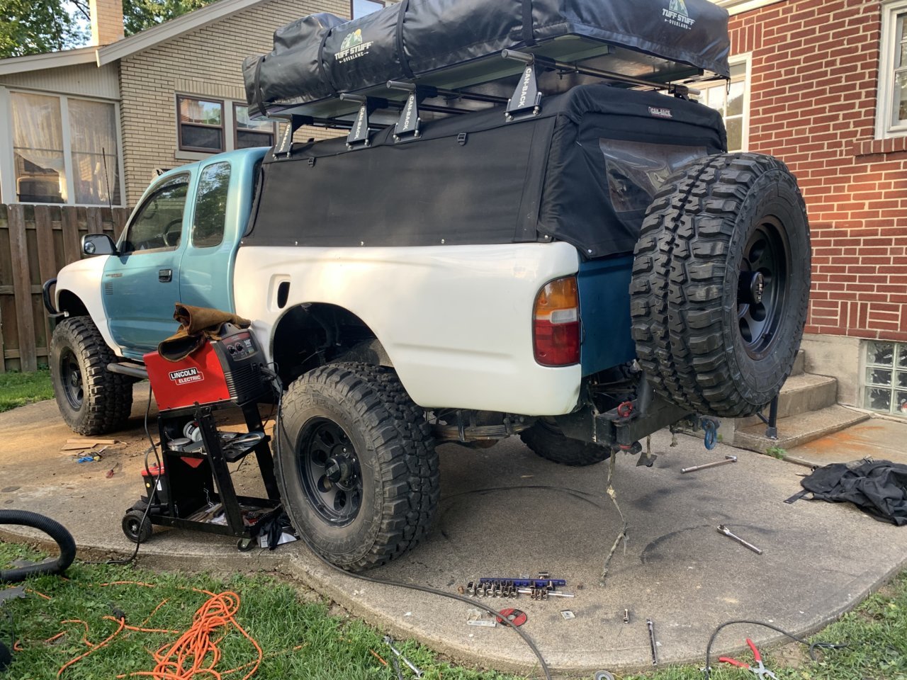

    *Couple updates*
    -Working on getting a oven right now so i can try to powder coat my wheels myself. Should be able to start that here in the next couple weeks.
    -All of my lift parts have come in and all I need is my tires once I finish powder coating my rims. Probably going with a gloss black but open to suggestions.

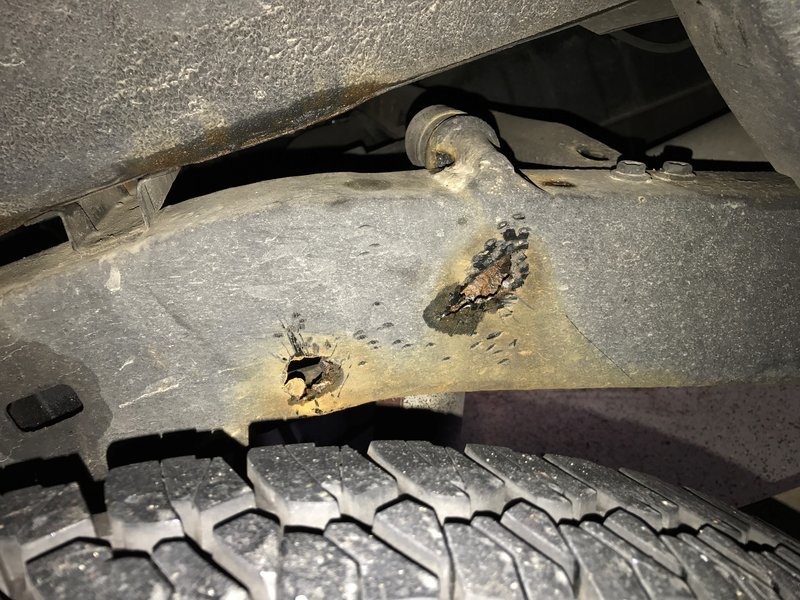

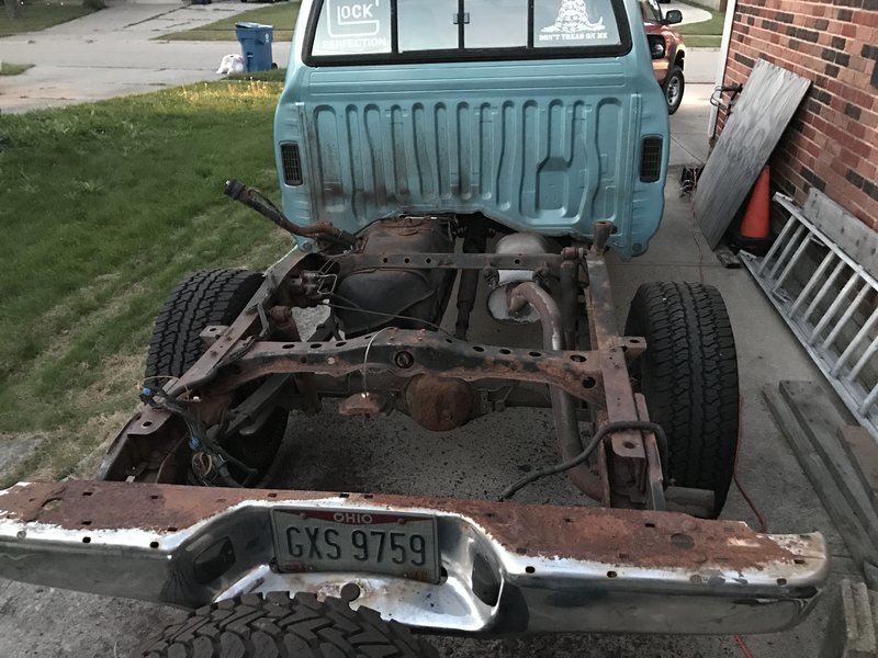

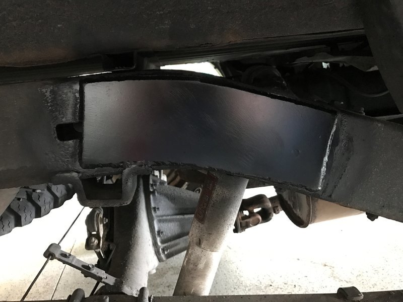

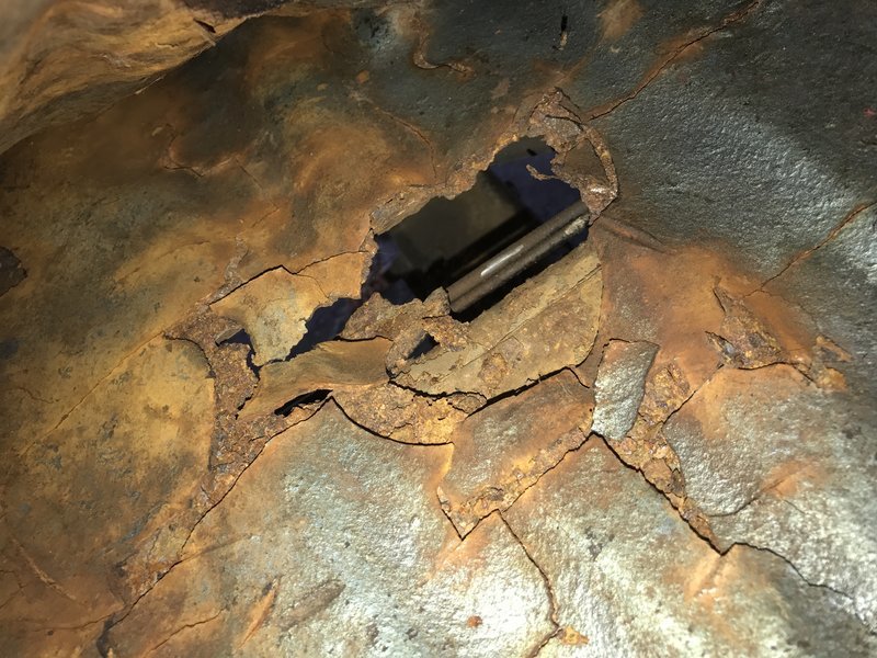

    -I found a 2 more rust spots caused from trapped dirt inside a boxed in part of the frame under where the passenger shock attaches to the frame. We ended up using some pretty thick metal to patch it. I hit everything with Chassis saver again once it was done.
    -Had a hell of a time battling with the body mounts when replacing them with the 1in body mount lift kit but its in. When installing the kit I found a nice hole in the floorboard on the driver side. Rest of the floor looks perfect
    -The truck is at my friends shop getting a little more paint work done to the lower bed rockers and he has made a new floor board for the driver side. Should be good as new by next week. I will post more pics then.
    Wondering if anyone has a idea for fixing the 1in gap in the rear bumper? For the front I'm going to make brackets.

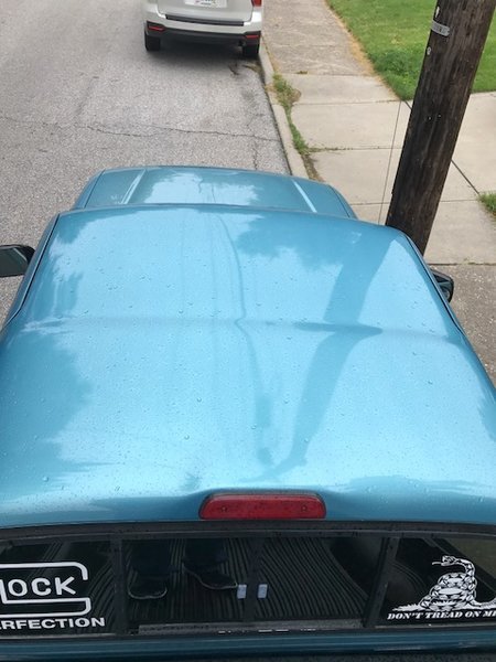

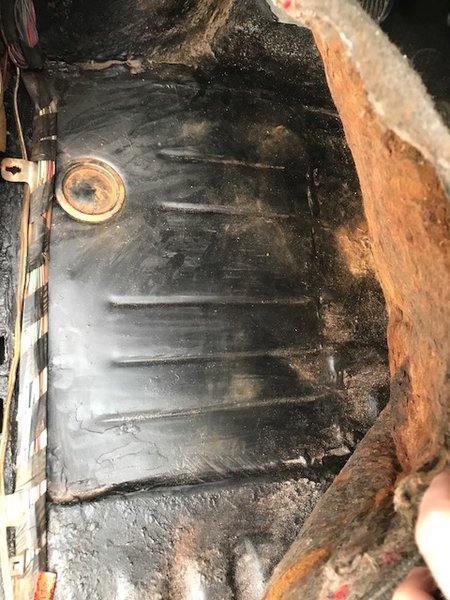

  8. May 24, 2017 at 9:43 AM
    halo07
    Nov 17, 2016
    #202601
    226
    Aaron

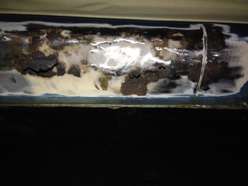

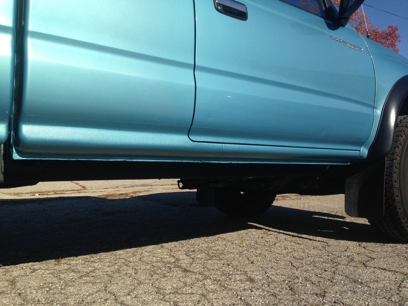

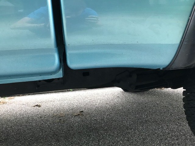

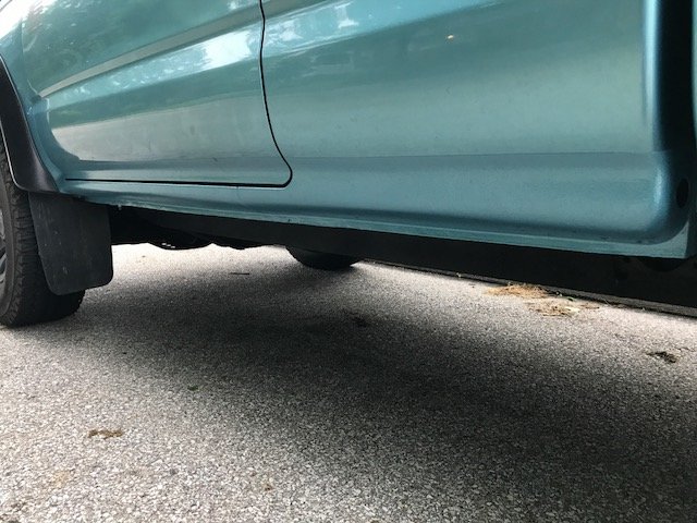

    Just got my truck back from my friend. He repainted the roof because all my clear coat was gone making it look pretty bad. He also touched up my rockers on the bed in front of the rear tires along with adding color matched chip resistant coating. The last thing he did was custom make a floor board patch for the hole pictured above. looks better than ever now.

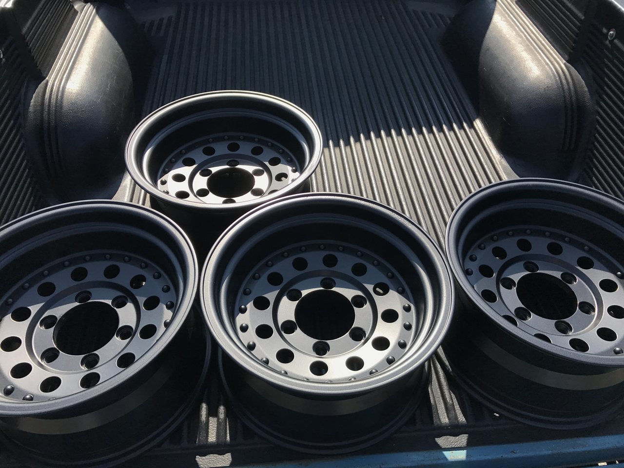

    Well I gave up waiting on a friend to clean out his garage so we could powder coat my wheels. Took them to a local place last week and just got them back. Going to start getting my lift installed now that the rims are done.
    ChadsPride, UncleShrek and boostedka like this.

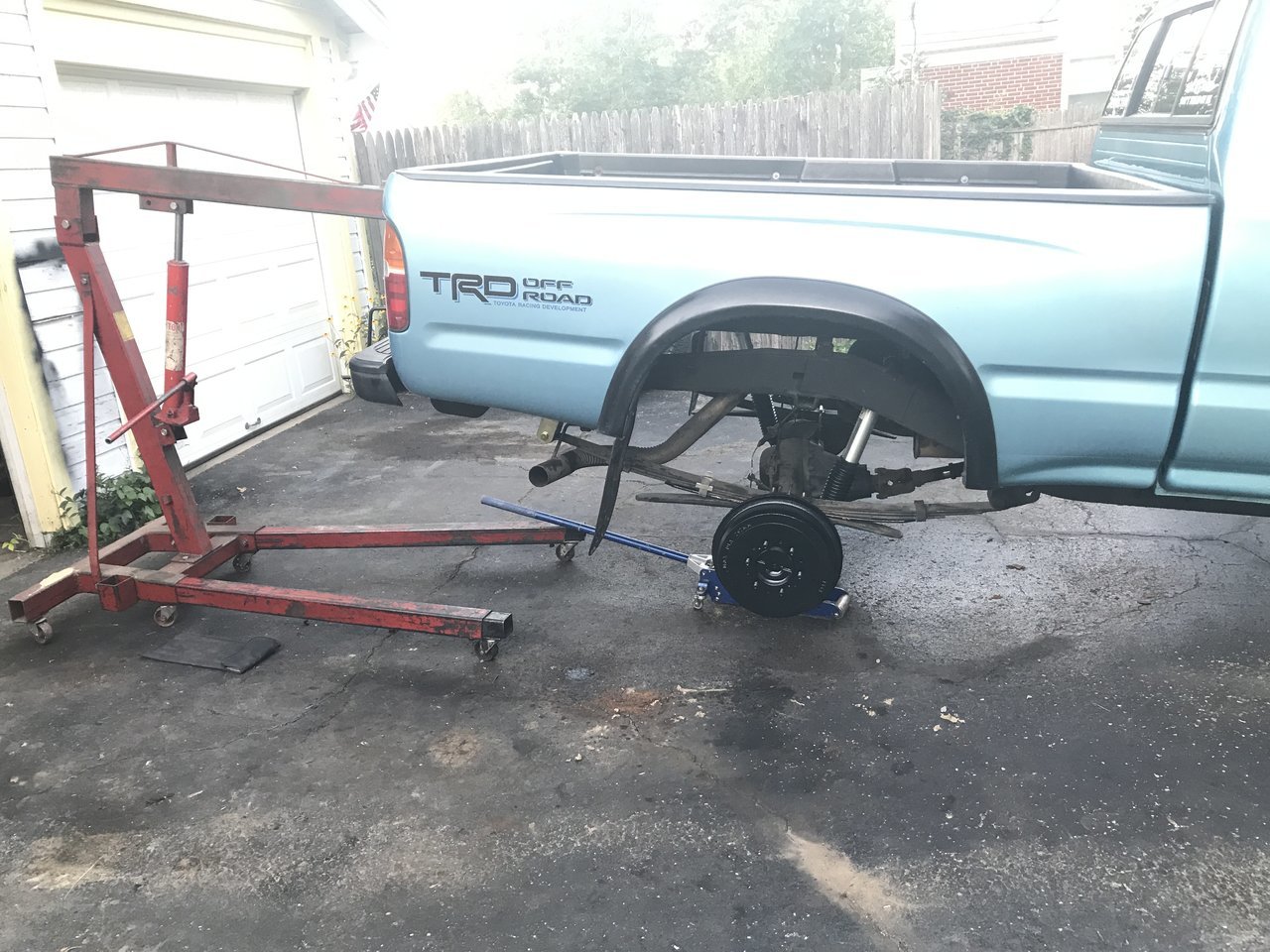

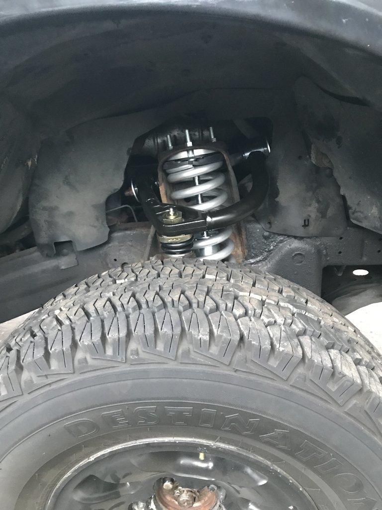

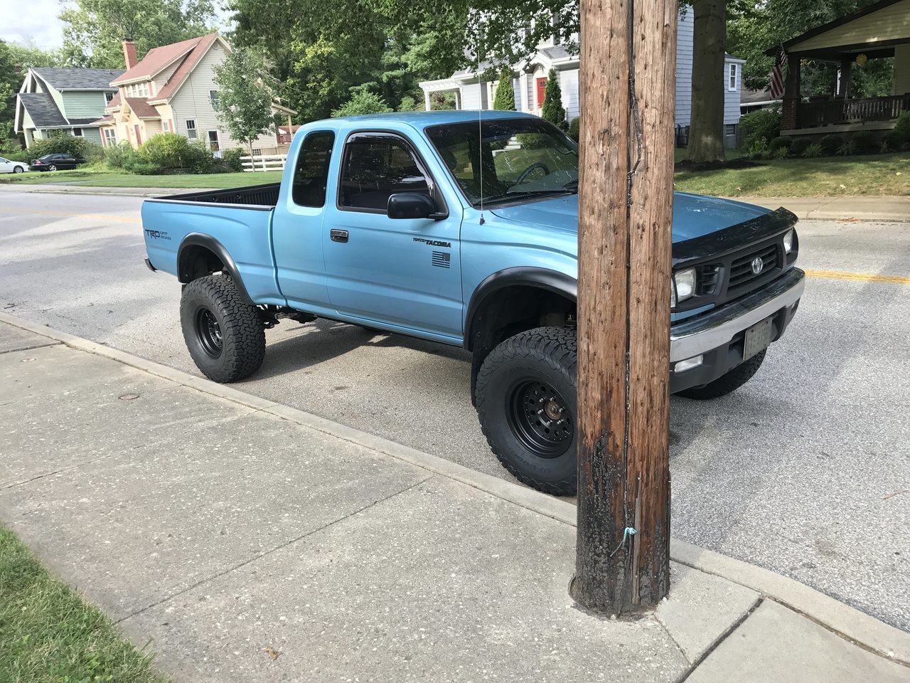

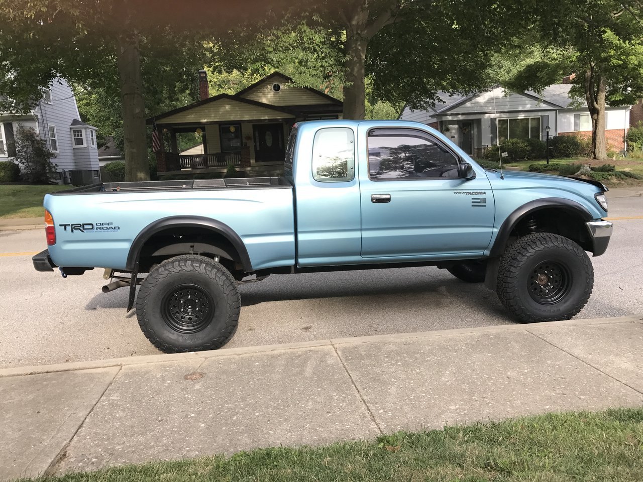

  16. Jul 29, 2017 at 6:49 PM
    #16
    halo07
    Nov 17, 2016
    #202601
    226
    Aaron
    All the rake because race truck!!
    Just finished the rear tonight, going to start on the front tomorrow.

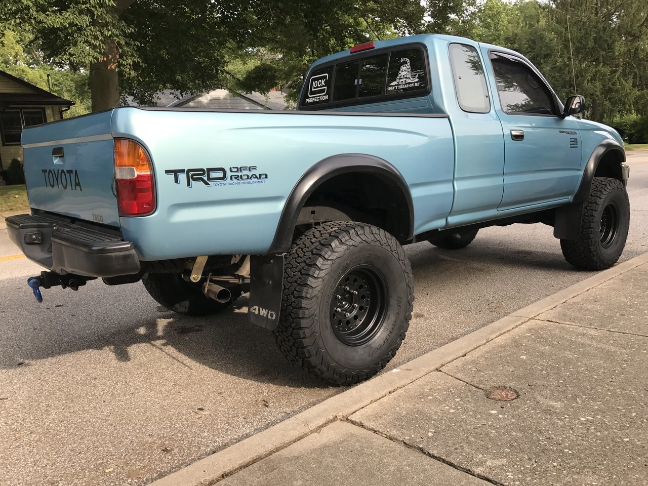

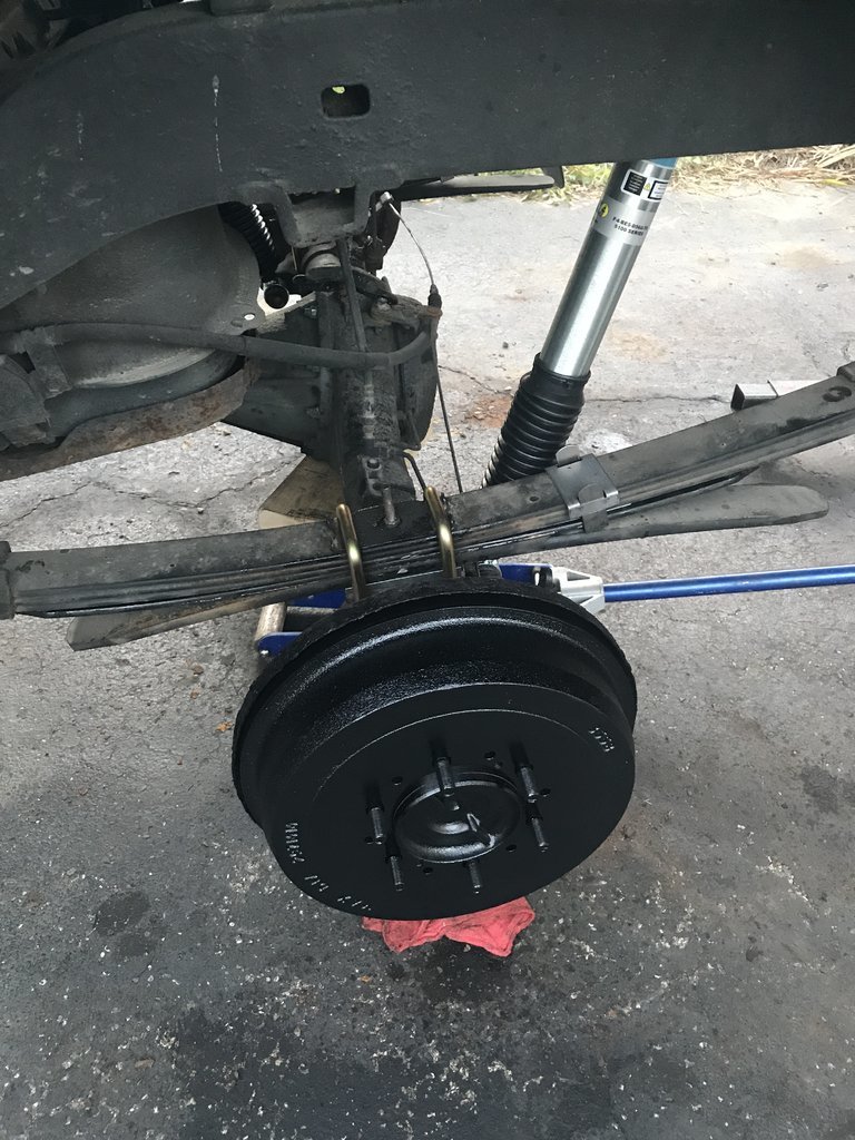

    Today I installed 5100 shocks, 2in add a leaf, 3 degree axle shims, 1in lift shackle and all new hardware. I also painted my drums black since I just replace all brake components a few weeks ago.
    Tomorrow I'm installing 3in coil overs, diff drop, upper control arms with upper and lowe ball joints. Also adding a 3/8th spacer on top of the coil. All this with my 1in body lift should give me 5in front and 4in rear.
    33x12.5in Tires are on order. I should be dropping my truck off to have rims and tires mounted on Tuesday.
    ChadsPride and UncleShrek like this.

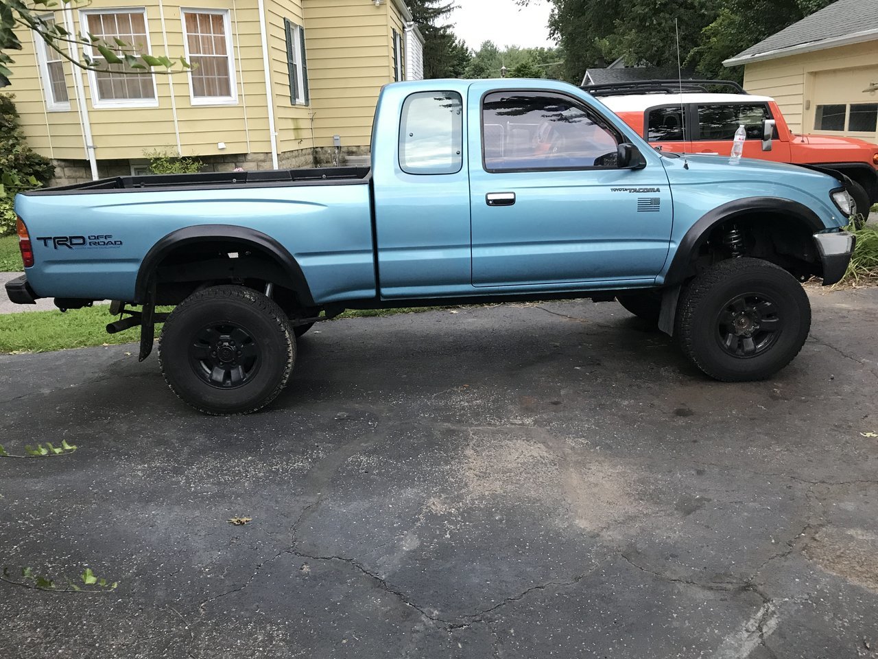

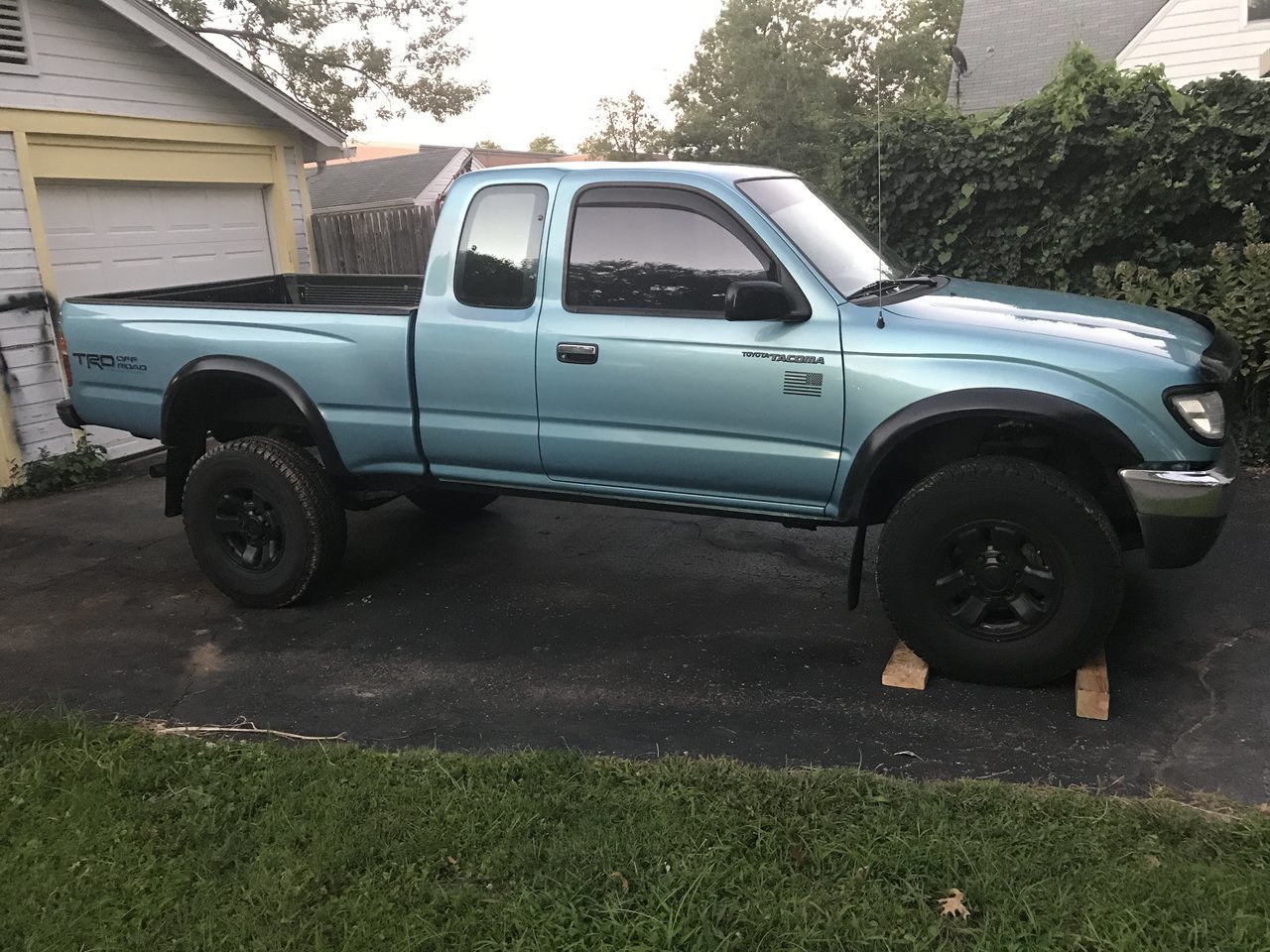

  18. Aug 3, 2017 at 3:37 AM
    #18
    halo07
    Nov 17, 2016
    #202601
    226
    Aaron

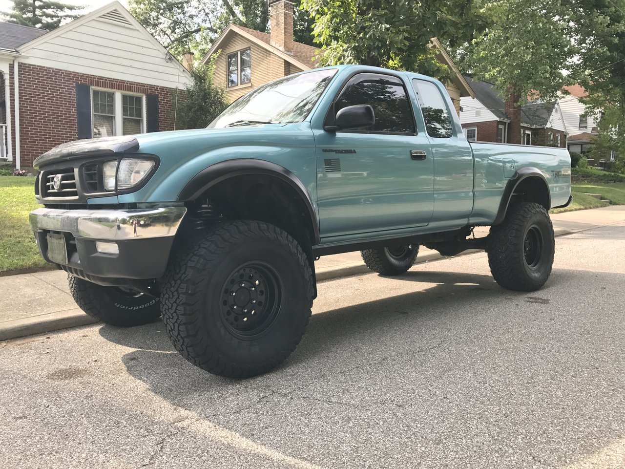

    Lift was finished last night after 5 days of fighting with 22 year old frozen bolts. Everything in the front and rear end is new now! The shop is installing my 33x12.5n BFG K02's on Saturday.

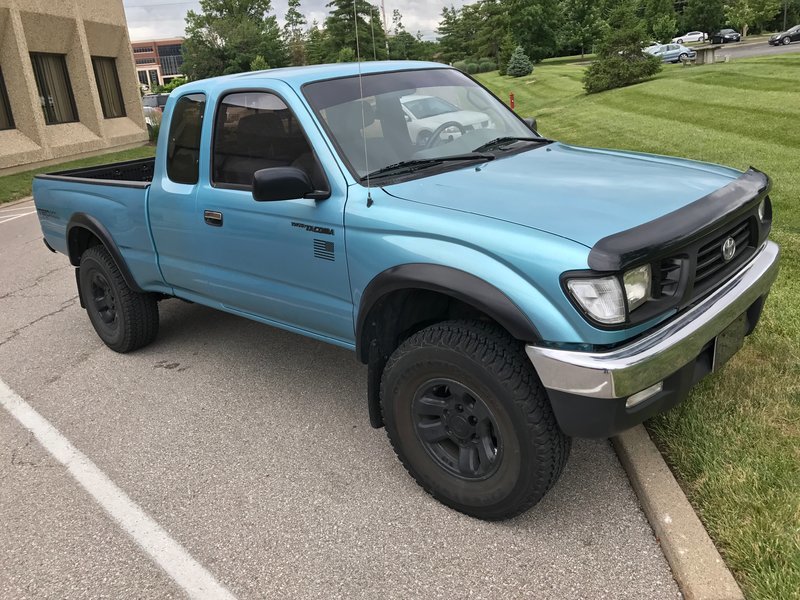

  20. Aug 5, 2017 at 3:25 PM
    #20
    halo07
    Nov 17, 2016
    #202601
    226
    Aaron

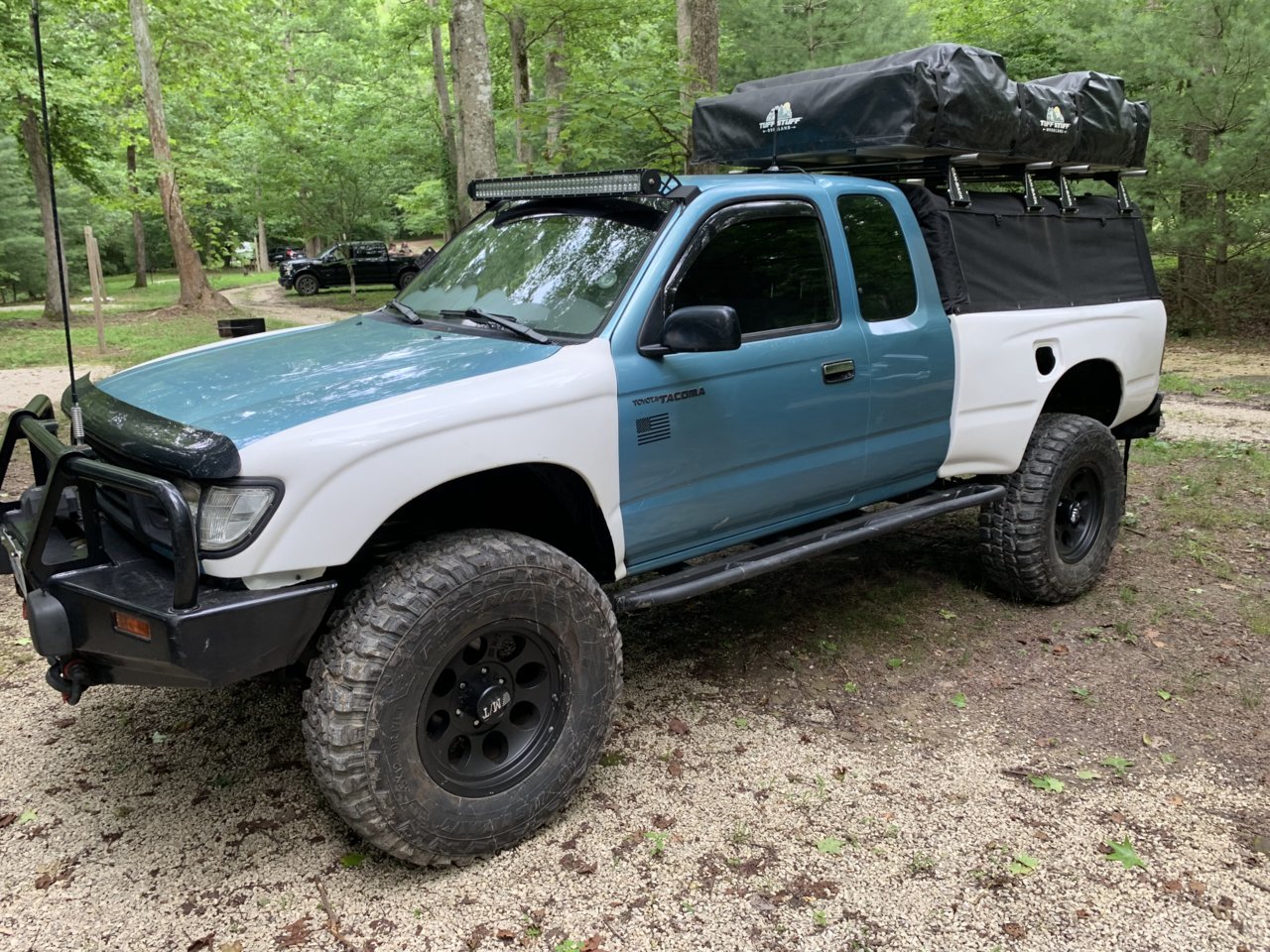

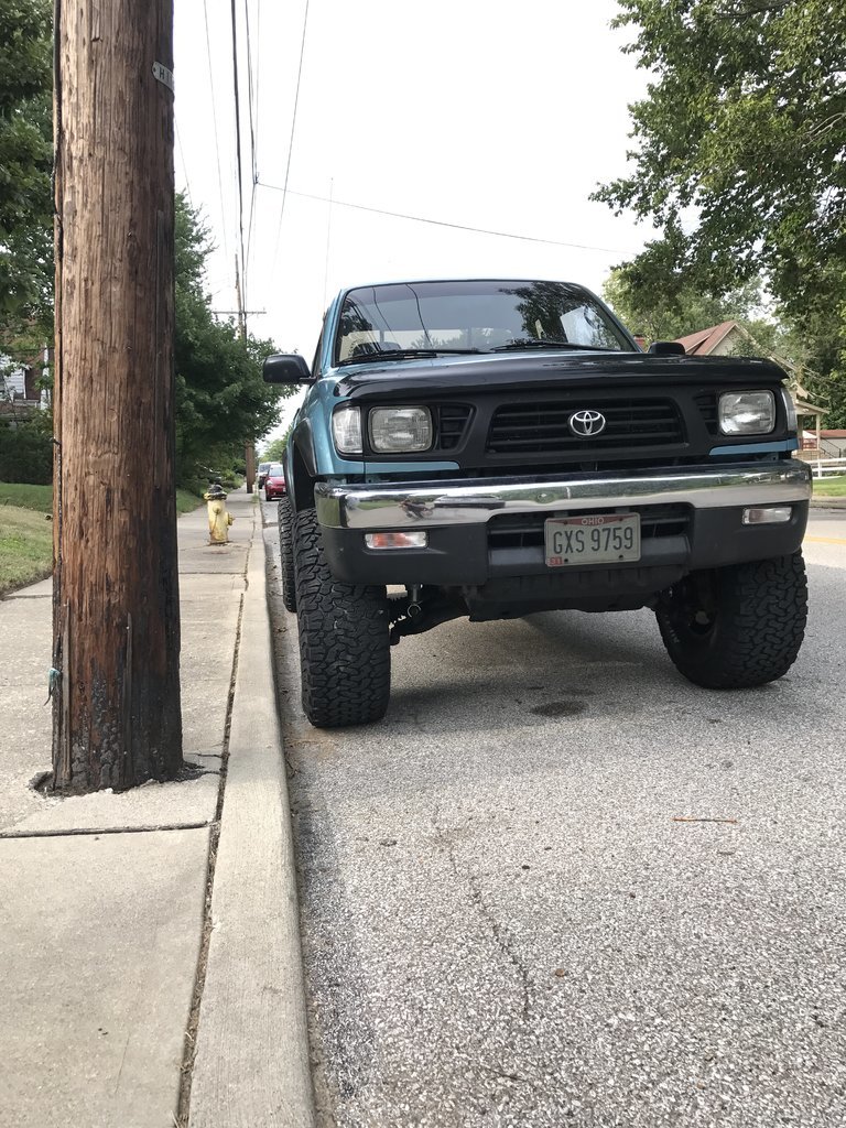

    33x12.5 Bfg k02s installed. Very happy with the final look. Now I need wider mud flaps. Need to put my passenger axle dust cover on along with make a bracket to raise the front bumper an inch.
    Next project is getting the bed line X'd then soft topper and window tint.
