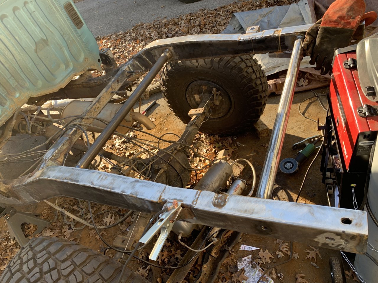

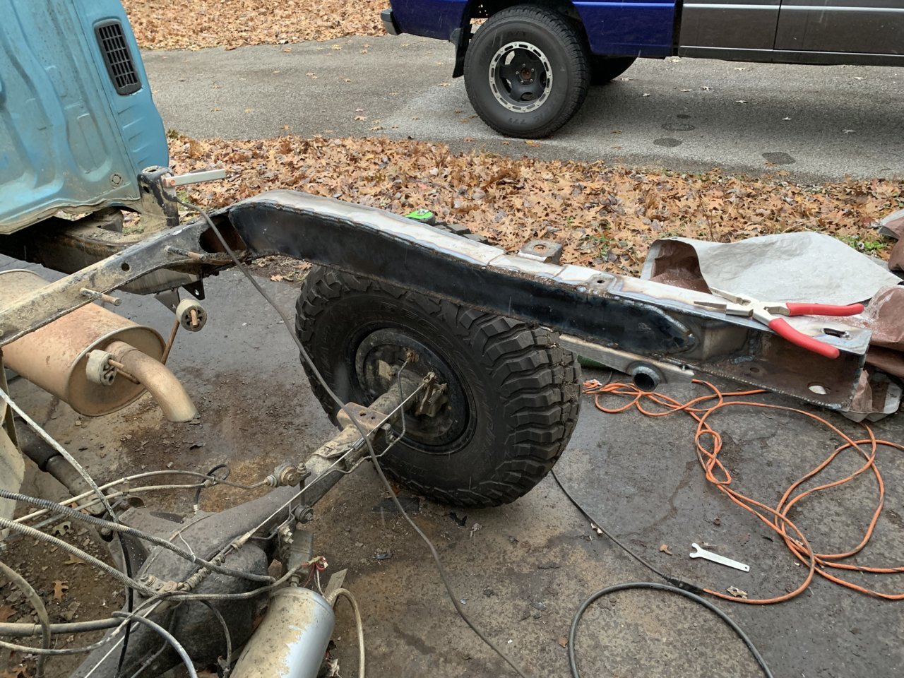

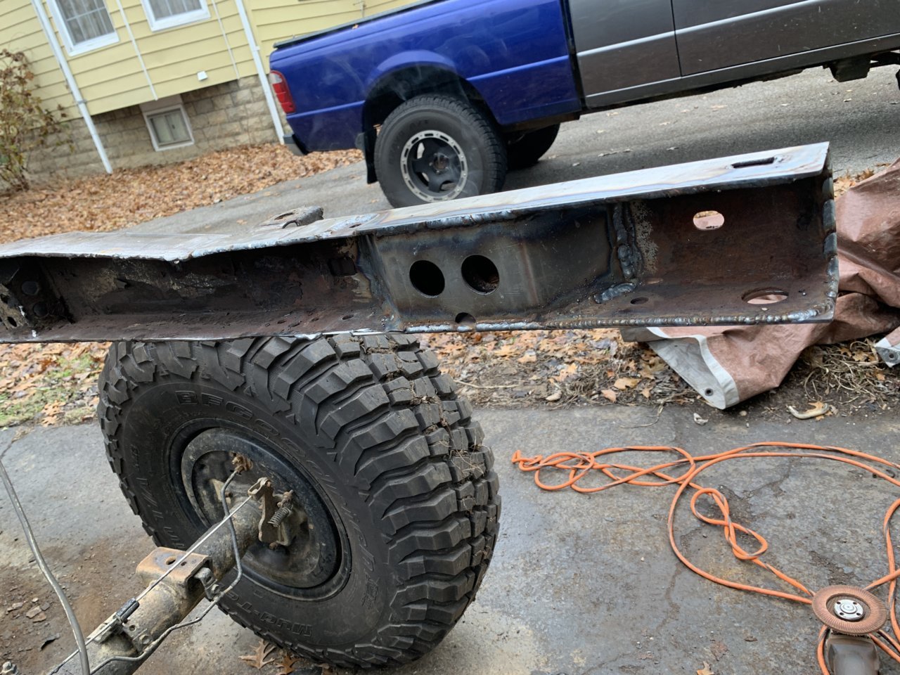

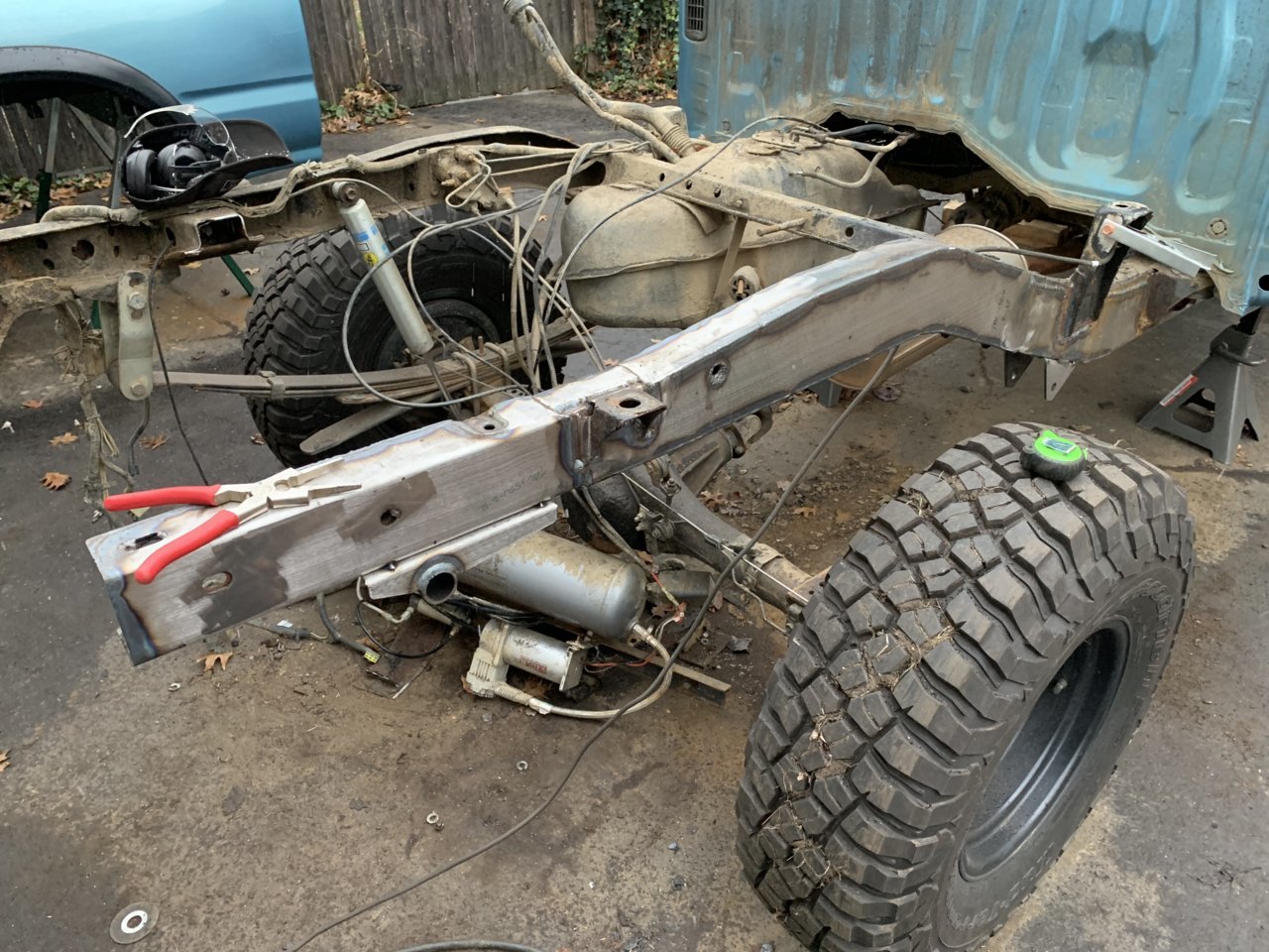

    Making some decent progress. I have one frame rail completely done and boxed. About to drop the gas tank and finish up the driver side. Once it’s done and painted, should look like a new frame.
    I noticed when doing all this frame work that somehow I had a blown inner boot on one of my basically new CVJ shafts. So I get to do that now too. I swear this truck spends half its life torn apart.

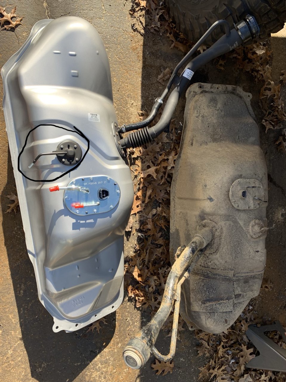

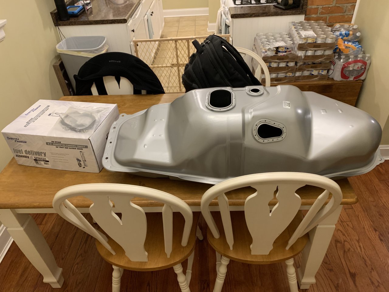

    I also bought a new gas tank, fuel sender, pump, and filler neck assembly. This thing is going to look brand new.

    Man this beauty is coming along so nicely! Lol I hear you about it being torn apart half the time. Its been three months since she's driven due to the frame swap. It all started with just looking into one thing and seeing oh well it's coming off so I can replace that anyway. Basically leads to a whole new truck!
    Where'd you get your sending unit? Dealers want two arms and half a leg for that and the fuel pump. It's looking like I might just have to replace my high pressure fuel line and the ports on the tank are super rusty so...

    Thanks man, Yeah that’s what happened to me too, one thing just leads to another and I keep finding things I want to replace. I purchased the tank, sending unit w/pump, and filler neck off Amazon. They are all spectra brand. The only thing I had to go to the dealer for is the vaccume valve pieces circled below. Total cost of tank was around $780 to $800.

    is your spectra fuel pump louder than the original one?
    my fuel pump went bad 2 months ago and replaced it with a spectra and it’s got a super loud humming/whining sound you can hear at idle

    Nope, mine is actually super quite. Although I have noticed that it has to crank a lot more to start since getting the new pump.

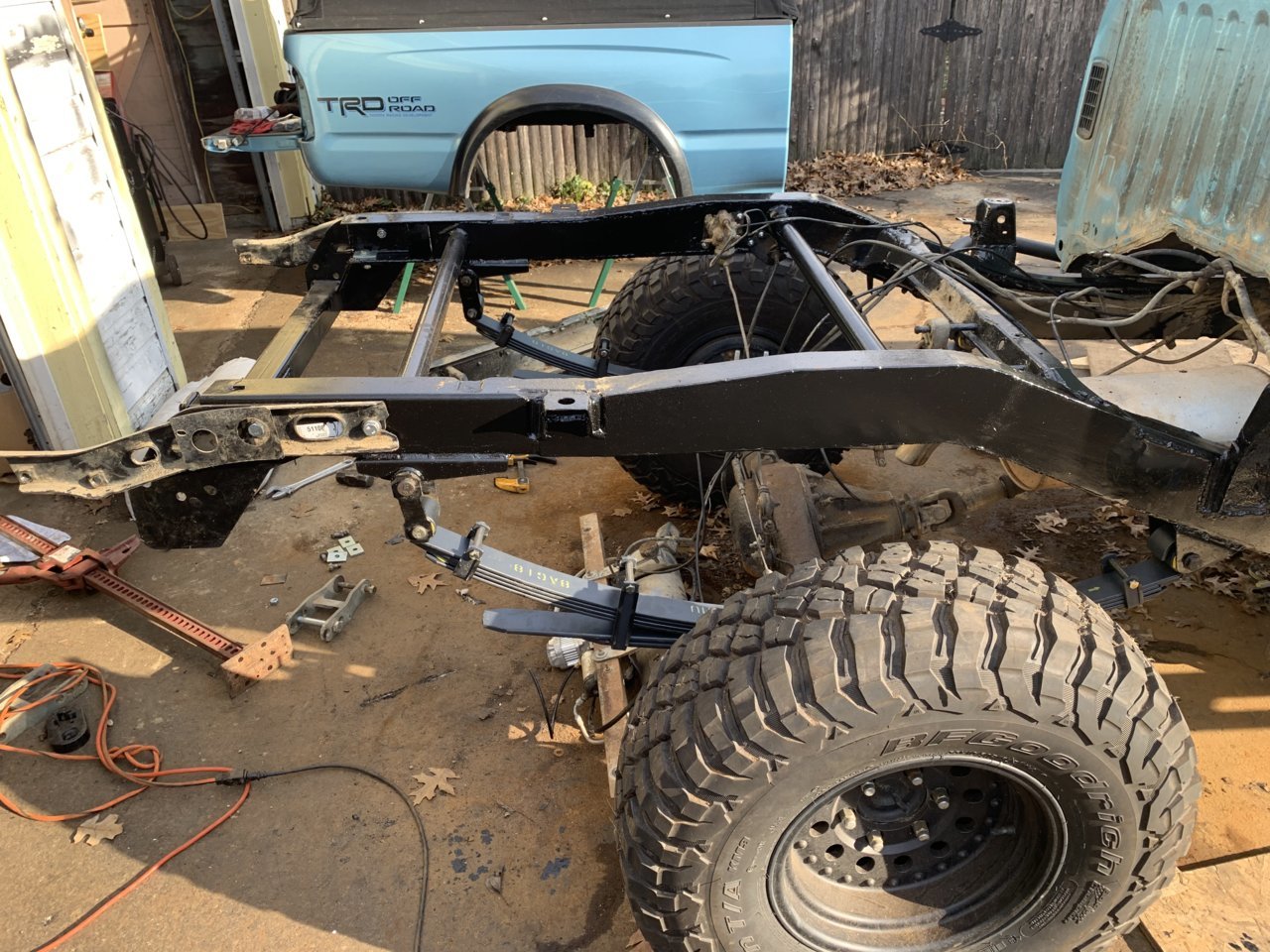

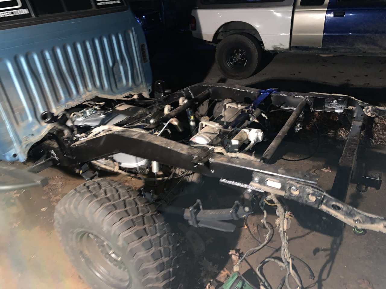

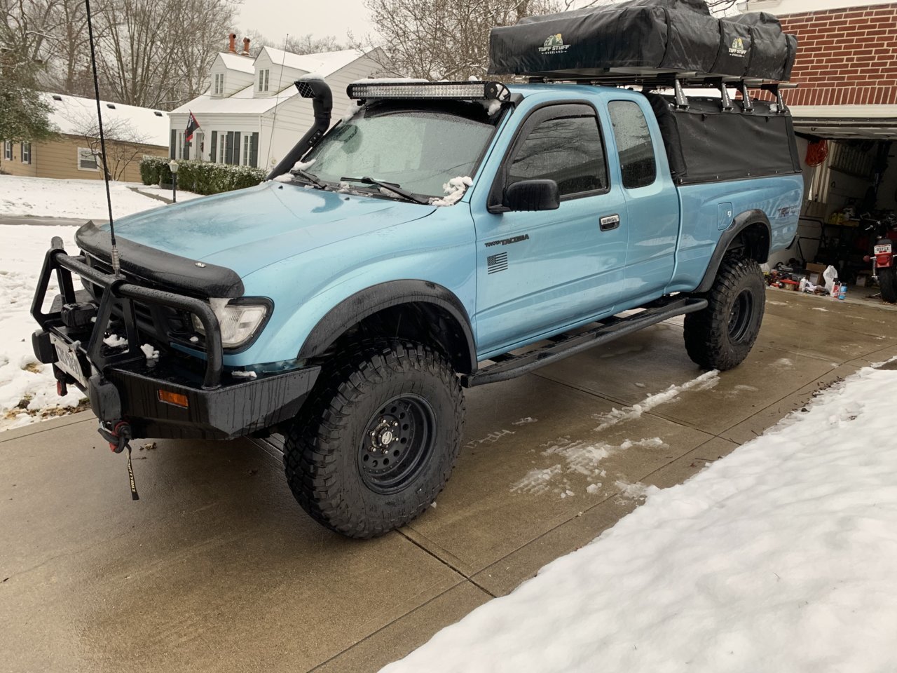

    This last week has been pretty crazy. I was able to finish my truck and get it back on the road. Frame was stripped down and I welded frame kits from auto rust technicians the whole length of the frame. It’s coated in por15 with rubber undercoat over that.
    I also:
    -reinforced some other frame areas
    -welded in a frame box kit
    -Frame is coated inside and out to prevent future rust issues.
    -New leaf spring perches
    -relocated rear shocks
    -installed U-bolt flip kit
    -installed new OME bushings
    -installed Darkar CS019R
    -New rear hitch
    -antenna moved up front
    -new tank, fuel pump, sending unit
    -air system relocated and welded to frame
    -new carrier bearing
    -new fuel filter
    -fixed ripped inner CV boot
    -bought a full size spare tire
    -replaced all drive belts
    -added 2 additional cross bars to the Can-Back.
    As you can see below, the rear springs still need to settle a little.
