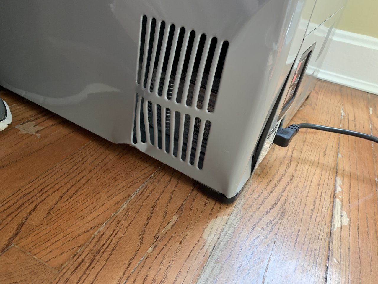

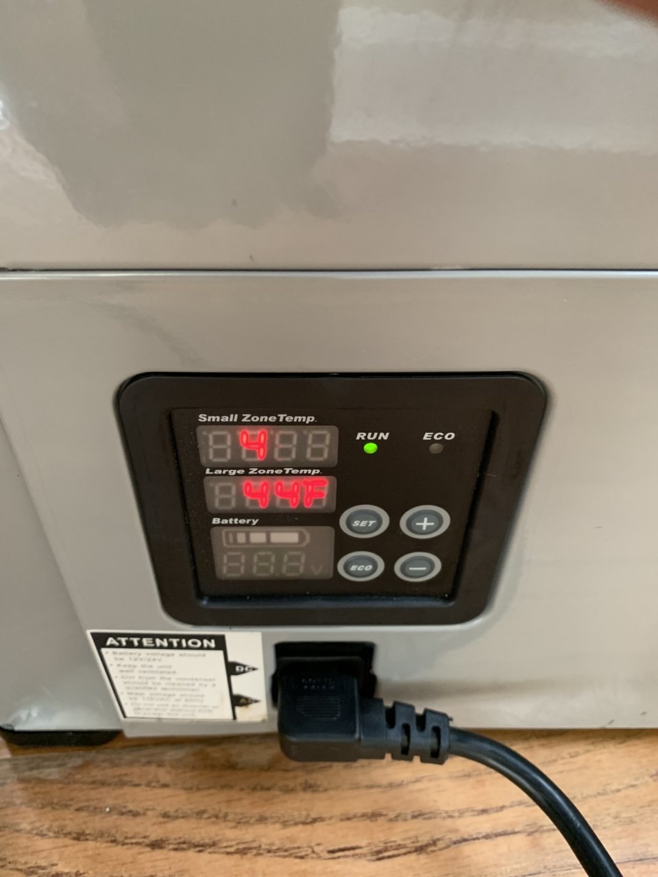

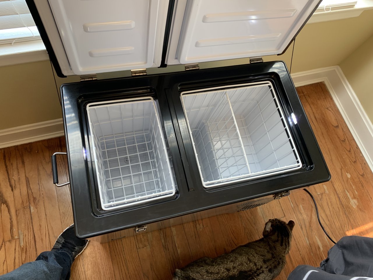

    Finally picked up my new fridge. Looks like someone dropped it in the box causing that dent. Spent $500 on a 90q dual zone so I’m happy with my purchase.
    Now time to start building a slide system for it in the bed. Also looking into some dual battery systems.

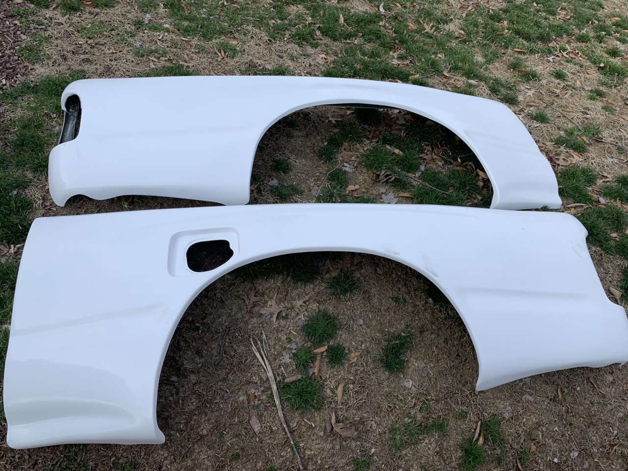

    Update: The bedsides and fenders should be here by next week. During the install process I will be tubing the fender well.

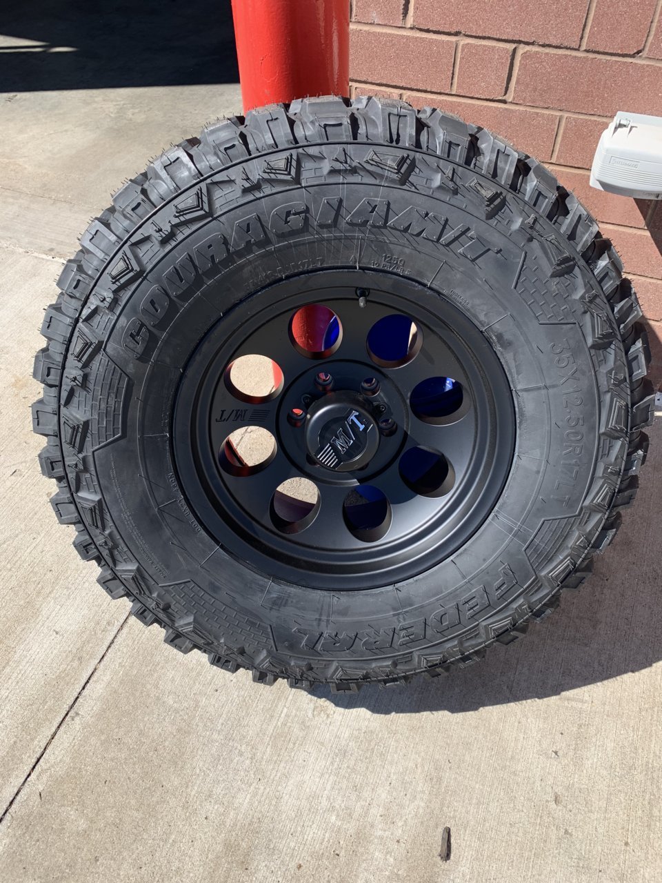

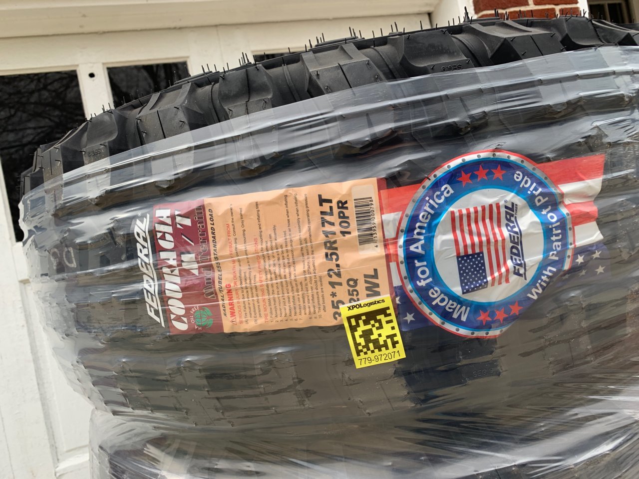

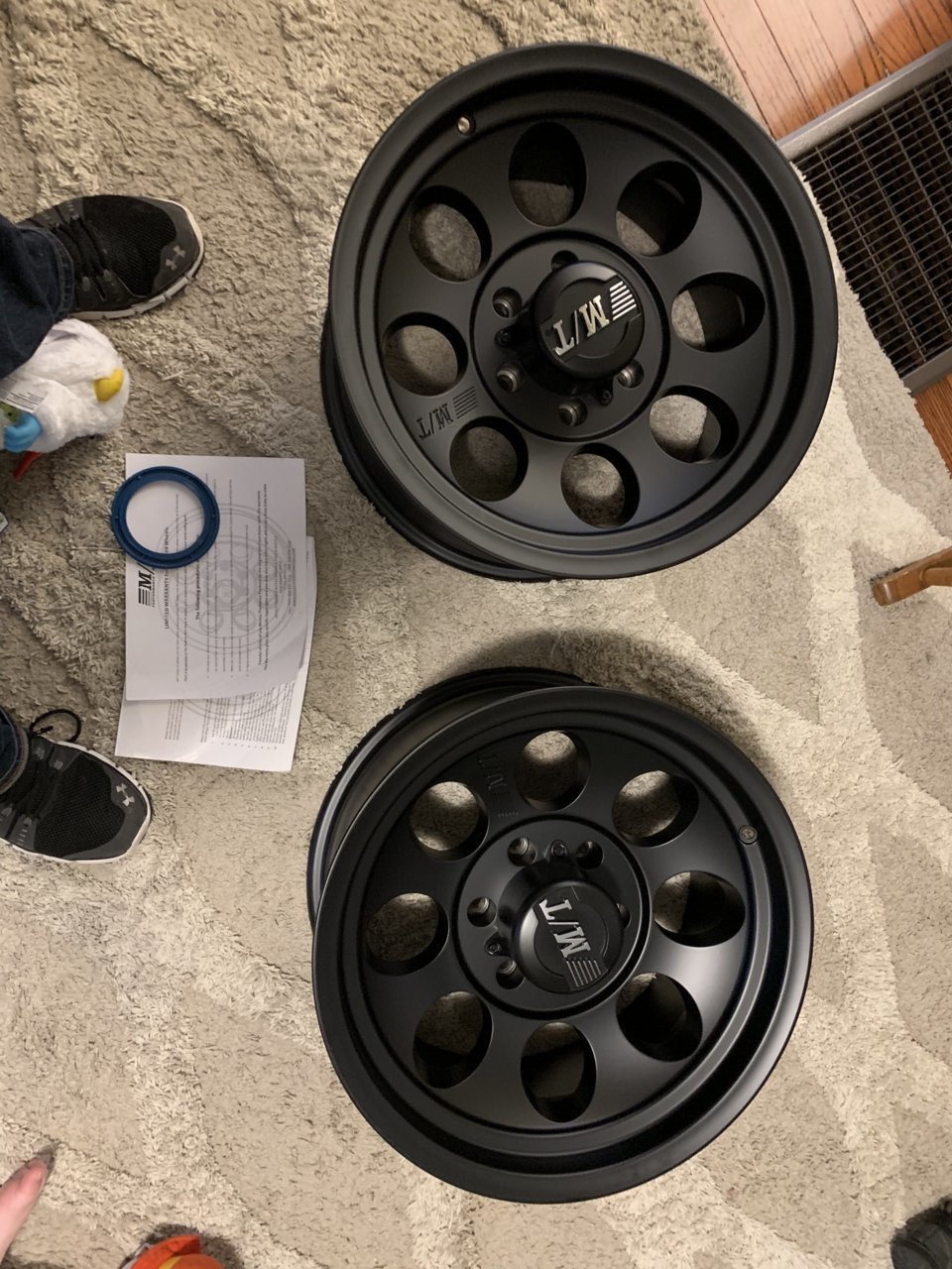

    All of this is leading up to a new set of 4.88 gears front and rear, 5 Micky Thompson classic 3 matte black 17x9 rims with 35x12.5 mud tires. I will be running 2" hub centric spacers so the tires line up with the fenders.

    5 new wheels and tires. Getting excited. Hope gears show up in the next week.

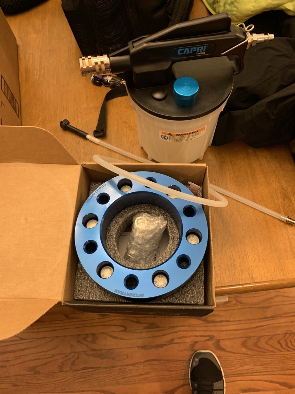

    There is something I didn't really think about, the front manual hubs. So to solve that issue, I'm going to get SpiderTrax 1.5" spacers for the front since I have read a lot of people have used them with manual hubs. Hopefully I can start working on everything by next weekend.

    I looked into spacers as well when I had a truck with manual hubs. The lip that's at the center of them making them hubcentric hits on the hub mounting bolts. Some guys either use the lug centric ones without the lip, the 1.25" hubcentric and grind out small notches in them to clear the bolts, or like you said use thicker spacers to clear the bolts.

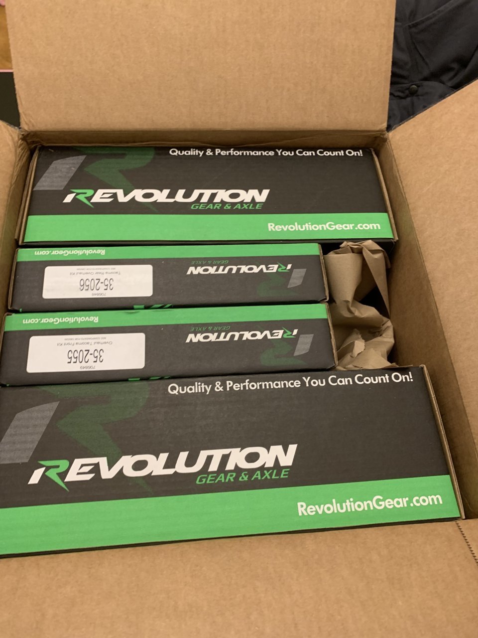

    These things are gonna look sick. Also got in my spidertrax spacers and a nice brake bleeder so now it’s a 1 person job.

    Nice! I was looking into those revolution gears. I read some pretty good reviews on them.

    I originally wanted to go with Yucon gears but they had the set of both front and rear revolution gears on Amazon and they seemed to be pretty good. The real fun will be installing them lol. Will be a first of me.

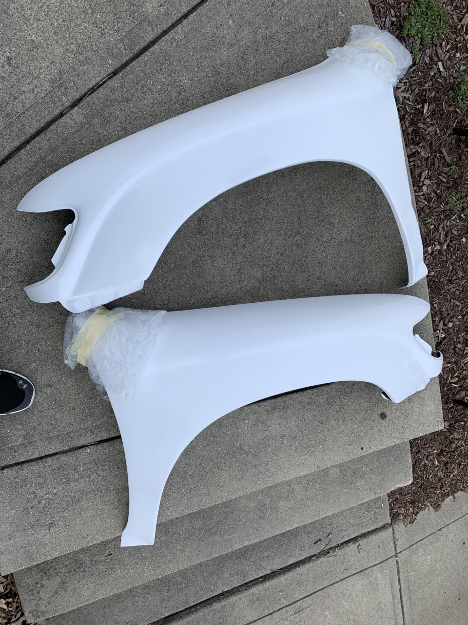

    Also got my fenders and bedsides in today. The fun will begin soon.
