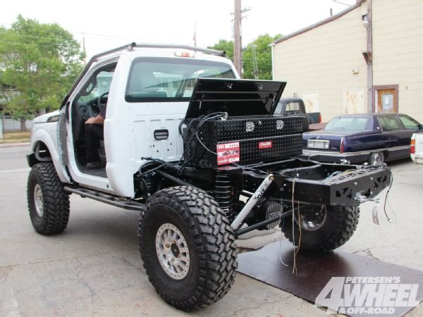

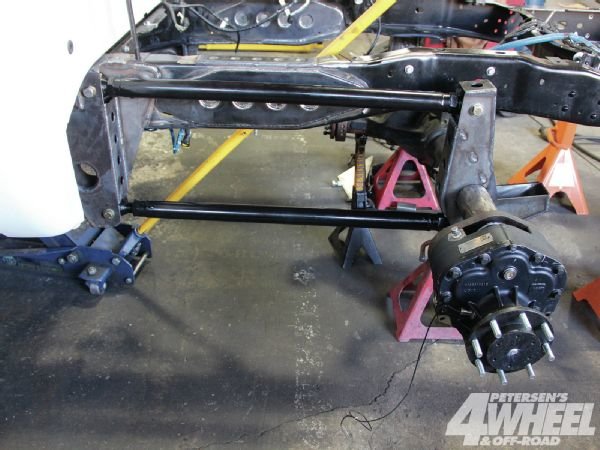

    I will be getting a second, or third generation Tacoma in the coming year. I am planning to run a Parallel Rear 4 link set up. Attached below, are pictures from Shaffers off road of the identical rear setup that I am talking about
    For the front suspension, I am just going to put in a Long Travel IFS kit to compensate for the lift I will be getting in the back and run 33-35 inch General Grabber tires. In addition to all that plus front and rear ARB Air Lockers, I also plan to have a flatbed and shorten the frame around 20 inches behind the rear axles once it is all linked up to work better off road. The only problem with coilovers is that I am not able to create a true flatbed. Thus if I go for a 4 link parallel coil spring rear suspension w/ shocks, then I can keep all of my suspension parts at or below the frame. In other words, the suspension will not go through the bed area.
    What I plan to get out of this build is that I am looking at an all purpose rig that can be a daily driver, haul items in the bed (thus looking at coil spring w/ shock set up to retain all of the bed space), expedition, and rock crawling as well. This will not be used for high speed, pre-runner type off roading.
