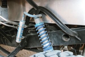

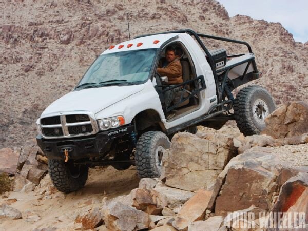

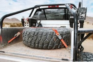

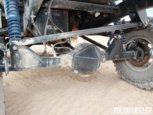

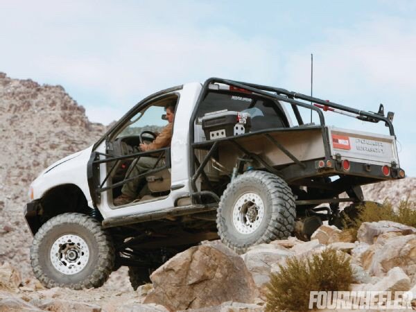

    I know this is not a Tacoma, but I saw this Ram Power Wagon with what looks like a build with a rear parallel 4 link with coil overs that has a 14 bolt rear axle. In addition, the owner cut 16 inches from the frame behind the rear axle and has a custom flatbed to fit the coil overs. Will this set up be possible on a Tacoma Access Cab with an IFS? If so, what will be the logistical variables that I have to deal with?

    I am talking about the 14 bolt rear axle, not the AAM's. Also, I am looking for a rear axle wherein, it is wide enough to mount coil overs and links so that I do not have to put the coiler mounts inside the frame. In other words, I am shooting for a coil over mount set up that is similar to the one in the picture so that I can achieve the flatbed design in the Ram in my Tacoma.

    I am looking at shortening the frame by 16-20 inches. Thus, I am looking at the parallel 4 link so that I can cut the frame that long so that it will be better off roading when it comes to rock crawling. With leafs, I am more limited to how much I can cut from the rear end, behind the axle.
    Thus, I am planning to implement the same design of the Power Wagon fab work on my Tacoma, minus the SAS swap.

    You make a great point with a custom axle. However, I am looking for a rear axle that is wide enough so that I can replicate the coil over mounting setup of the 2005 power wagon that I have featured to be able to replicate the custom flatbed it has. Some have told me that Dana 60's are good for this type of set up in the rear. When I meant to say a rock crawling rig, I also forgot to mention that it would be an all purpose rig as well wherein, I am able to use it as an expo rig, and a daily driver to work.

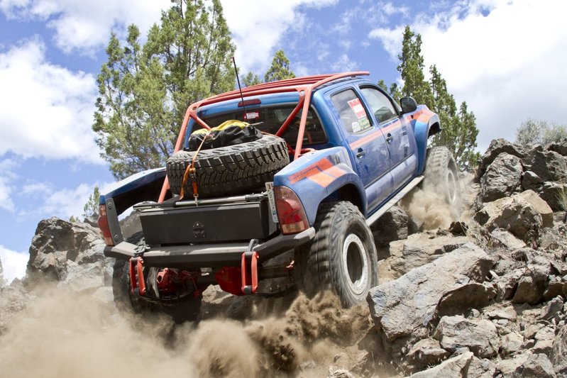

    Damn that's a cool rig. I guess if you're moving forward you don't have to worry about hitting your rear shackles...
