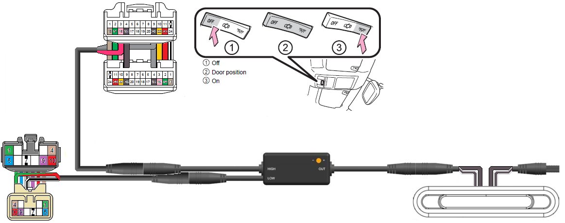

Parallel LEDs to overhead switch (cab Illumination)
Discussion in '3rd Gen. Tacomas (2016-2023)' started by caribe makaira, Feb 8, 2022.
  1. Feb 8, 2022 at 1:54 AM
    caribe makaira
    caribe makaira [OP] Well-Known Member
    Feb 13, 2011
    #51121
    11,786
    Caribbean, Puerto Rico
    05 PreRunner TRD Offroad AutoTrans
    Hood Struts, My version Fogs always ON, Map & Overhead Light Mod,
    Fused power from DOME relay circuit. (if left ON when vehicle OFF, system turns relay OFF after 20 min.)
    Dimming ON/OFF negative.

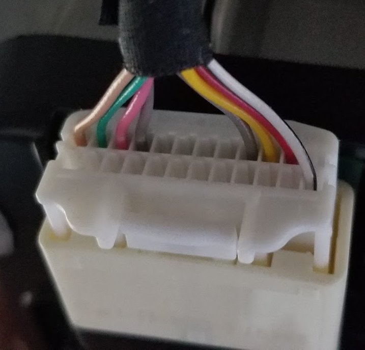

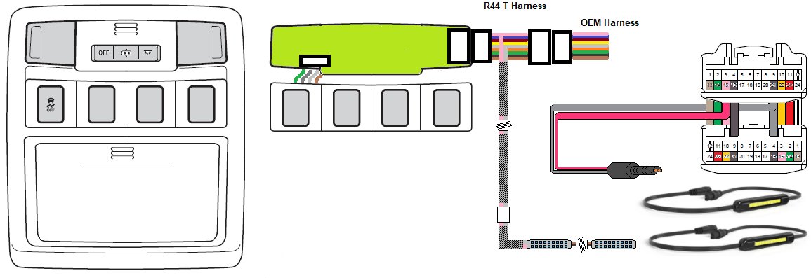

    Connector is intercept to R44 Overhead console, upstream of IN1.

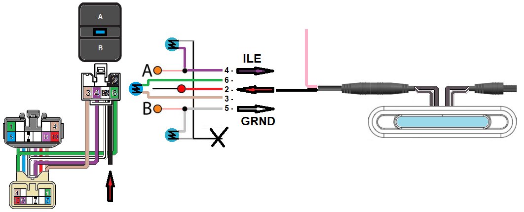

    Variation of install so it fits 3rd Gens without interrupting any added system. Any other strip LED will work also.
    Another iteration:

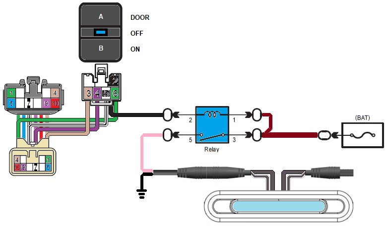

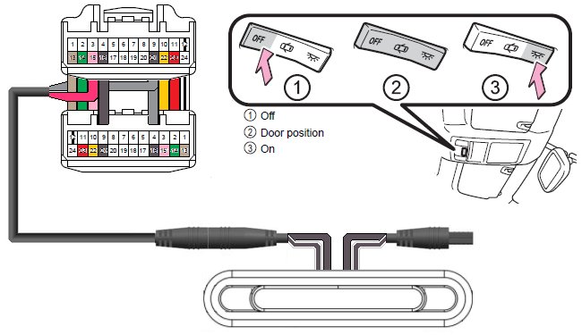

    Another iteration:
    @TRDProDriver
    Pink may be tied to DOME circuit (+ HOT Battery) or an add a fuse (Battery NOT IGN source)
    ON at Unlock/Door Open. No dim ON or OFF.
