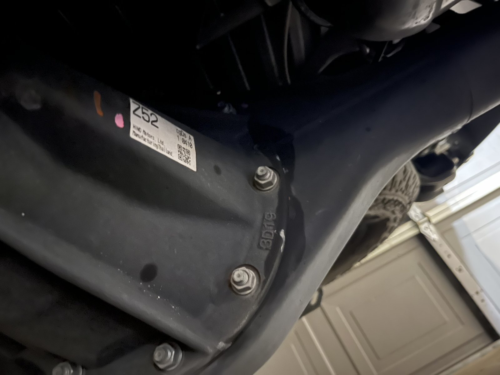

    I was just under there checking the axel nuts for the new recall and noticed what looks like some kind of seepage. The truck is 6 months old with 10k miles stock. Idk if it’s just it breaking in or do I need to have a dealer look at it.

    Common seeping. Wouldn't worry about it. Free corrosion protection. If it gets wet or forms a drip, dealer will repair.

    Bring it up with your dealship and watch and monitor. More than likely just a seep. You could always put a piece of cardboard under it where you park to see if it gets worse.

    I think that’s what I’ll do. Watch for obvious leaks and then bring it up at my next service

    Check above it to see if anything is leaking on it . check the filler plug that it’s not loose .

    how can you be paranoid if you can clearly see seeping , it could of been when they first filled it

    Just point it out when you go in for your recall.
    Nothing to panic over.

    if they try and fix it, it will be worse.....just drive

    Monitor it.
    I seems to be a seep, a poor seal job when they assembled the rear axle. It’s not from the initial fill.
    Personally, I would spray it with brake clean, remove all that seep residue, and keep an eye on it.
