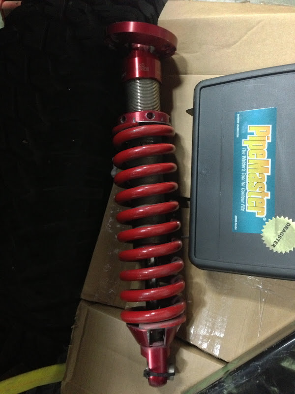

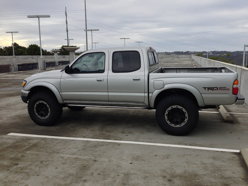

    so finally installed the coilovers and upper arms. drove around for a wile but was tired of the bro look. picked up some used shackles on here and put them on. stance is much much better.
    next up is some rock sliders. was going to build them but the thought of dragging out the bender and tub would suck (fj40 project is in the way) so ended up buying some :D
    also have some 33" tires on order too. woot.

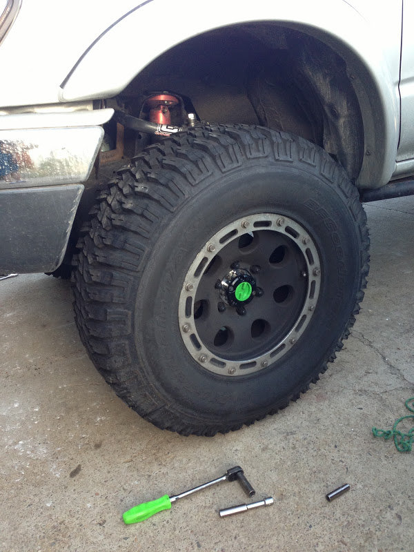

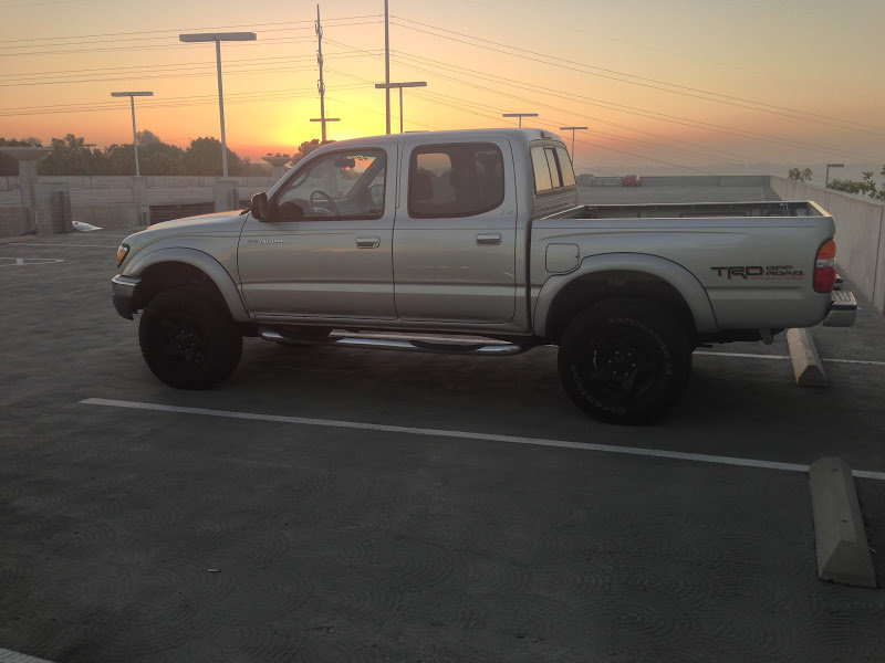

    and wheels/tires and sliders installed.

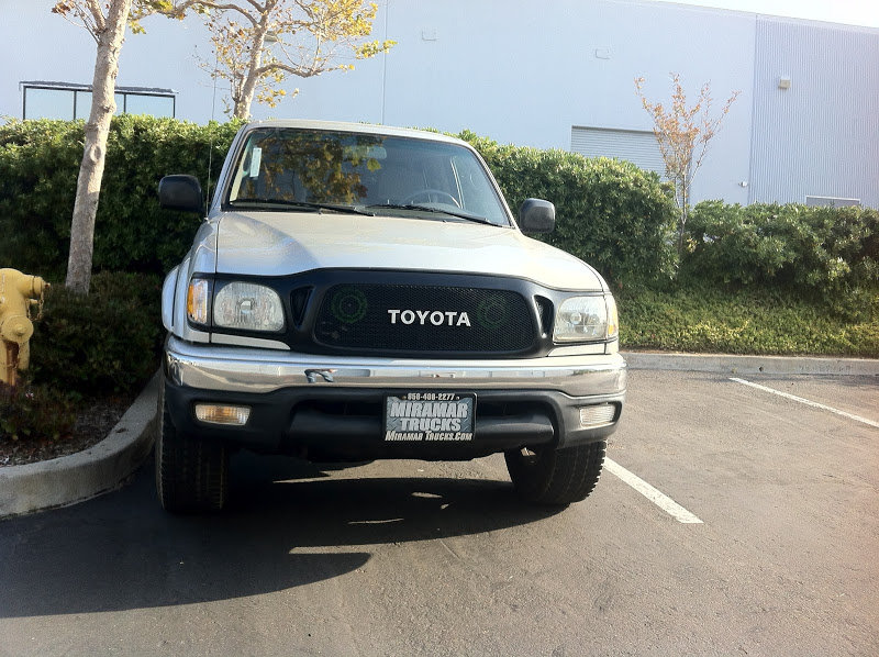

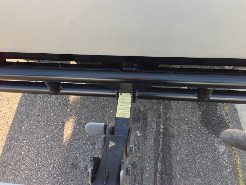

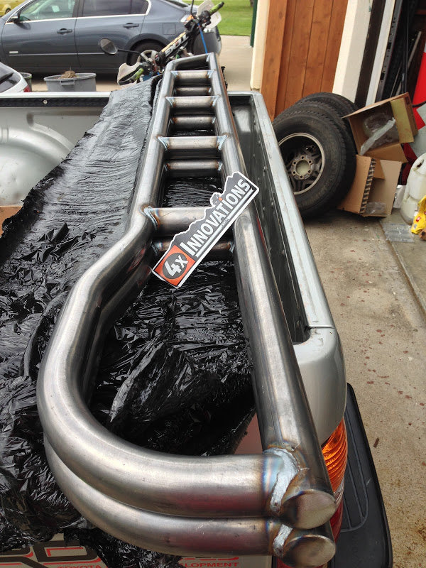

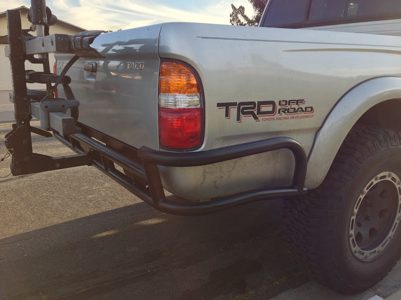

    got a great deal on a trailgear bumper so decided to pick that up and not build my own (dont have much time on my hands anyways lol)
    i also beefed up the hitch part with some square tubing and extra braces. i almost bought the 4xinnovations one, but just didnt like the bed side protection (how it looked)

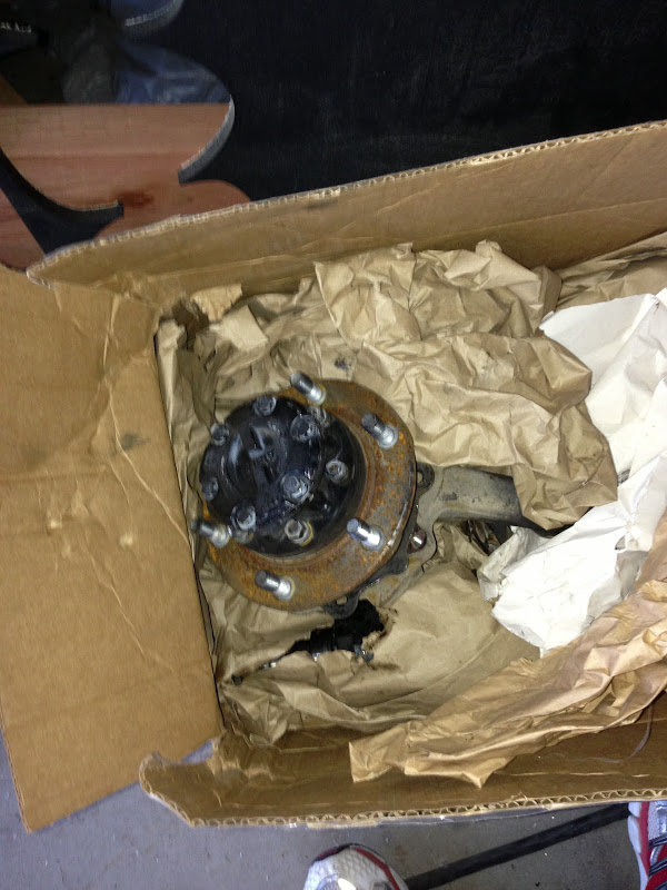

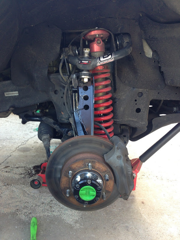

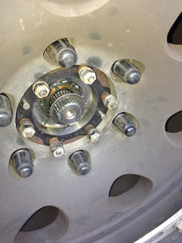

    well finally got the locking hub setup installed.
    guess i didnt research enough i guess and didnt know about the abs issue lol.
    i just swapped full knuckles so i lost the abs port. i will probably fix that soon, currently i just put a cap over the sensor and zip tied it to the spindle and took out the abs fuses.
    also, got it all bolted up and finished spun the wheel and come to find out one of the damn boots has a hole in it and was oozing grease lol. doh.
    also welded up a TC spindle brace.
    and installed :D
    also cant seem to find an answer for this, but how does the axle stay in place? snap ring? bolt at the end of the axle?

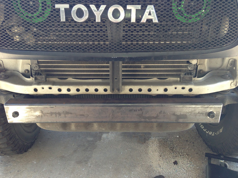

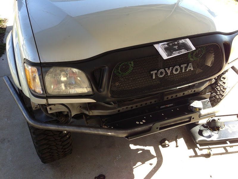

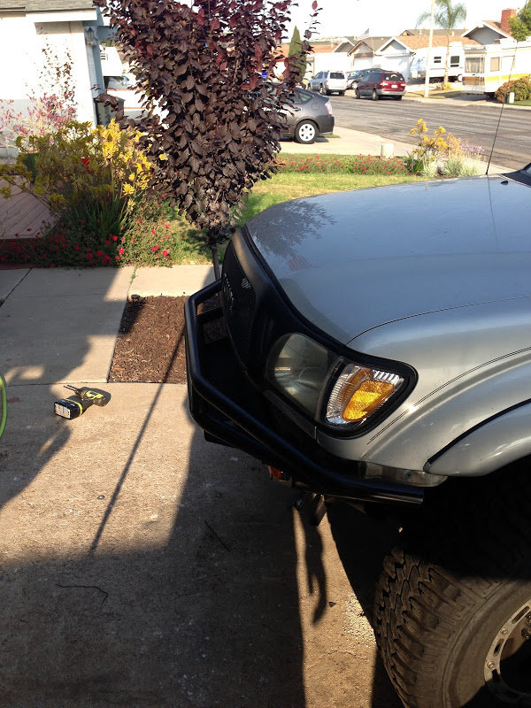

    now for the front bumper. made a simple bracket that bolts up using the front bolts and the under bolts. so 6 M12 bolts holding this on. i will also tie into the other side bolts with some tubing.
    and got the main tube bent up.
    going to make something similar as the trail gear. need to cut down the sides and weld on caps still.
    (and ran out of damn welding wire lol )

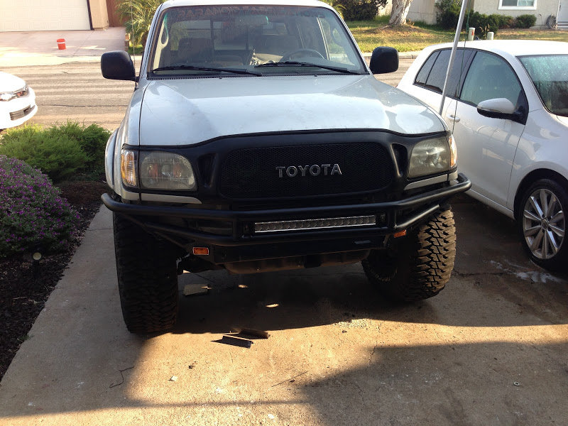

    I see a printout of my truck. :)
  17. Jun 23, 2013 at 8:33 AM
    #57
    paranoid56
    paranoid56 [OP] Well-Known Member
    Jul 25, 2012
    #83443
    3,443
    San Diego
    14 double cab taco
    Lol yep. Good front shot of the bumper :)

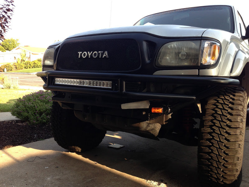

  18. Jun 30, 2013 at 6:55 PM
    #58
    paranoid56
    Jul 25, 2012
    #83443
    3,443
    San Diego
    14 double cab taco

    Looks great. I like that it isn't a direct copy and you made it "your own".
  20. Jun 30, 2013 at 7:47 PM
    #60
    paranoid56
    Jul 25, 2012
    #83443
    3,443
    San Diego
    14 double cab taco
    Thanks, i am happy with the outcome, the turn signals were a little after though as i painted it then realized that i didnt have turn signals now lol. but some LED lights did the trick.
    now saying that, man, not sure i want it lol. i have always told my self since buying my first yota (84 xcab) i wanted a ARB bumper as i loved the look of those. so i might put this up for sale to put it towards an ARB.
