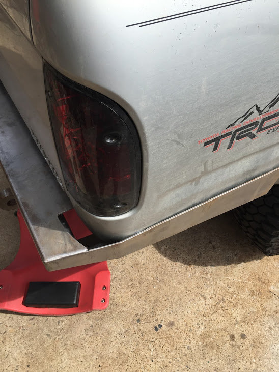

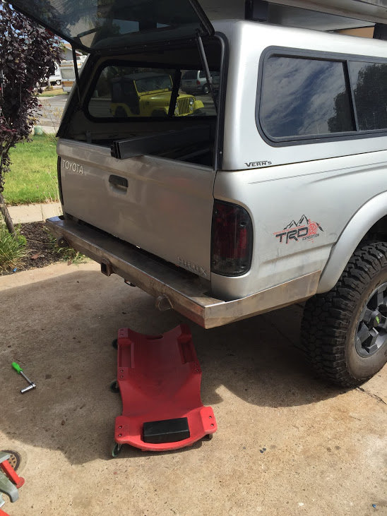

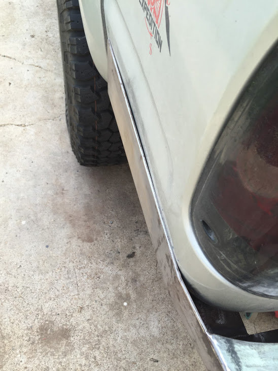

    bought a ill fitting bumper
    FN6mPl9n4gPdn50wy4KB2GPoL1KnMpmy8sfZFnu__ceafec1349de9ed4efdc561a2c860f035013d2b3.jpg
    9okMtmKmpVgDtrnwcX5fST8vJD_KYx672s2i5eHd_134063e0208a4caaf75f028ae8dd7acb25f34d8e.jpg
    hrEo_9UYDFxjjq1I9CeN61w50HvUXnymiWo9YtRj_21462bb18296b4bdb82e96493dff27e8e724a0d7.jpg
    2SbtAX1v-uPRFrSDlUOWOJCYiX4KOINa5MVPzkpG_693dacf4ab545047cb4f275662b39861553d9a8e.jpg

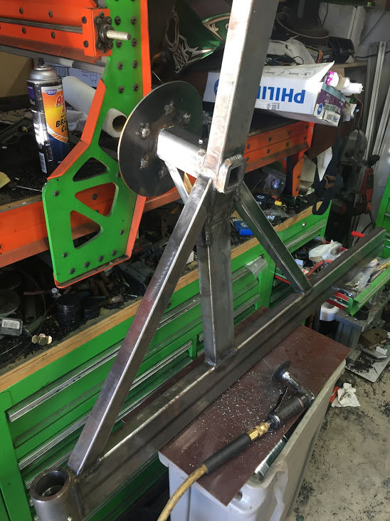

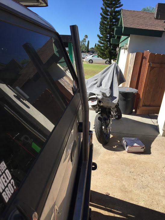

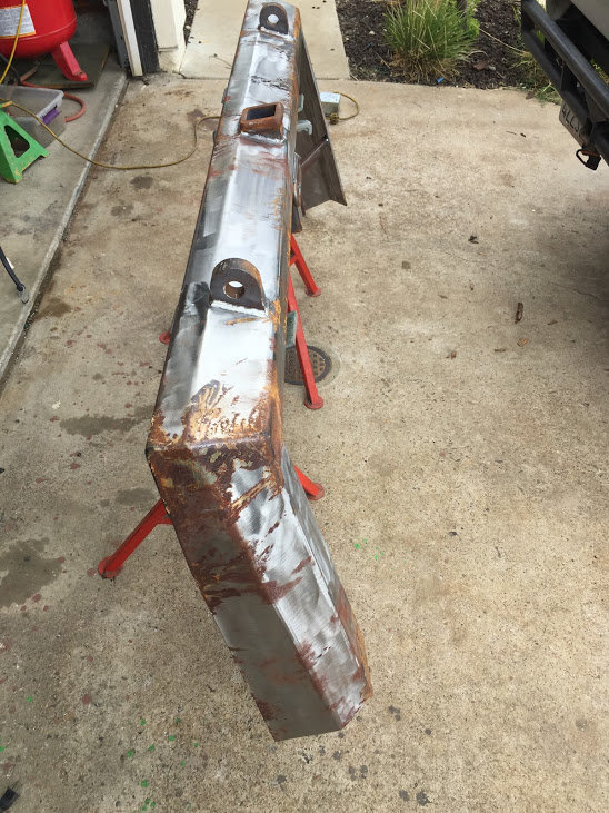

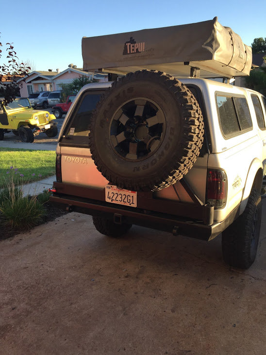

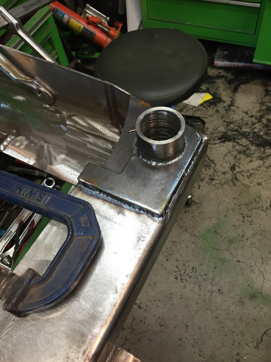

    decided to fix the bumper and add a tire swing out.

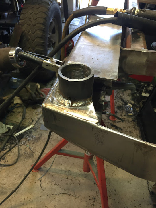

    welding up the sleeve for the spindle
    BgXQnAYGow3c90aPB9H72DNbIMyA_NSTKwtTI0LX_e7d671d09a646c027cd2b3e755a9cd346e5b26e0.jpg
    also added a plate to fill in the huge gap
    nFr3HKaqZgXIADUZPffWdleDyGOyx4KNA5n6r7gp_cefab0667e634630a127100635ab16f041a39bd8.jpg
    the main upright is slightly bent to help angle the tire.
    8bxg_0m1cwtsEIOD817wHJgDl2QLpJn0cM81P33Z_28a024513a07c68cd1a6ba3b01a1969bd9ebc875.jpg

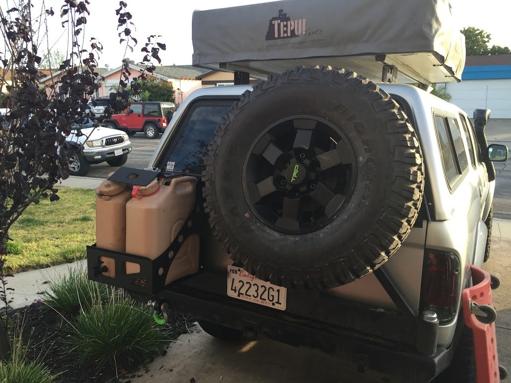

    almost done, got the tire part finished, and need to add in the fuel can holder.
    -NoacpXH4sgzw-LEvL3_S1oJiJtqGjz9FLt_tsyn_f30a3c2771098666781fca8398783b151ff98721.jpg
    QGw8_XdWuNOXNwJwLwHSQyaBDO4qF-eNJl7UhsdM_b2195fa77d17235daefaa7b366c90321f522f9bf.jpg

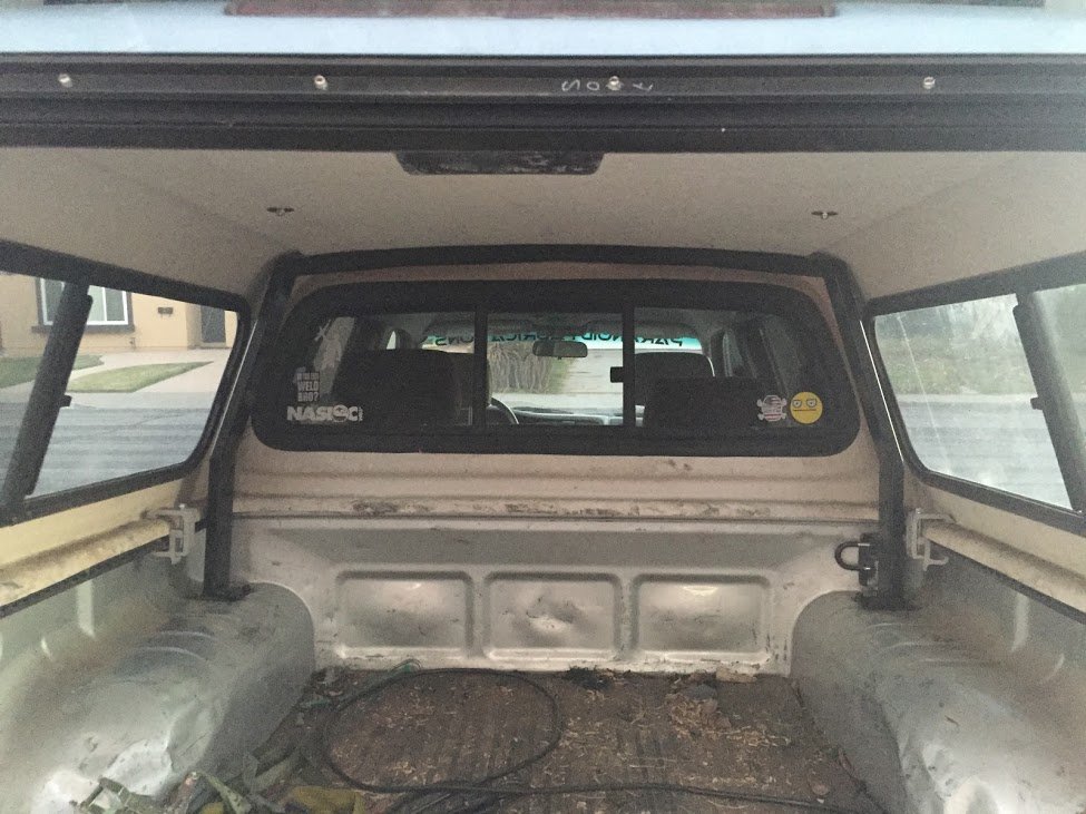

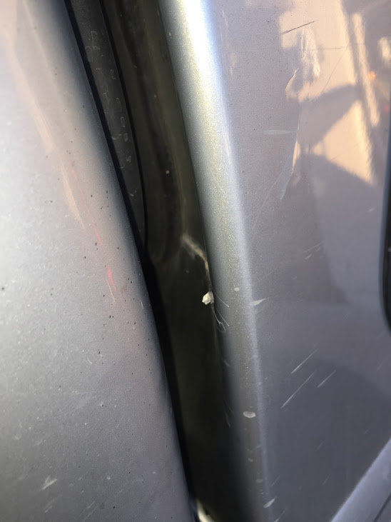

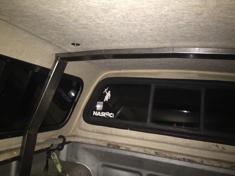

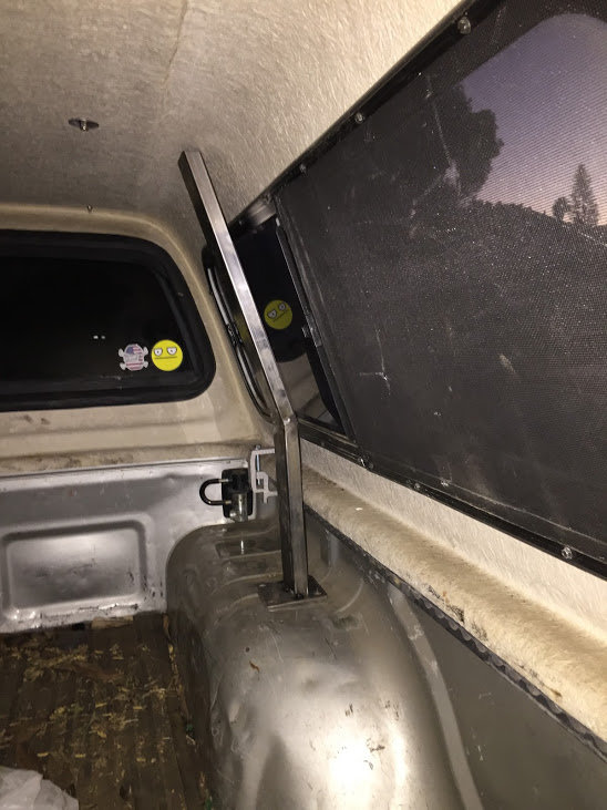

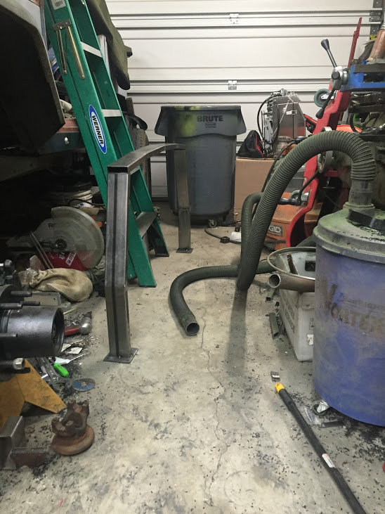

    also ran into a issue with the RTT on the cab, seems its a bit much weight for the shell. started cracking on both sides.
    HB5ZFKQ8W0sjFW6AvqIIxkLLaHDB0tAwngZ4zV3T_cc1d4c80911ee6e45f268fe4488e7157083f7ca9.jpg
    so decided to build a internal cage (didnt want an external one due to the noise of the side parts)
    c5RF8R2pTMXdXmfL9nJLmt72OB00uHWz1v_NPtkr_89ec060c2a51707da8971252951ff997960f8106.jpg
    put a slight bend in it to match the arc of the shell
    78JIeSvPXqG369dIJakyabxEnyFSV64ldiE4DNER_05e46cc7a56523b1931c269cd9760a46b6c6cc25.jpg
    and another test fit. super tight.
    78BijaWt8nicqF_nIVULNnM4jtGkCIlsSzLXB7EY_50abbb0fdb1cb3e47e92792a3d17f1a6b5fbd81c.jpg
    and finished. I also put in 4 flush mount LEDs into the cage to help light up the inside.
    ri4IIDZP6mbFtmJwoScTztaFjnmCnWo3yIRvh_eb_4d072b30a649879425297ece3e612633e2eadf17.jpg
    i have one more to make for the rear.

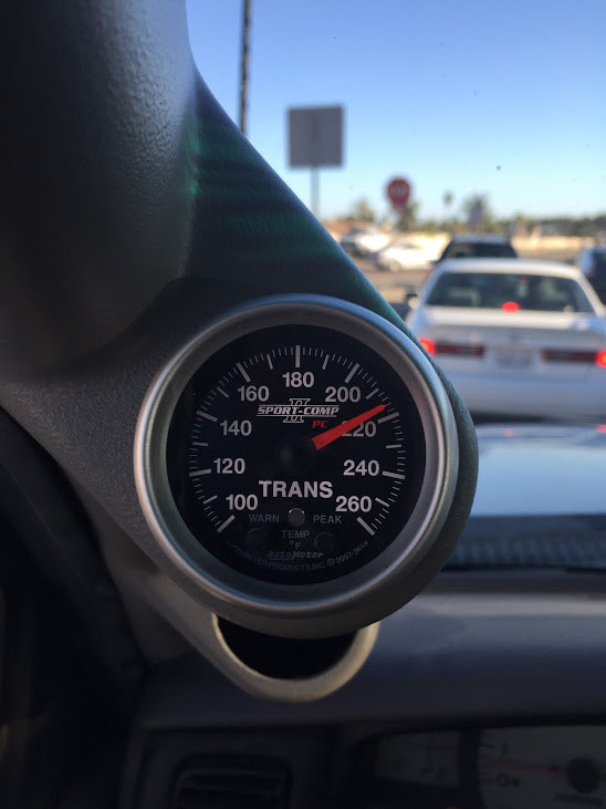

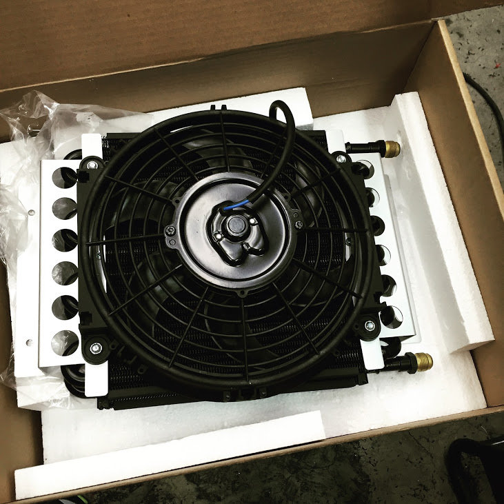

    over heated the tranny on one of my last trips so decided to get an idea on what temps my tranny is running. apparently 33s and stock gearing is heating up the tranny way to much. on my last trip out i got to 260deg. not good. so doing a band aid till i regear.
    yDDCwubwuyAPzfMNCdNE19txydMHWOfQo5XSU5u-_77de5c24d444f9607f64ee6bf4e7aeba293d3da4.jpg
    and this will go in shortly.

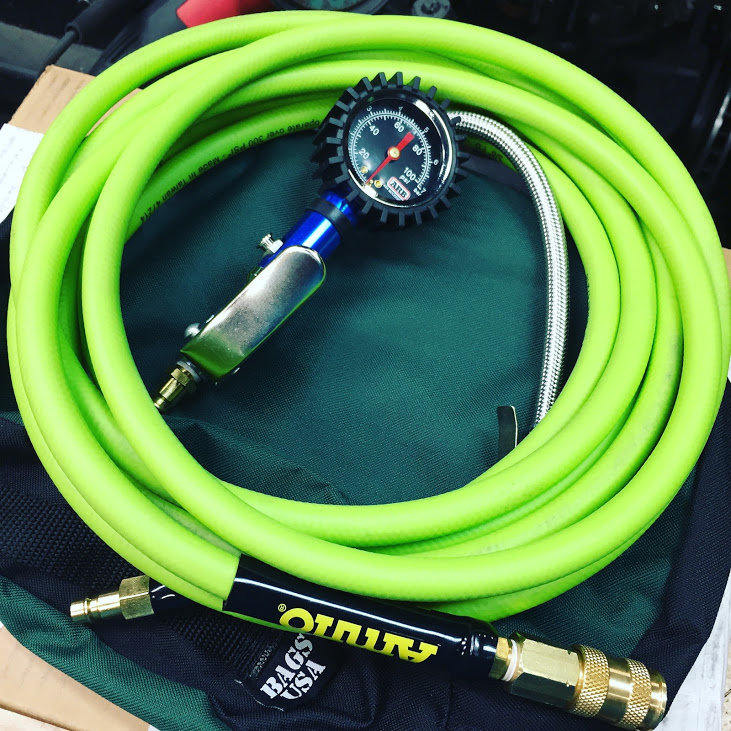

    on one of my camping trips my buddy lost the fitting to my on board air so i had to borrow something to air up my damn tires. so decided to make a quick package.
    arb air gauge, 12ft of lime green air hose, and a nice USA made bag to hold it all.

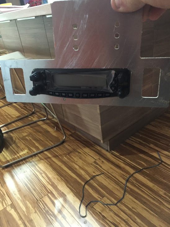

    started making a new plate to hold my Ham radio and two buttons for the seat heaters :D
    BTnsPpNSn5s-4ydKQ2drfrngMgo-Sy-S3vmBRvT5_0b5fec0a49822d1e5150433c98b8449929901546.jpg

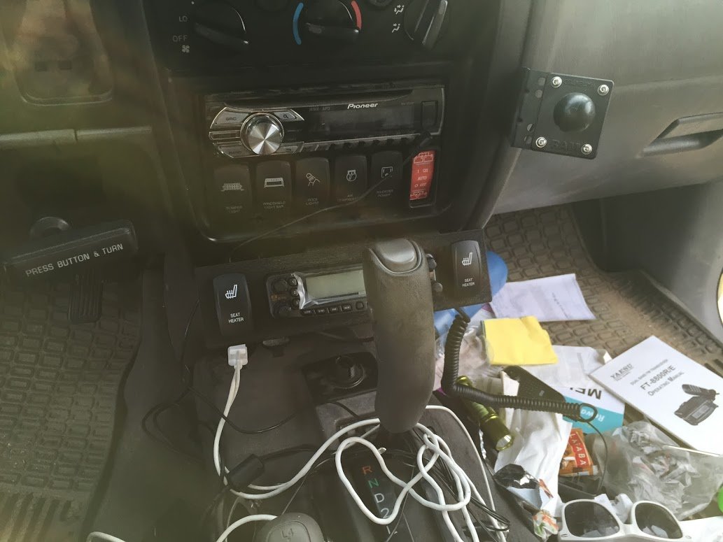

    also installed my yaesu FT-8800 R/E radio and seat heater switches.
    worst pic ever lol and yes all that trash was cleaned after lol

    What type of switch did you use for the seat heaters? I was looking at otrattw and idk if it's spdt or dpdt or what hahah

    yea its just a spdt, i wish they had a option for a hi/off/low but they didnt and trying to talk to them was like banging your head on the wall. super not helpful just want to push what they have. but i will say that they do nice work on the switches. I am still thinking of moving those and putting two different switches so i can use the round switches and put them in the center console.
