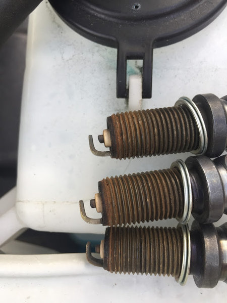

    I think the first thing was to give it a quick tune up, oil change, air filter and plugs
    yep, plugs were old as dirt lol

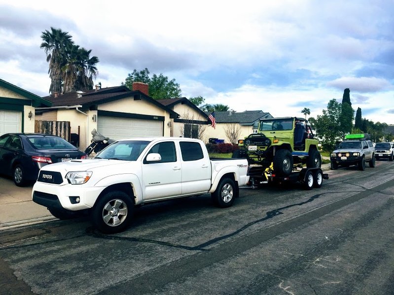

    next up was to install all the towing parts.
    I added the aux cooler, wiring for the brake controller, hitch and 7pin trailer connection.
    huge transmission cooler with aux fan. fan comes on at 190deg (never came on towing my fj40)
    towed this the next weekend and went great.

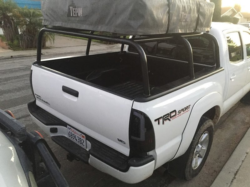

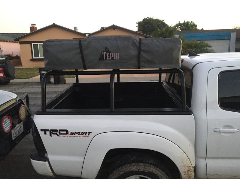

    the next weekend I needed to get the tent off the old truck so i can get it ready to sell so i needed a setup to hold my RTT.
    3ish sticks later and some flat plate i had made up a nice bed rack.

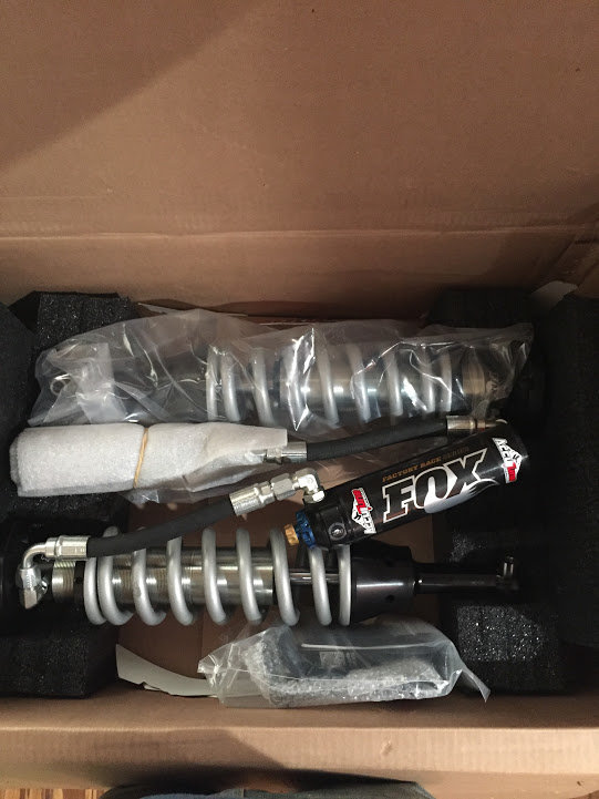

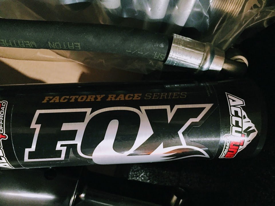

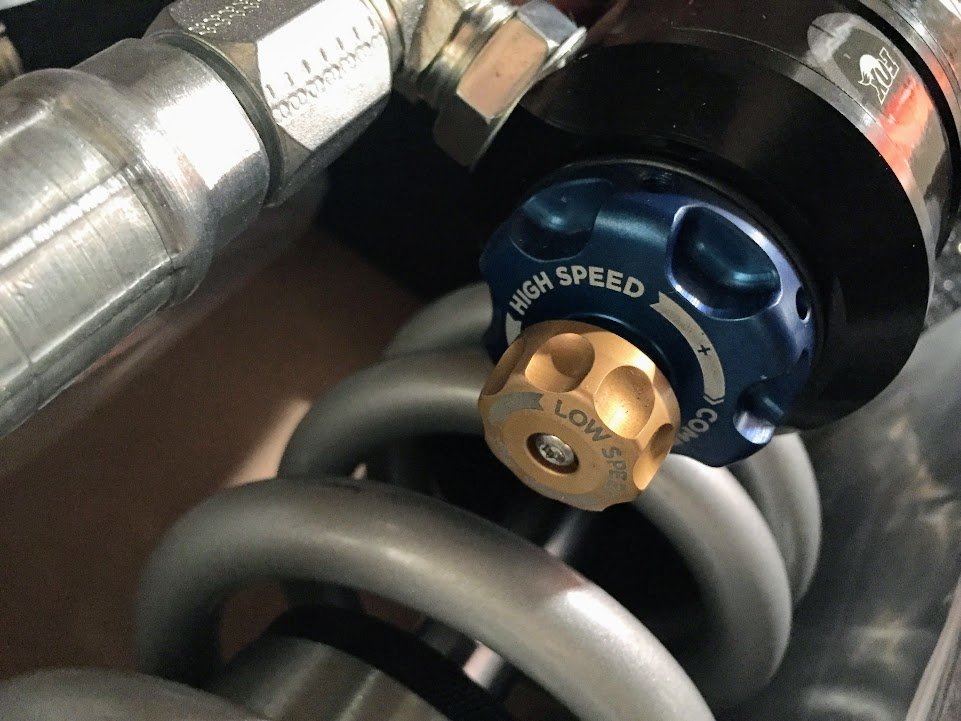

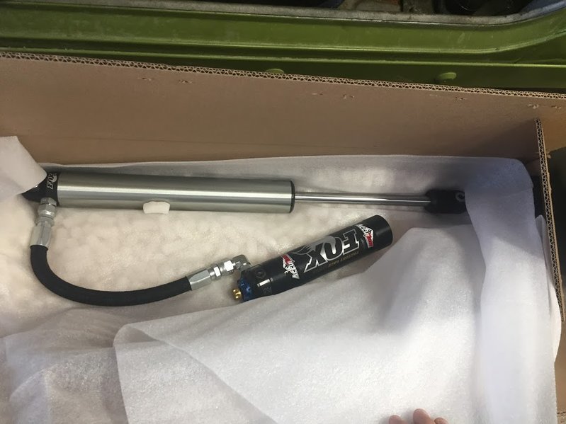

    Got these in the other day. these will go in the rear with custom mounts top and bottom. going to pair them with some deaver expo leafs.
    12" Fox with dual adjusters.

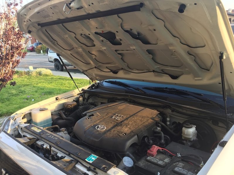

    got my hood struts today, this is always a must mod.

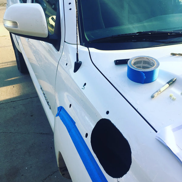

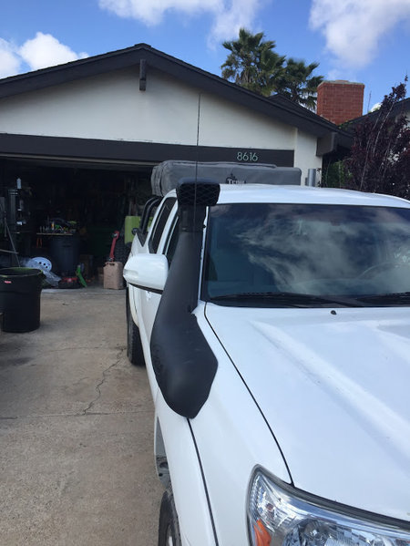

    got my ARB snorkel installed. so fun cutting huge holes in the truck :D
    and installed

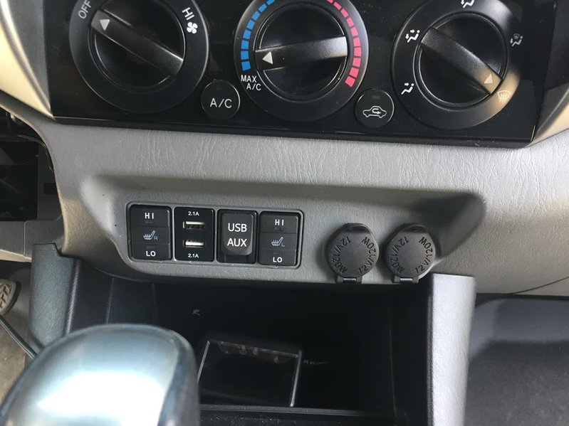

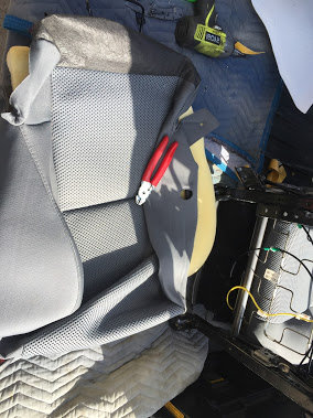

    also got my seat heaters installed lol, totally needed in San Diego.

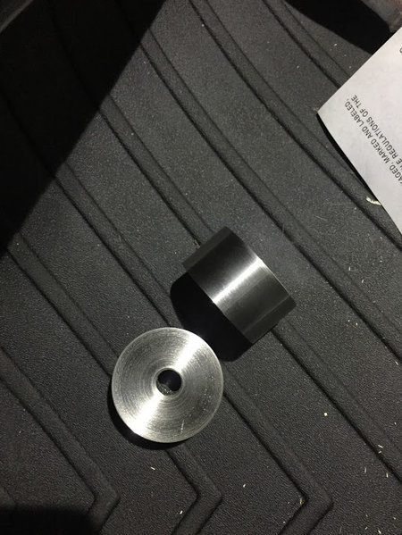

    while doing that, I raised the rear of the seats 1" with some stainless spacers i made.

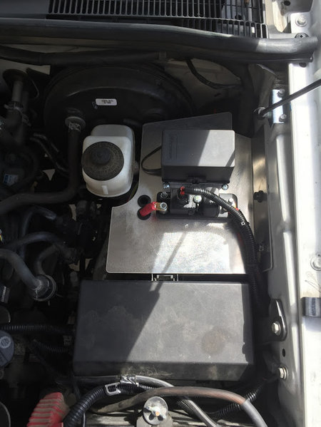

    also got my relay panel installed, should clean up things a bit under the hood for expansion

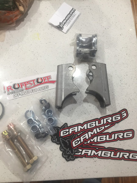

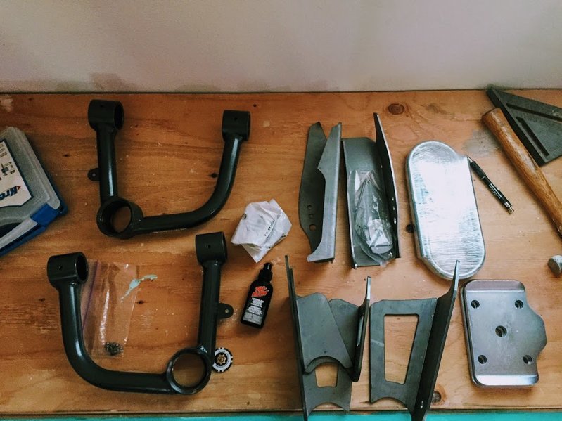

    also got more crap in the mail today.
    Thanks to a fellow TR member for the Camburg upper arms
    the Total Chaos spindle gussets
    Total Chaos upper arm gussets.
    Icon ubolt flip ready for hydro bumps
    and lube :D

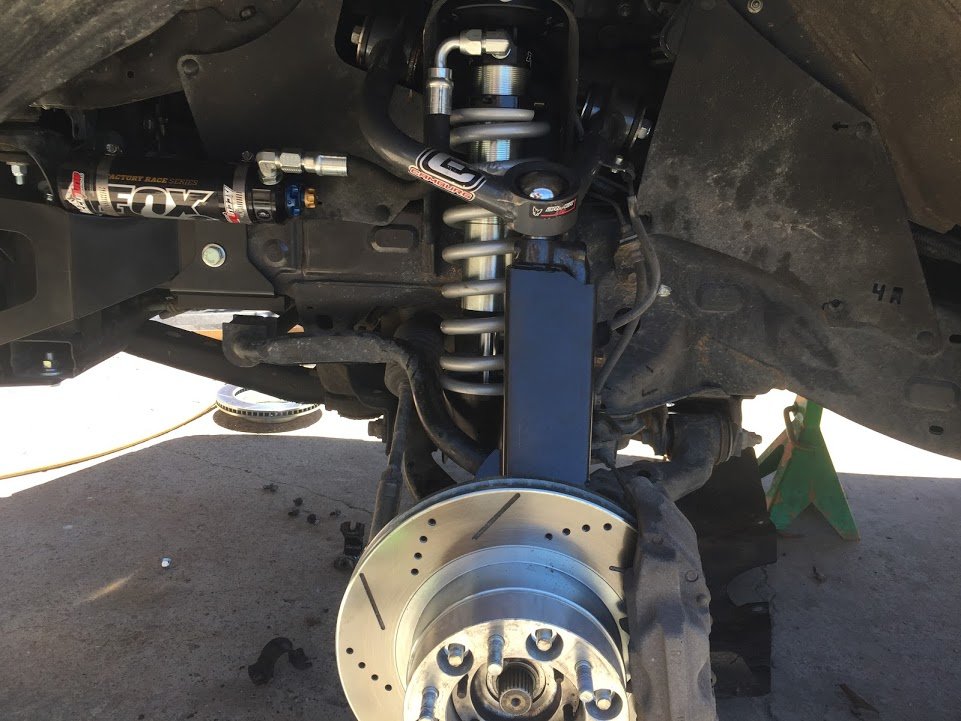

    got some more work done.

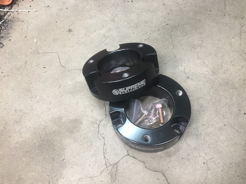

    picked up some dakar rear springs and some lift spacers for the front while i wait for the Fox coilovers to show up.

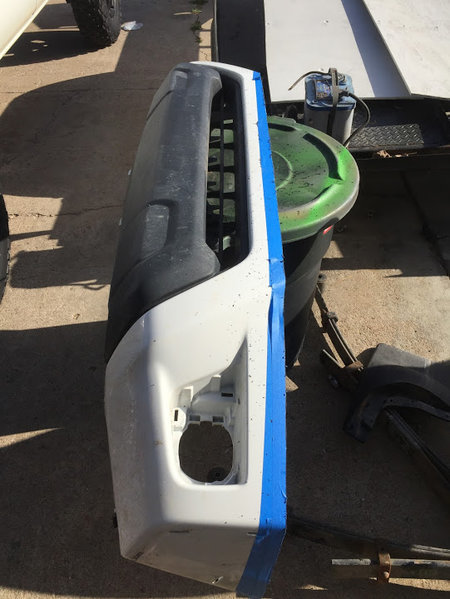

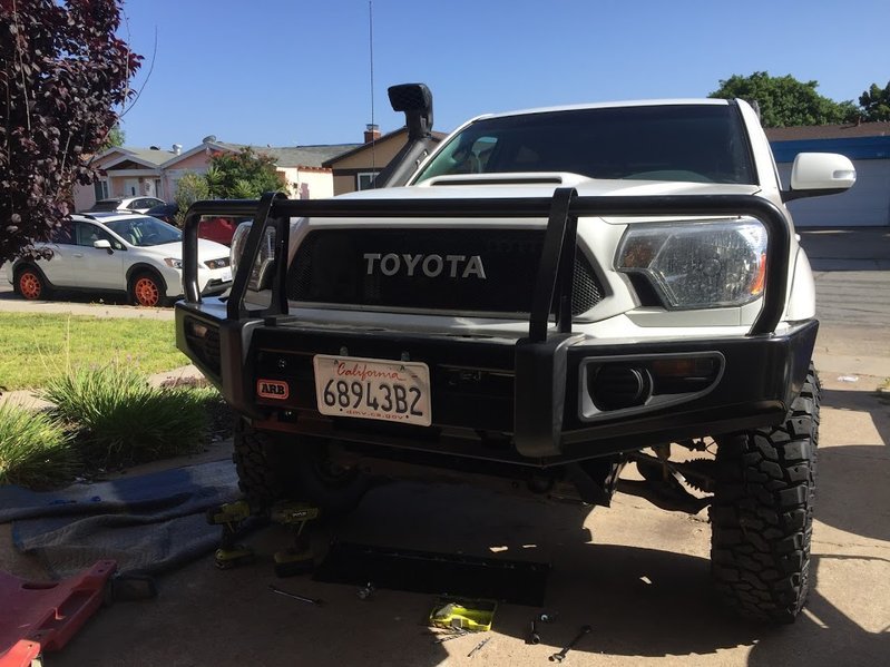

    new ARB bumper showed up also, got it installed and test fitted before i cut the stock bumper up.

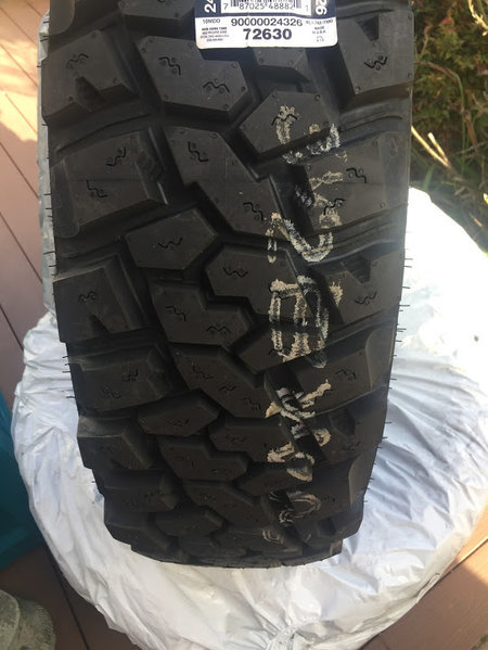

    new 255x85R16 tires showed up too

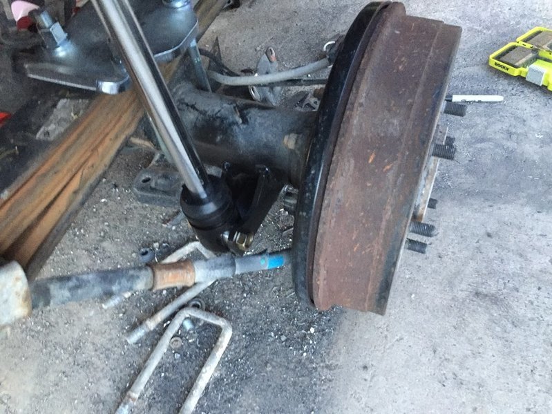

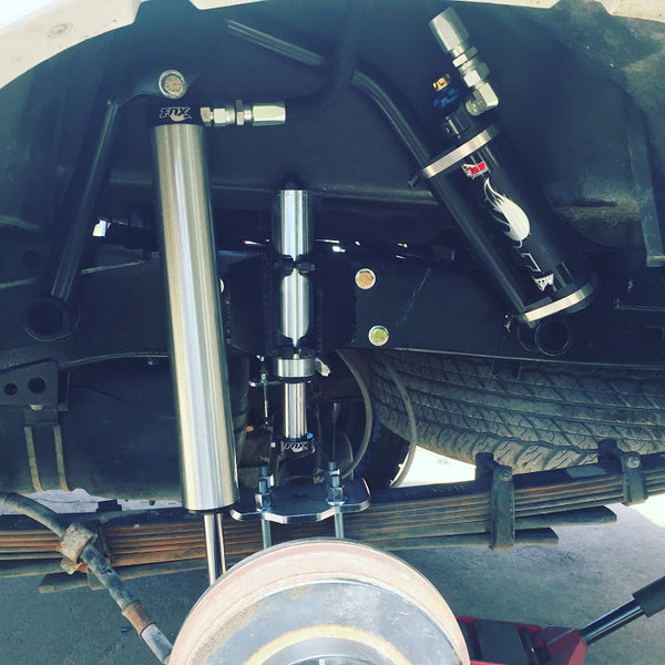

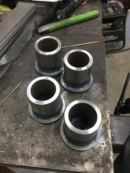

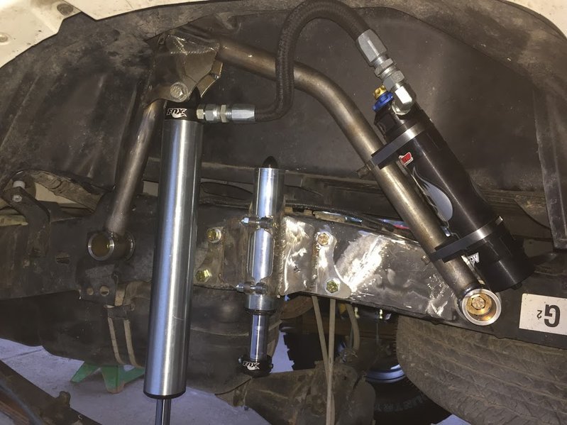

    got the rear shock setup done.
    started making the bolt on frame mounts.
    and welding up the lower mounts
    and all done but paint

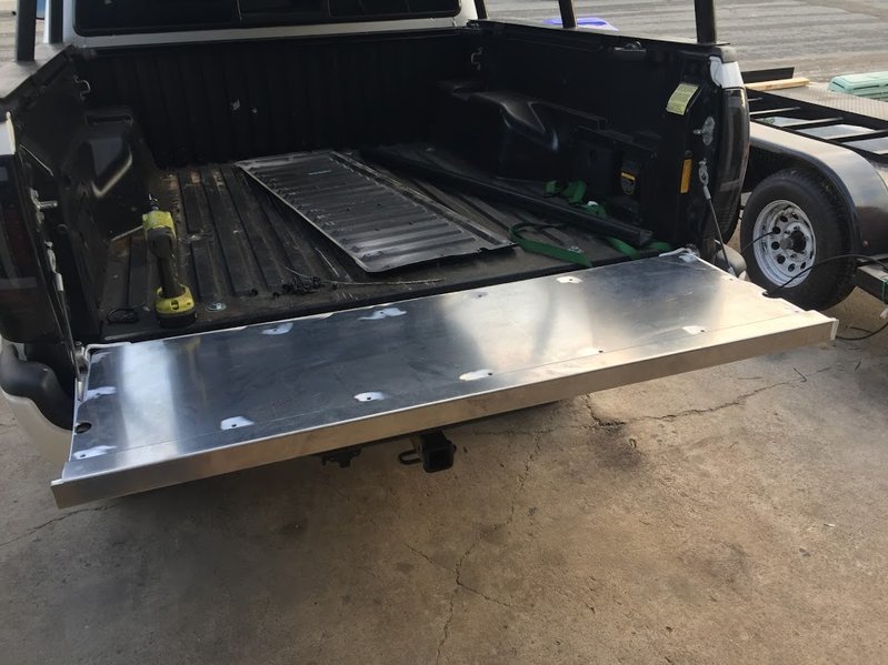

    wile waiting for more parts to show up, got a new tail gate support.
    you know its good when it says this on the box :D
    and test fitted, perfect.

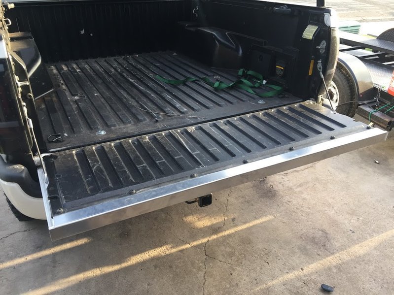

    i decided to put the stock cover over it for now too.
    and because i love stickers lol

    and rear shock setup all done and painted :D

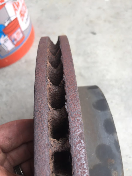

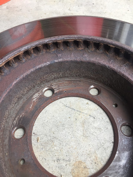

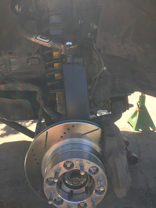

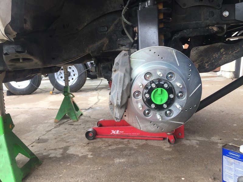

    got my locking hub conversion installed, new rotors to replace the old crap
    old rotors were crazy rusty.
    and all installed.

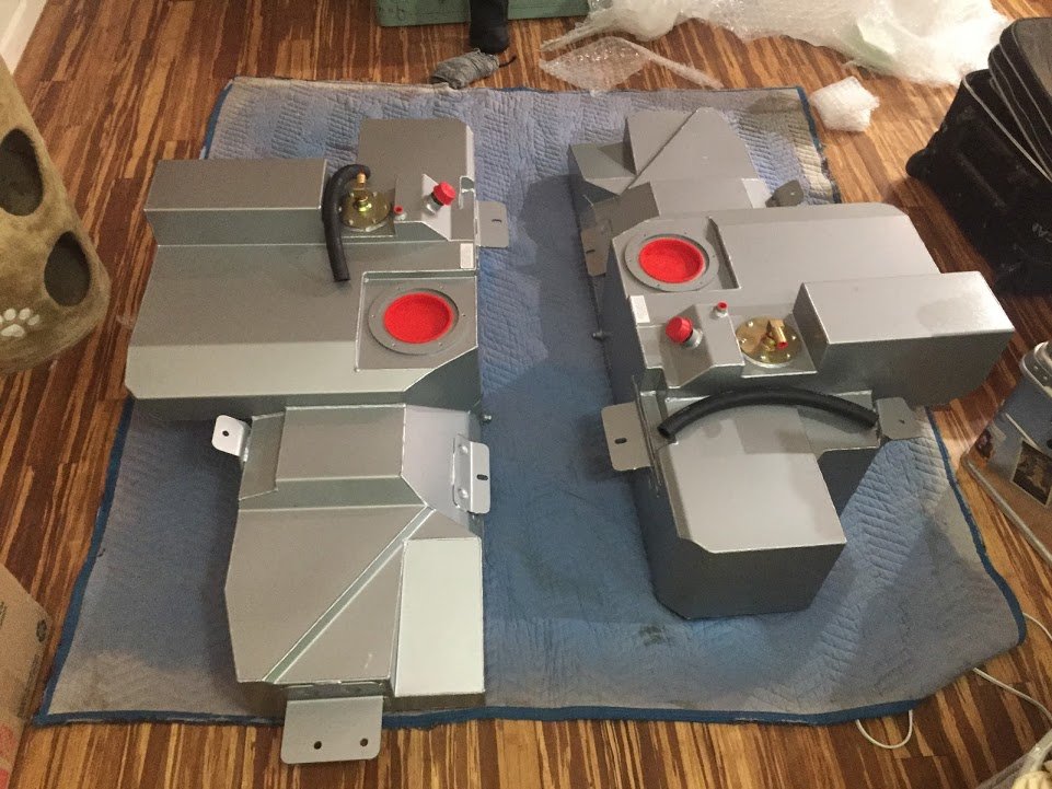

    and this came in. new long range automotive 34gal replacement tank.
