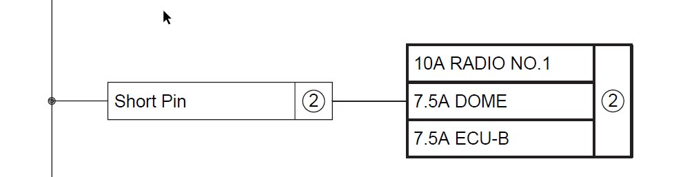

    The Short Pin is not a fuse just so you know what it is. It is just a connecting conductor to the following circuits.
    It is removed during shipping so that these circuits will not drain the battery during storage and shipping as they are always drawing power even with the ignition switch off. When the truck arrives at the dealer the Short Pin is installed and those circuits are then energized.
    And you should note that the ECU-B is fed from the Short Pin. So it appears that the ECU-B is drawing the current or something the ECU-B supplies is drawing it.
    Here is an overall system drawing :
    http://www.customtacos.com/tech.old...06toyewd/06toypdf/ewd/2006/tacoma/m/em01d.pdf
