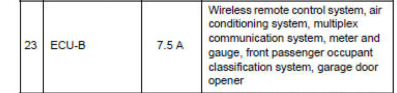

    I'm having my battery die in 2-3 days If don't drive it, tries to start but doesn't (battery still have a decent amount of charge, around 10-11 volts during these moments). once charged the battery tested fine at the local auto parts store. I only drive the truck a couple times a week, but don't think it should be dying in 2 days. I did a parasitic draw test and was reading at like 400ma, I checked all my aftermarket accessories, besides my alpha rex headlights (Remote start was removed completely and the turn on wire for aftermarket amp was disconnected, no change). So I started pulling fuses and when I removed the ECU-B No.3 Fuse that the draw dropped significantly down below 100ma. This was the only fuse that once removed showed any change on the multimeter. But From my understanding that ECU-B No.3 fuse is linked to quite a few things. Can anyone tell me what systems that fuse links to so I can continue to isolate whatever issues is causing the draw? Any diagrams or help regarding similar parasitic draw issues would be much appreciated. (2016 Tacoma Limited 50k miles, Yellow Top Altima Battery about a year or two old)

    Welcome to the forum. ECU-B 3 goes from the battery to the ECU and then the ECU controls a bunch of stuff as shown on these schematics.

    Maybe this will help too?
    You might have to start unplugging modules.

    1. A-TRAC

    Note, some may not apply depending on year and available features.

    Just FYI:

    Pulled all the fuses with the ECU-B out like suggested, didn't find anything. Even went a bought a new battery while my yellow top was on the charger, still the same results with new battery (even though yellow top tested fine I was just trying anything and everything). In another desperate attempt to figure out anything I tried reseating harness C29 on the ECU. I read some post about it on here or another forum (cant find it now) that it was linked to ECU-B no.3 in some way and thought maybe it couldn't hurt just to try. After I did that I retested for draw and I was down to 40ma consistently and it stayed like that for more than an hour, so in all honesty not sure what was causing the issue or if its really even fixed, so saying I figured it out is a stretch. Its hasn't been 24hrs since I "fixed" the issue, but no drop in voltage on the battery after sitting overnight and still no excessive draw. Hopefully it continues to stay that way, planning on letting the truck sit until tomorrow afternoon and retesting again to be safe. Will post if anything changes. (Id like to mention during all my testing I made sure to wait awhile after unhooking the battery to do the test, didn't keep the key nearby, and made sure the hood latch sensor and door sensors were disabled so none of the systems would be awake, just to confirm there was no draw from that stuff).
