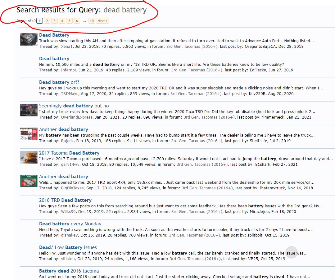

    ...and can it just be that it's time for a new battery? Our OEM 2018 battery needed replacing after 6 months of ownership without a remote start on it. We dug into it and found numerous threads on this being a known issue due to how Toyota under sized them. Without knowing the dynamics of how often you drive or not drive, your weather and so on, it's not an issue that we would consider being related to. It's always just coincidental, or something else...
