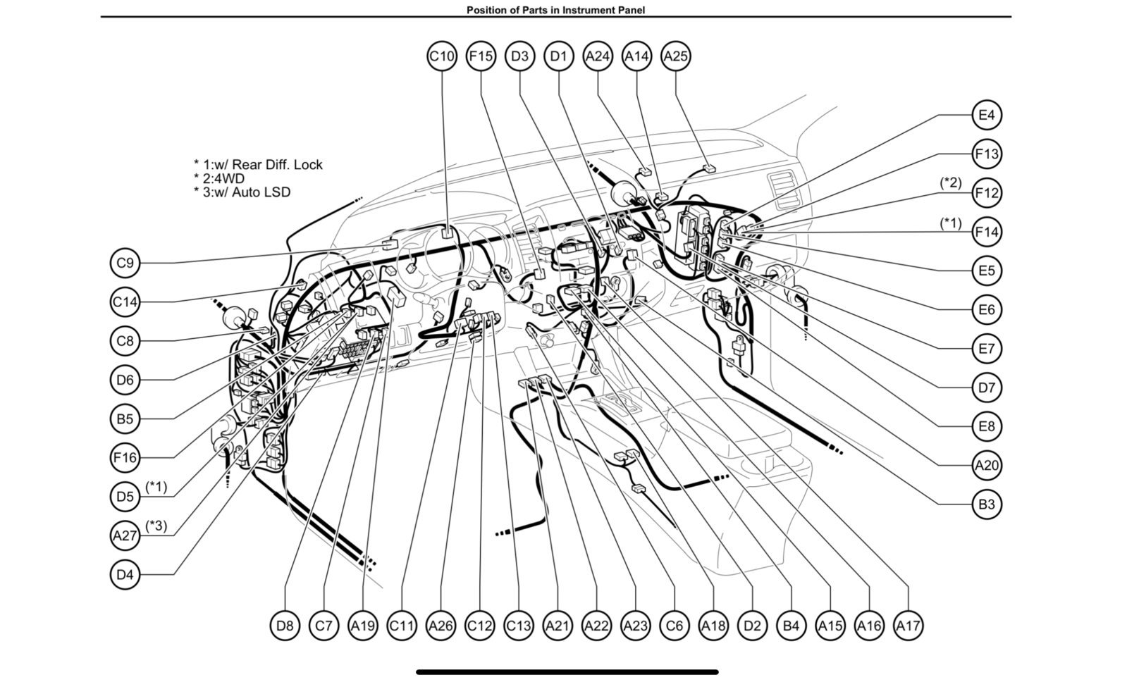

    The interior light is controlled by the Body ECU.
    When the door is open, it grounds pin 28 of the Body ECU.
    When this problem occurs, does the interior light come on?
    What about the door open light on the dash below the speedometer?
    Anyways, here is location of the door control receiver. D7
    D7 is only used for the wireless door locks.
    I don’t think it has anything to do with the problem you are describing.

    TnShooter you are right. I just found it. Unplugged the ECU and no change. Found a blueprint that D7 was not in the circuit. Took the short door skin off drivers side and started unplugging connections ,draw went away with the single wire push switch when the door closes. Tested it 3 times and it came back. Thank you. DON
