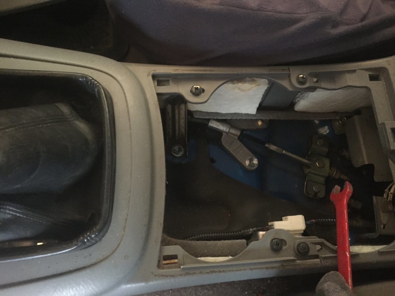

    Close! It's under the cup holders just behind the shifter.
    I took the other suggestions first and checked out the drums and pads before making any adjustments....

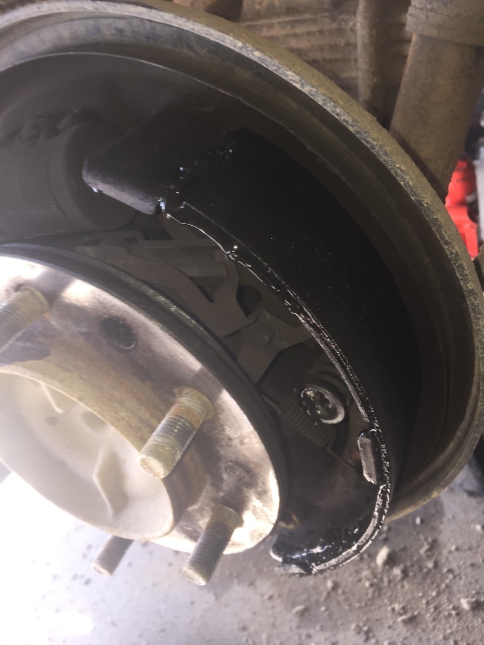

  12. Apr 14, 2018 at 2:48 PM
    Tacoma Mike
    Aug 6, 2011
    #61230
    31,519
    Southern Maine
    Hard to tell but that looks like rear axle seal.
    Don’t see anything from the wheel cyl. In the pic.
  13. Apr 14, 2018 at 2:52 PM
    DayStars
    DayStars [OP] Well-Known Member
    Jan 31, 2011
    #50259
    82
    benn
    Edmonton
    07 Tacoma TDR 6spd DCSB
    I suppose that seems likely. Any suggestions on how i can be sure? It doesn't seem to be on any of the other pad/drum components or springs.
    What else could it be?
  14. Apr 14, 2018 at 2:58 PM
    Tacoma Mike
    Aug 6, 2011
    #61230
    31,519
    Southern Maine
    Wheel cyl or axle seal. Nothing else is in there.
    You can pull the wheel cyl boot away a little to see if any bk fluid comes'out.
    The axle leak can be a very thin line hard to notice under the axle by the housing. It will weep to the backing plate and collect on the shoe.
    So if it is leaking your talking all new brakes and axle bearings and seals.
  15. Apr 15, 2018 at 6:42 AM
