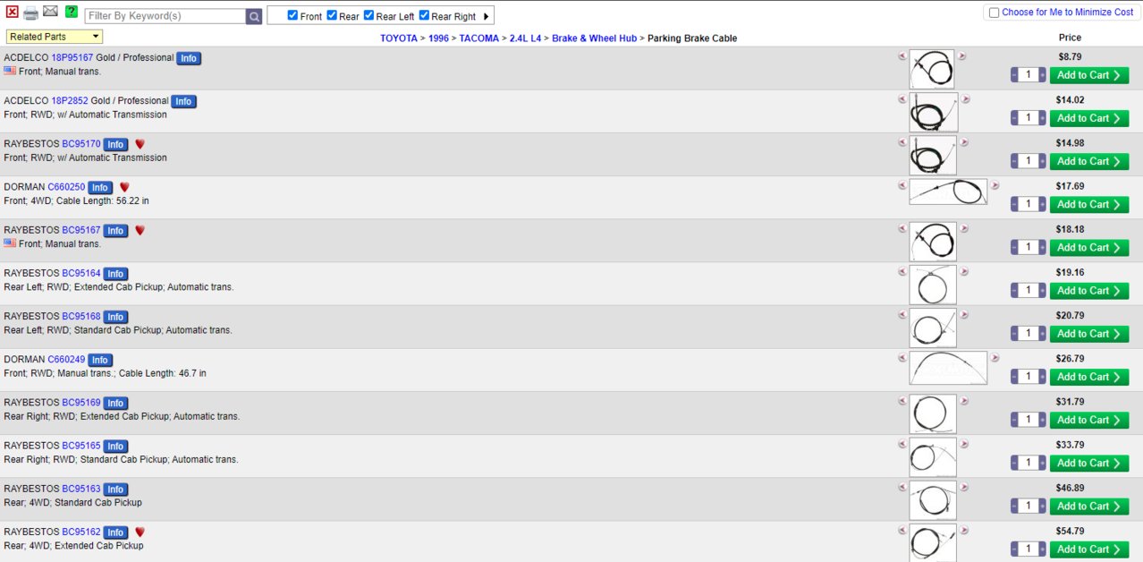

    RockAuto has different ones listed for 2WD/4WD and whether you have a manual or auto. There are 3 cables, one front one and one for each side in the rear. One of the first 2 listed might be right, and only 25 bucks for both. The Dorman ones list the length, and some have the length listed in the details.upload_2021-8-11_10-43-17.jpg

    The OP needs the front one that is from the parking brake handle to the bell crank on the frame... this going off of his posted pics.

    Ohhhhh that makes sense.
    I was interpreting it as there was an option for a front axle parking brake. But it would seem more correct that I need the front cable that runs to the rear brakes
