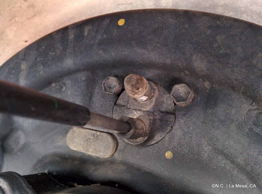

    How I adjust the rear brakes (and parking brake) is to jack up the rear end of the truck and place jack stands on both sides of the rear axle housing. With the e-brake off, I spin the wheel. If it rotates more than 1 complete revolution, then I tighten the star wheel in the drum. To tighten the star wheel, you remove the rubber cover and insert a small flat head screw driver and push the star wheel until you hear an audible click (getting tighter). Repeat the wheel spin test as said above, and adjust the star wheel as necessary until you spin the wheel and only rotates one time.
    Repeat this procedure for the opposite drum and you'll have completed the rear brake drum adjust procedure.
    The star wheel is behind the oval shaped rubber dust plug in the picture below
    Here, this is the angle you want to have the screw driver at to push the star wheel. It's kind of a pain at first until you get the hang of the angle required to move the wheel.
    If you've never done it, it's a good idea to pull the drum cover and clean out all the brake dust. I did this with 55K miles and there was lots. Just spray away with brake cleaner and it gets sparkling clean. :D Don't breath the dust though, it will kill you. Heh :D
