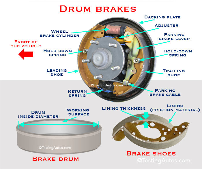

    Ultimately its just the nature of drum brakes, they built a tiny build up of corrosion and fused to the drums. We see it a lot in the winter with car washes.
    There was a TSB awhile back for older models but this will pretty much always happen in this scenario
    Best to drive it after, or simply avoid using the parking brake after wash if possible.

    Water/cleaner gets in and temporarily dries up moving parts. Cylinder or retracting spring get seized up.
    Ask a brake guy but I think rear drums can be adjusted. Overtightened drums would have less retraction space.
