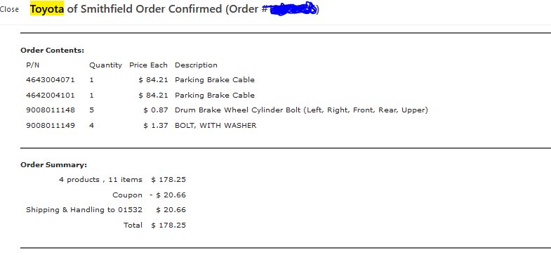

    I have the 4x4 manual transmission 2010 access cab.
    These are the parts I just ordered for the parking brake, 5 bolts for the attachment to the rear wheels (needs 4 but who knows...) and the 4 extra bolts for attaching the parking brake lines as needed if I strip some removing..
    Toyota of smithfiled RI had the best price at $84 from an MSRP of like $140 for EACH side cable, Left and Right
    Promo code right now FREESHIP for orders over $75...
    I also bought the entire rear drum kit from RockAuto
    https://www.rockauto.com/en/moreinfo.php?pk=8845476
    And new Rear cylinders from Amazon...
    https://www.amazon.com/gp/product/B002EP1CQK?ie=UTF8
    Basically a full rear brake job to resolve this issue...
    And a week off from work to DIY ( I have plenty of vacation)
