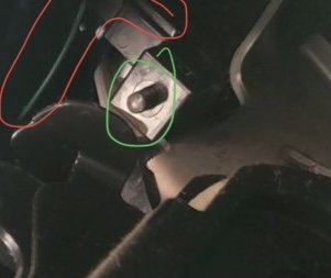

    If it’s a pioneer or Kenwood or most other models of radio (besides some higher end alpines)
    Up at the top of the e-brake pedal, there is a little pin switch
    The pin switch is in the green circle. there is a wire coming off the side or top of this pin switch (red circle)
    that is the wire you need
    pinktaco808 and Burner1061[OP] like this.
