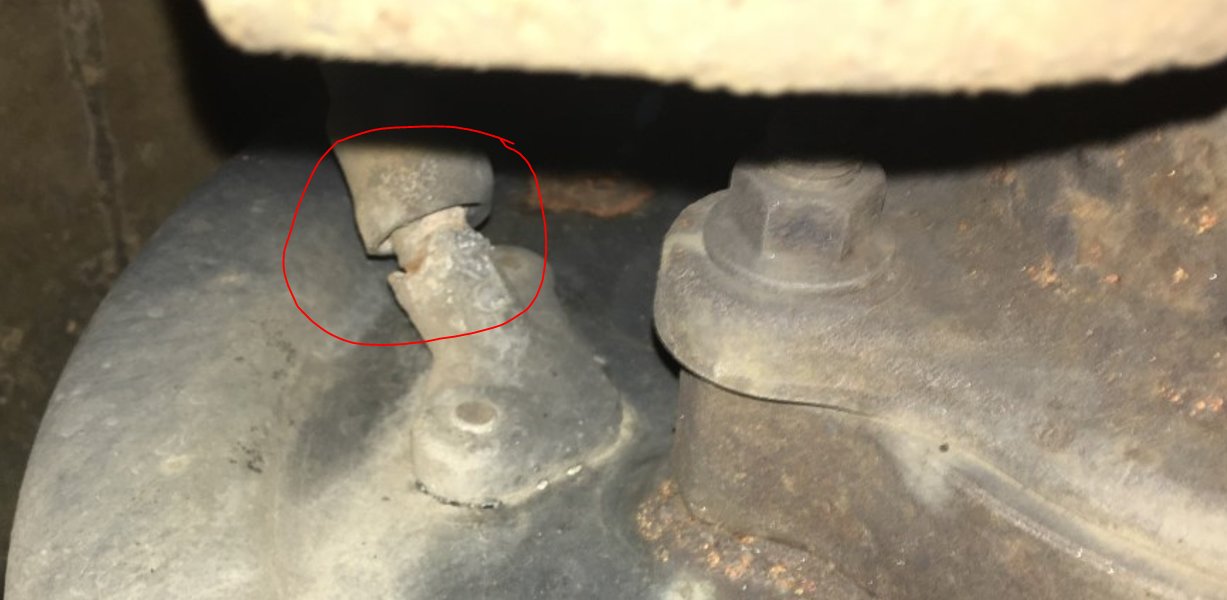

    This is the issue

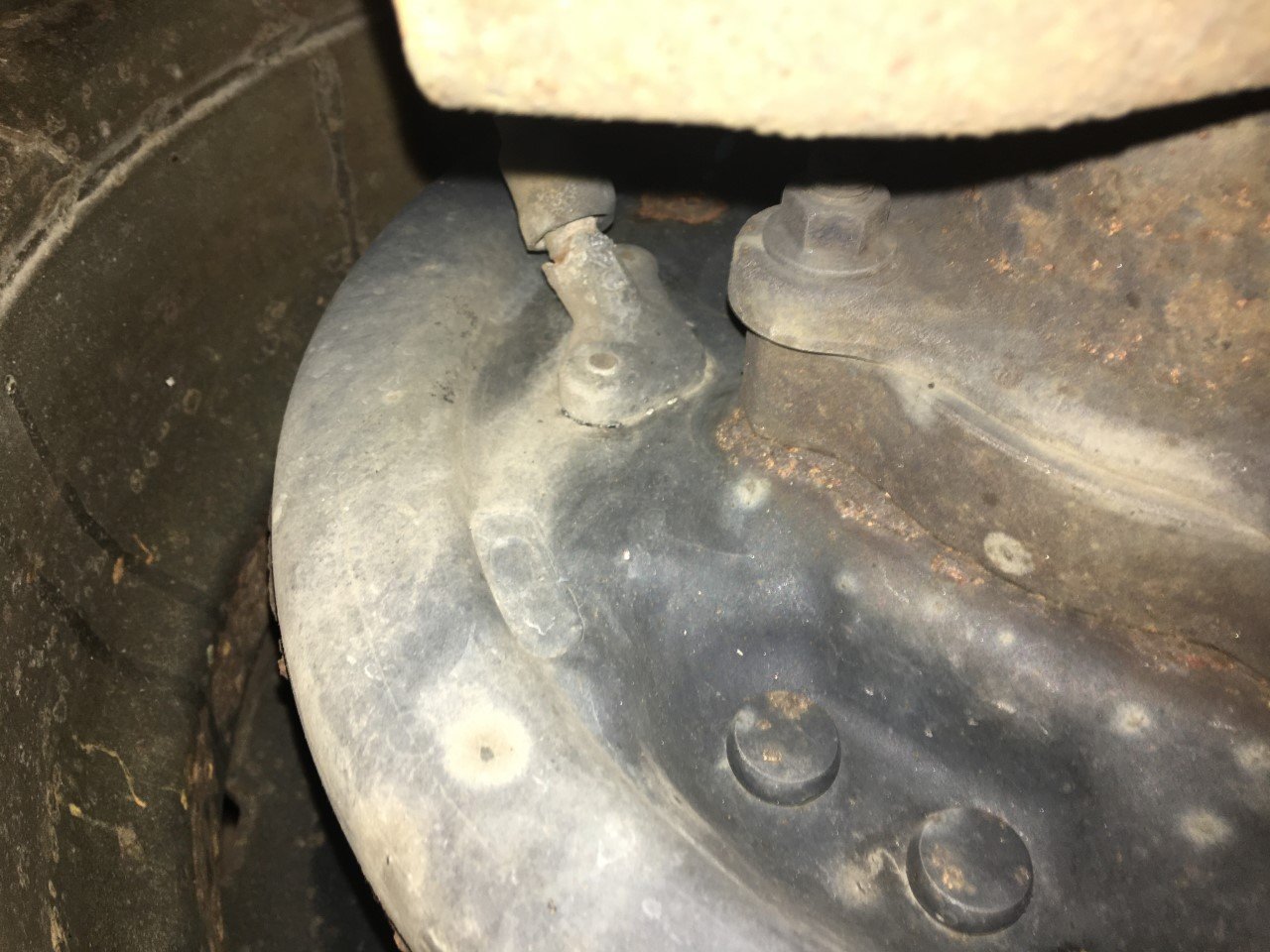

    Examine where the emergency brake connects to your rear drums and look for the broken aluminum connectors. After an eight month back order I finally received the factory brake lines and replace them and it fixed the problem https://m.youtube.com/watch?v=IwIMG4jfnkY

    my ebrake cables at the drum end are corroded and malfunctional....What is the length of the two little 10mm hex head bolts that got into the crappy pot metal? (they snap when you try to remove them from the backing plate)
