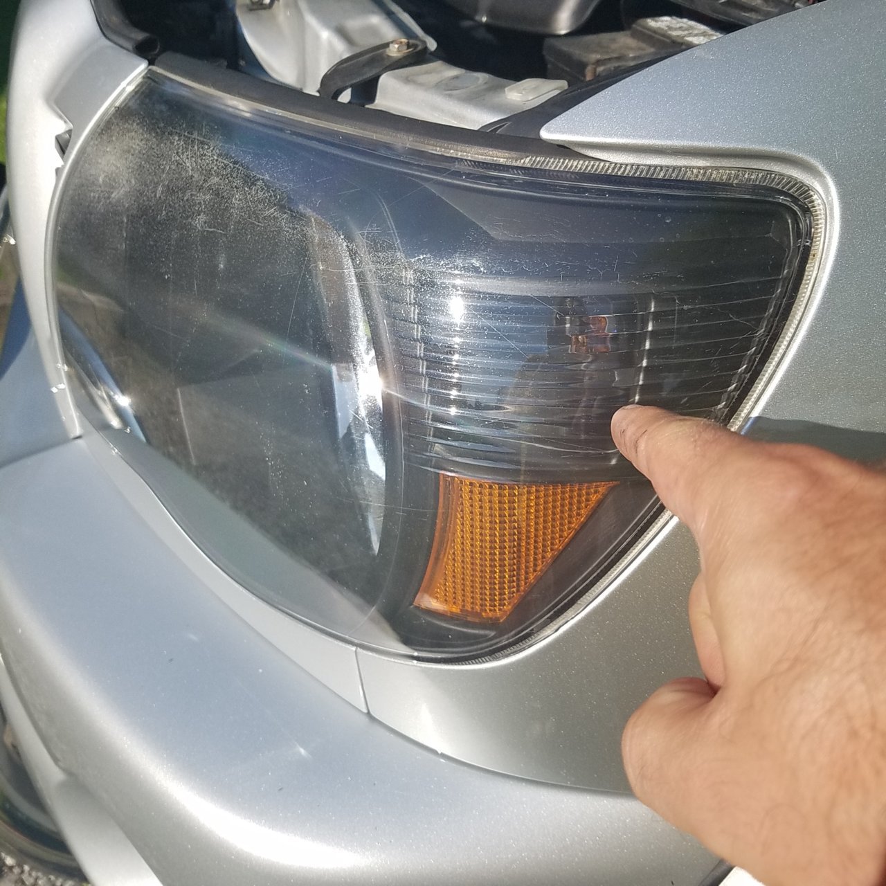

    Im not sure if this has been covered but I cant figure out why my parking lights wont come on when I turn the headlight switch to the first position. I have a 2007 Tacoma sport. I know its not the bulbs because when I set the alarm they flash and when my headlight are on they work. Any Ideas?

    x2,they are on the outside of the headlight,not the inside

    I dont know the exact name but its the amber lights closest to the grill in the center.

    You will also notice that those lights (DTRL) will NOT come on when the parking brake is on.... Cool, eh?....

    As mentioned at the top of this thread, the amber lights immediately beside the grill are NOT parking lights - they are signal lights, and used as DRL's for truck so equipped. There is no "problem" with your truck from your description.
