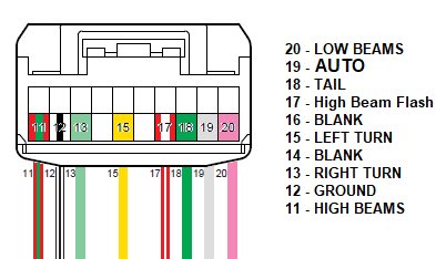

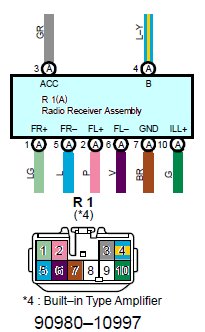

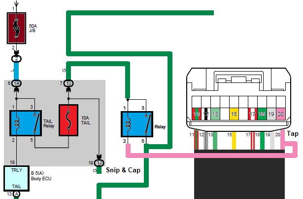

    Snip the dimming wire of the connector to the radio (cap the harness side) and attach it to relay that is activated by the steering wheel headlight connector (Low beam)(it's a negative trigger)

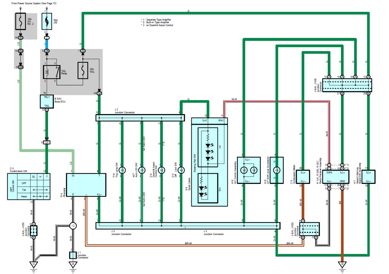

    What about the dash lights, ac lights and license plate lights?

    Just this then. It handles the dash illumination (all) including the radio.

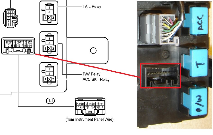

    On connector 1J slots 7 & 19 are the dash illumination wires (+), this connector is located on the rear of the box that houses the cab fuses.
