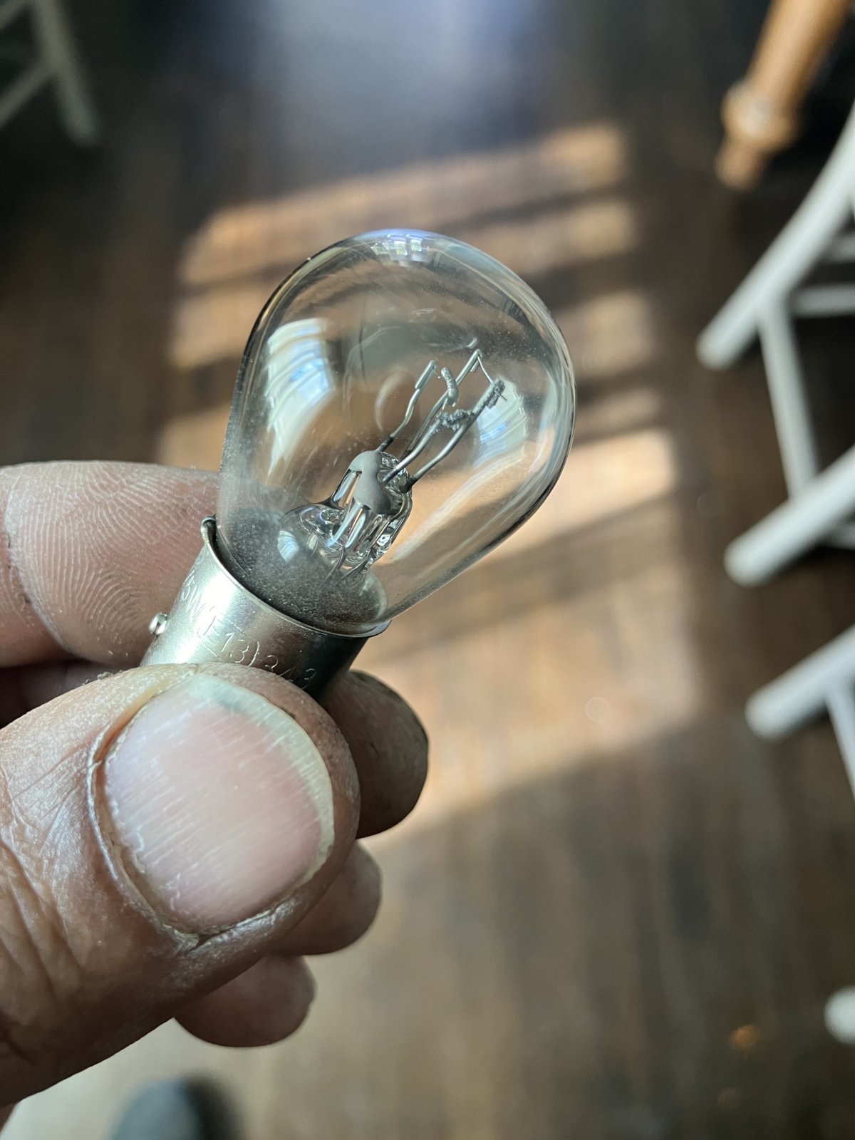

  15. Apr 17, 2024 at 6:57 PM
    #35
    Beyondtrd
    Beyondtrd New Member
    Apr 17, 2024
    #448137
    01 Tacoma 4d 4x4 TRD
    Tube frt bumper , DIY rear plate bumper, Manual locking hubs small lift
    Had the same issue . checked all the things mentioned , disconnecting a keyless entry system and trailer harness with no luck. Stop light bulb ende up being the cause. The 2 filaments had fused together causing my dash and parking lights to turn on when pressing the brakeIMG_3905.jpg
    Dm93 likes this.
