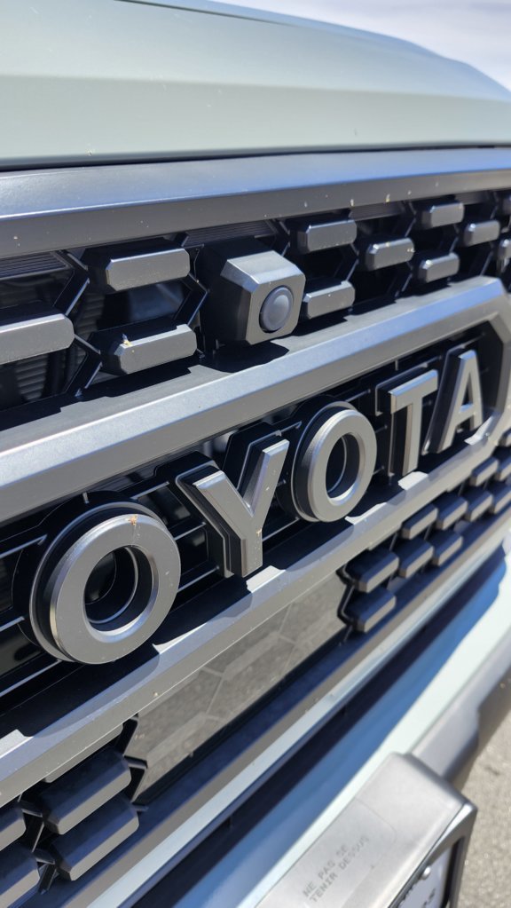

    Just picked up a used 2022 TRD off road where the previous owner had installed the OEM TRD lift kit (part number PT84K-35221). At the top of the front grille (included in the kit) there appears to be a sensor of some kind, but it looks like it's in a mount intended for a front camera. It's definitely connected/wired into the truck.. just not sure if if it's a sensor because there's already a separate millimeter wave sensor for TSS below.
    Is this a parking sensor?
    Any chance I can replace this with a front camera?

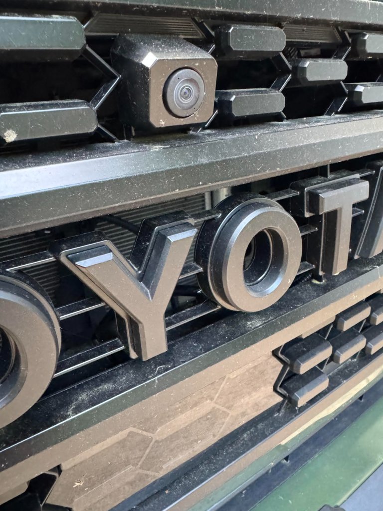

    that is the front camera.

    Actually, on mine it is the front camera, but in your photo, I can't tell if it's the lighting or not, doesn't actually look like a camera.

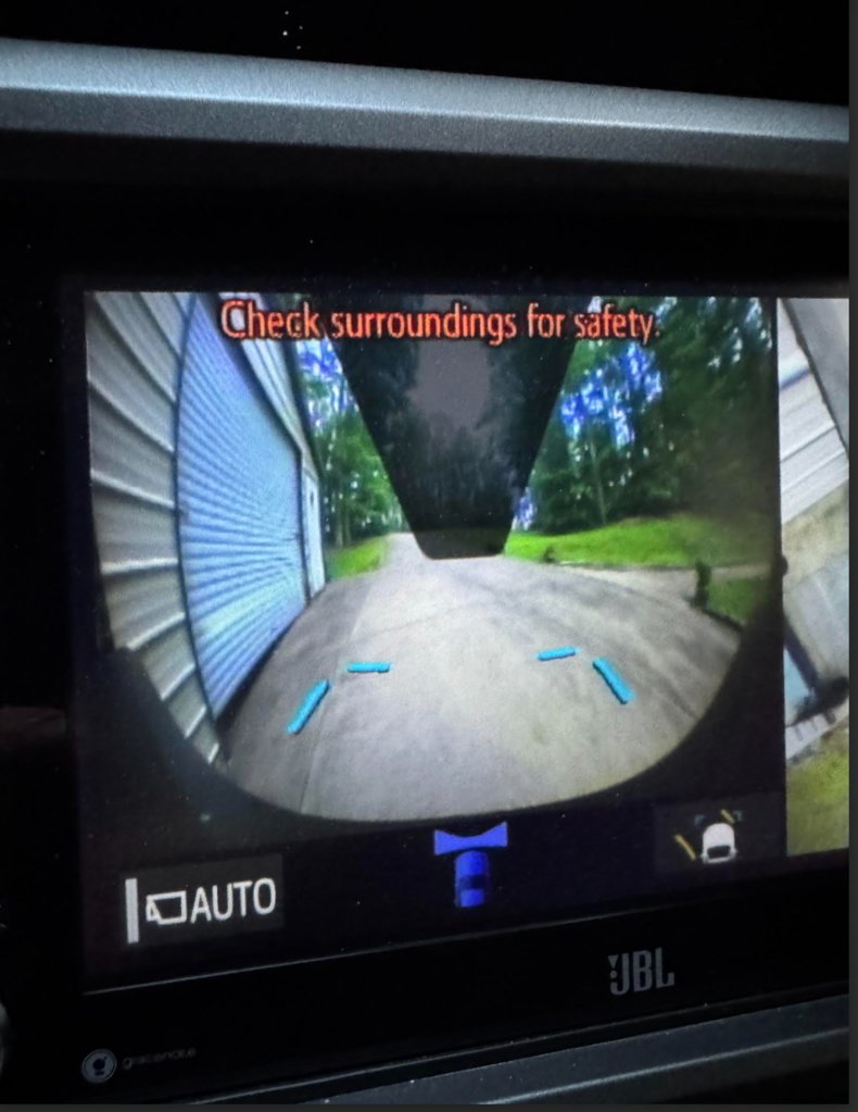

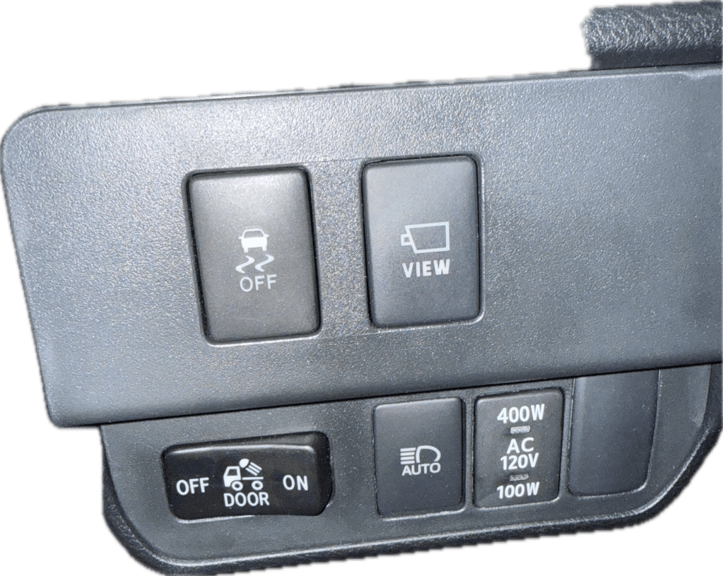

    It’s a forward facing camera for parking. You should have a view switch to the left of the steering wheel.
    Edit: I took a second look and now I’m uncertain cause it doesn’t look like a camera lens.

    The center circular 'front' that would be a camera lens is completely opaque.
    Instead of a lens it's solid black.

    Yeah. seems like it should be a camera.. but the lens part is solid black.... kinda strange

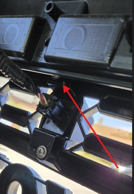

    Is it some kind of placeholder? Can you remove it and see if it's just a piece of plastic?

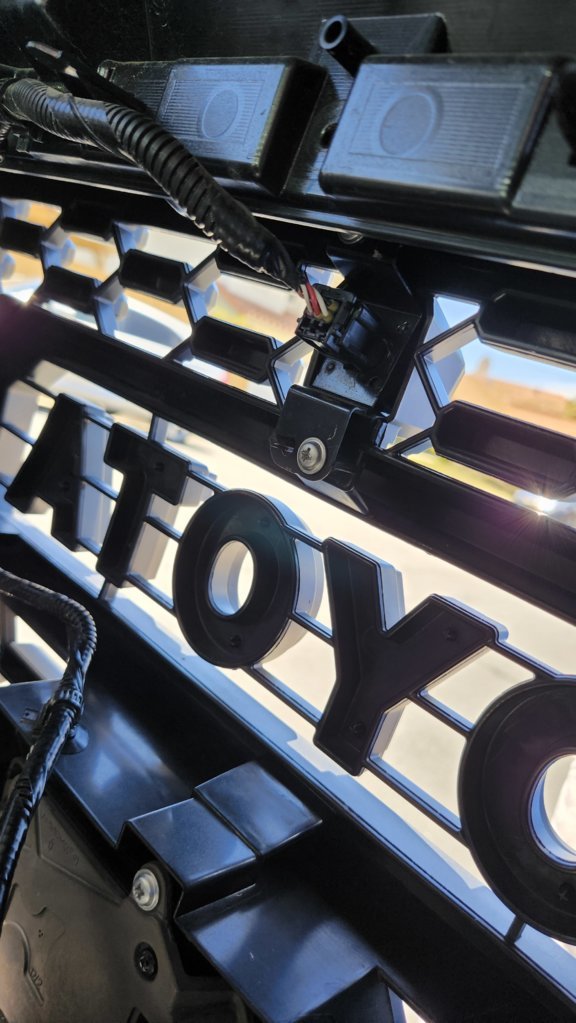

    Hmm.. yeah. that could be the situation ... (plastic placeholder to hang on the harness)
    ..EDIT...
    Yep.. was a plastic placeholder. I pulled the harness out of the back of the mystery item and there is nothing on the receiving end but plastic. It's just holding onto the harness.

    With the harness unplugged, what's the plastic thing look like from behind? Any actual contacts for the harness?

    Mystery solved.. Unplugged the harness and there are no contacts on the receiving end. (which is what a few of you said :thumbsup:)
    It's a placeholder as a few of you mentioned.
    Looks like my next step is to find a camera to slide in there and do some research to figure out what internal plug/wires inside the cab end up with the signal from whatever camera will slide in there.

    Trd lift/ heritage grill comes with dummy camera. I think it actually comes with another mil/wav sensor. Then the dealer says, welp, that’s new so we have to calibrate it, :spending:

    Purchased the kit last week and can confirm exactly what Willy's saying. I think you would still have to run wires through to the back of the head unit too, would not be as easy as slapping a camera in there and it all works unfortunately.
