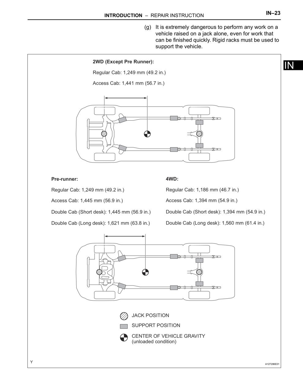

    Think about it. Wheels down, first contact is tires. Suspension bears the weight and the impact. With the frame on jack stands, you have the weight of the vehicle on 4 spots on the frame. Tips of the stands are probably 1”x5” so that’s a lot of weight on a small portion of frame. Just seems like that could be a bad thing over time

    The steel in the frame and cast iron in the jack stand don't care if it's 5 minutes or 5 years, they'll either hold up the weight or they won't. The stand manufacturer anticipates this when they rate it, a 3 ton will have a smaller bearing surface than a 12 ton. Toyota also anticipates this. You'll notice they give suggested points where the frame is folded or thicker just for you to use for a jack or stand.
    For example, these are the floor jack and support (jack stand or post lift) points from the 2005 Factory Service Manual.
