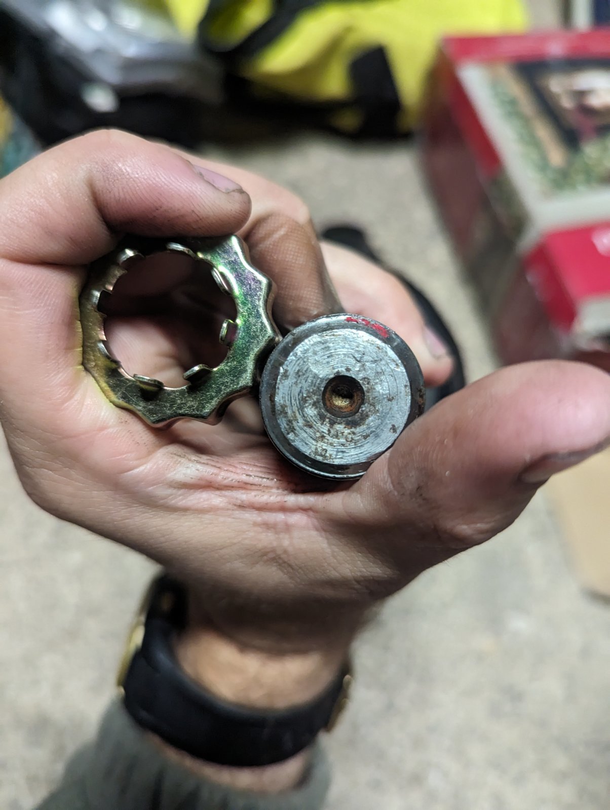

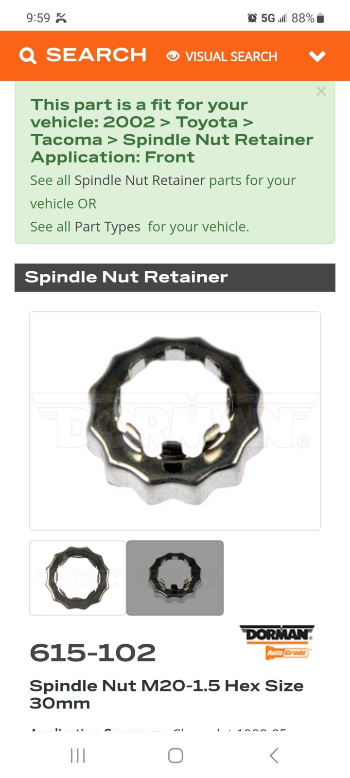

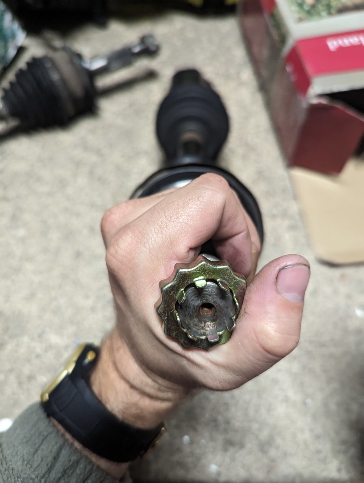

    Does anyone know the part number for the CV Axle nut castle retainer or a suitable replacement? Whoever was working on the hub last neglected to put it back on, and I currently just have a cotter pin and the bare nut. I've tried finding an aftermarket retainer, but the largest internal diameter I could find is 22mm.

    Thanks for the links! Yeah, I bought some OEM cv's from a user here. One of the axles I replaced was definitely aftermarket but had the stock 35mm nut and retainer, the other looks identical to the OEM, and only had the stock nut with not retainer.
