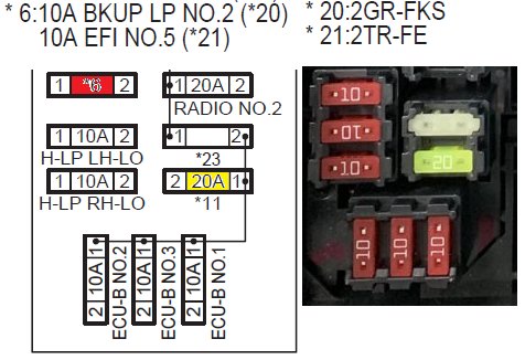

    Verify if the Engine fuse box has the 10A BKUP LP No. 2 fuse.

    I thought about the relay suggestion, seems like a better way to go. Can I just drill and tap a hole in a frame rail to mount relay?
    Also, what connectors do the factory reverse lights use? I might as well make a proper harness that doesn't involve cutting into the factory one.

    ^ The switches I have are make-or-break. They do not switch between two contacts. The cab switch is of the CH4x4 pushbutton type.
    But the idea of using an add a circuit in the factory fuse box under the hood is great. I already did that for my driving lights, the high beam signal provides power to the driving light switch in cab. I can use the combined diode/fuse part you gave above.
