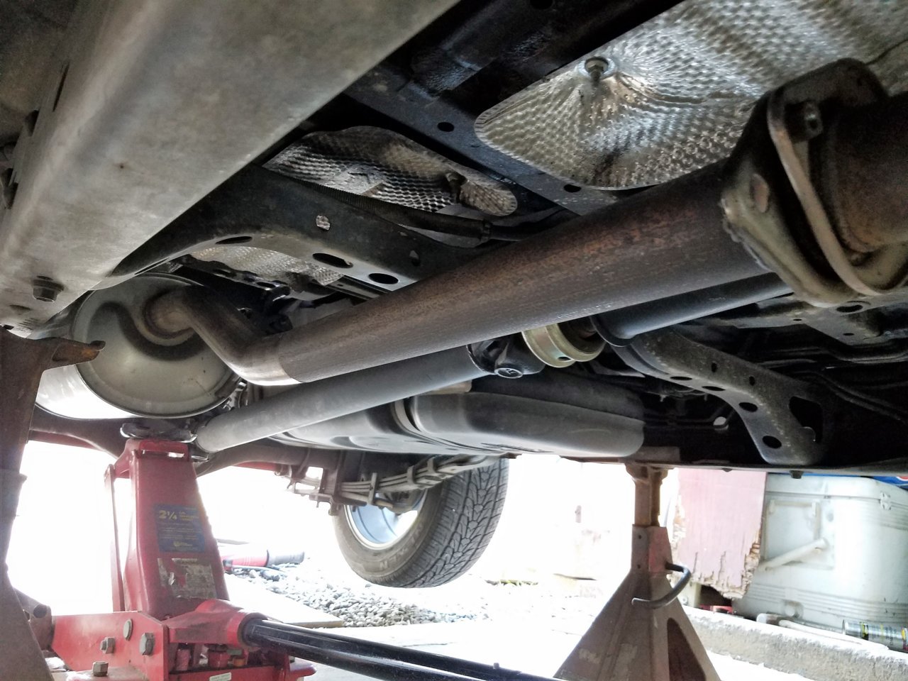

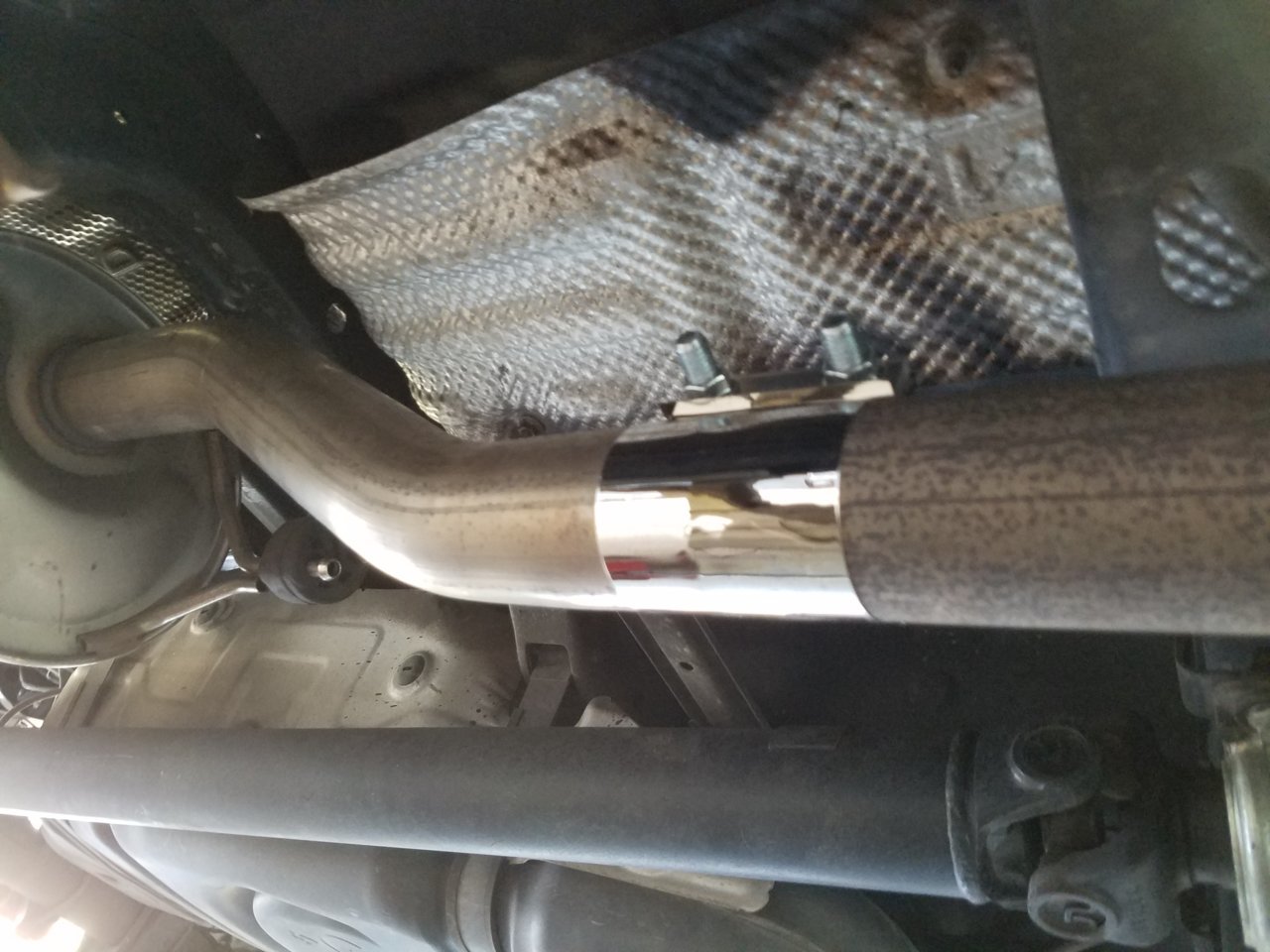

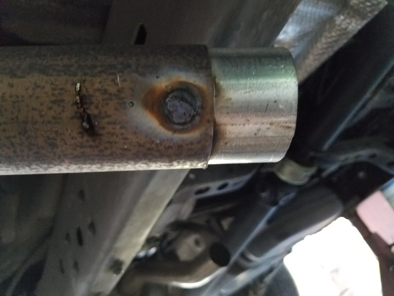

    FYI 2016 exhaust fit with some mod .Rear hanger needs to be bent about 45 degrees and need to splice on you front half on . Mines a 4dr short bed so not sure will work for you . Got almost new exhaust on craigslist for $40 so chanced it .

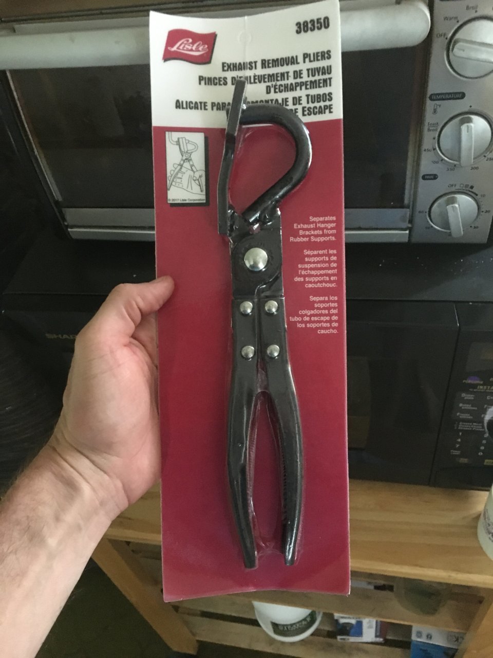

    I did get an exhaust hanger removal tool. Also got new gasket, new springs and new bolts.

    That tool will save your ass. That was the hardest part for me and my buddy who helped me. Literally sweating trying to muscle them out.. even with dawn soap as lube lol

    Got my TRD cat back installed, was a pretty easy job. Took about 45 minutes by myself at a very leisurely pace. As suggested, I removed the spare tire to create some extra room. Also I jacked up the rear end to give me more room under the truck. There is a soft brake line that goes over the rear axle, be careful not to damage this when fishing the tail pipe section over the axle. I replaced the two bolts and springs with brand new Toyota hardware. I got a new exhaust gasket as well but the old one was stuck on there pretty good so I didn't remove it. The exhaust hanger pliers are 100% essential tools for this, I wouldn't attempt this without those. They make the removal of the hangers a breeze.
