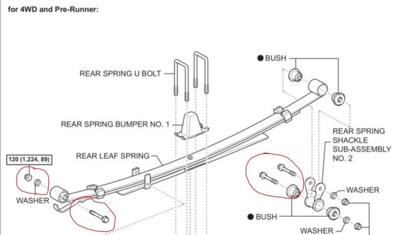

    I had to cut one of my bolts out of the leaf spring today to remove and change them... anyone know where I can find a part number for the bolt pictured? My toyota dealer is fairly far away or I'd just go to the dealer. Thanks in advance if there is an easy way to find it.

    I just bought some on Friday for a leaf spring swap today. Bolt part# 90080-10138. If you need the flange nuts as well they are part# 90178-A0050.
