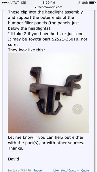

    Replaced both headlight bucket assy's two days ago,,all went well until the familiar plastic pop of a 1999 era failing trim clip.
    https://www.youtube.com/watch?v=G_4RUm_RWnk
    At 1:48 you have the plastic trim end clip almost dead center of the pic,,to the right is the grey clip that grabs the filler panel a bit better, then of course that filler panel gets attached with a self tapper into white nylon on the other end.
    Another still pic of the grey clip at 1:52,,if you can grab it there.
    Any ideas on part numbers for that grey clip?. I have the end clips (52523A & 52522B) and I have the 7 grille clips, But for the love of Mary and 2 days of hard searching I have yet to see a representation or number of that elusive damn clip.
    Thanks ahead of time.

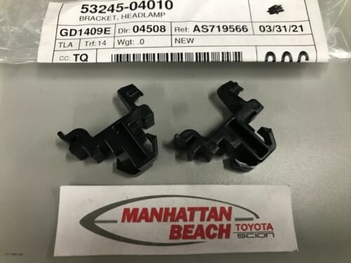

    I believe it is 53245-35010. I have this attached for ya.

    A pic of the piece in question.
    Thanks Kdf, appreciate the reply, will stop by the stealership and see what matches up.
    ZERO online shops,,Toyota or otherwise,, show a pic of this clip. And what they do show with line drawings,,looks like a flattened pac man. My paperbacked "85" FSM manual has more detail.

    Does this help?

    53245-35010 I think was the right one.
