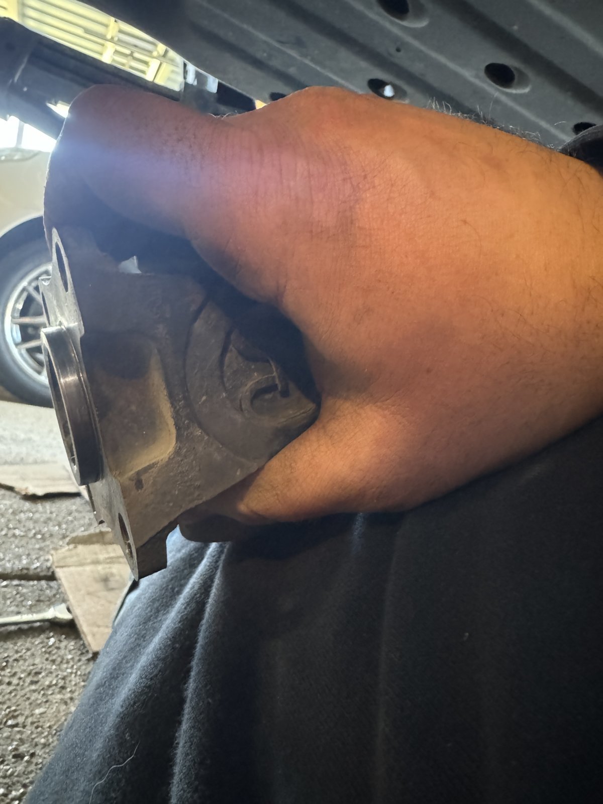

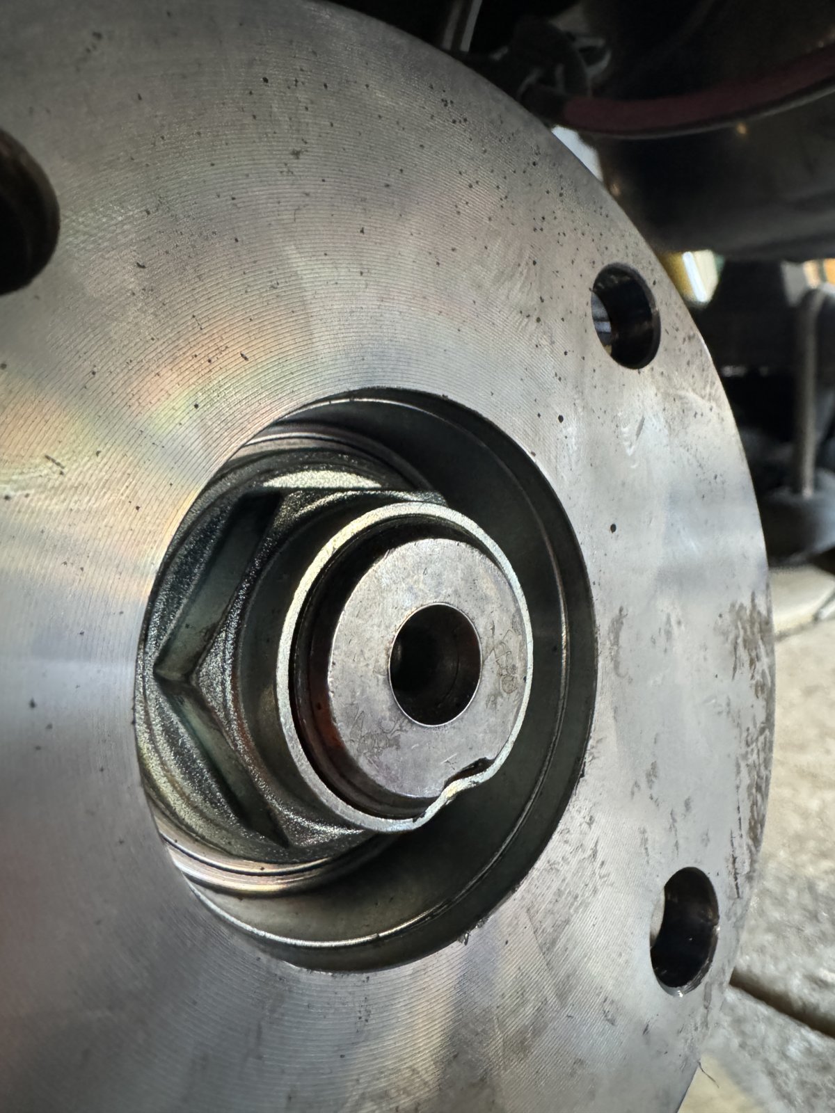

    All of that went fine, except during the install the rear driveshaft would not seat in the 8.4” yoke. The centering ring on the 3rd gen driveshaft yoke was too long and would bottom out inside the yoke on what appeared to be a machined very slight shoulder. It just barely would not seat, with bolts cranked all the way down. Pics attached.

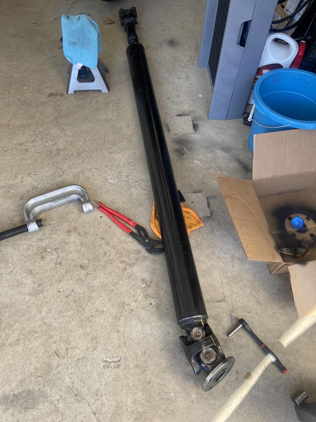

    To remedy this, I took a flap disc to the centering ring and sanded it down a bit. This got it to where I could bolt it up. I was so far into the install by the point that I found out the problem, that there was no way I was turning back and reinstalling the old diff. So sanding it was the fix.
    I am now getting some driveline vibes at 75-80+ that I definitely didn’t have before (I’ve had 5.29s for 10 months no issues). I am thinking my non uniform sanding is what’s causing the vibes but honestly I don’t know. Easiest way to rule that out is to buy the correct yoke from a 2nd gen, but from the Toyota parts sites I don’t see the part listed. Only entire driveshafts.

    If it’s not that, I wonder if it’s the flange. It’s brand new but I cranked on the bolts pretty tight trying to get it to seat. I hope I didn’t bend it out of true trying that. Though I went with a crush sleeve eliminator so I can just replace the flange if I have to.

    Thanks, that’s basically what I’m finding to be the only option so far. Every 8.4 pinion flange I can find has that shoulder, so I’m not seeing it as an option to buy a new 3rd gen 1350 yoke and just install a new pinion flange.

    I think for testing I’m going to remove the rear driveshaft tomorrow and go for a drive. If the vibe is still there, then I know it’s on the axle itself and not related to my flap disc sanding. I really hope that narrows it down.
    If I did in fact warp the flange, then I should still get a vibe. But I doubt I warped it, they’re decently strong.
    If I determine it is the rear shaft, then I’ll do the yoke and conversion joint, at least in the short term.

    I pulled the rear driveshaft this morning and went for a cruise in FWD. Hit up to 80-85 on the highway and there are no vibes. Must have been my sanding handiwork, which just barely knocks it out of balance at around 4300-4500 driveshaft rpm. At least that means I need to work on the driveshaft and not the wheel bearings or diff.
