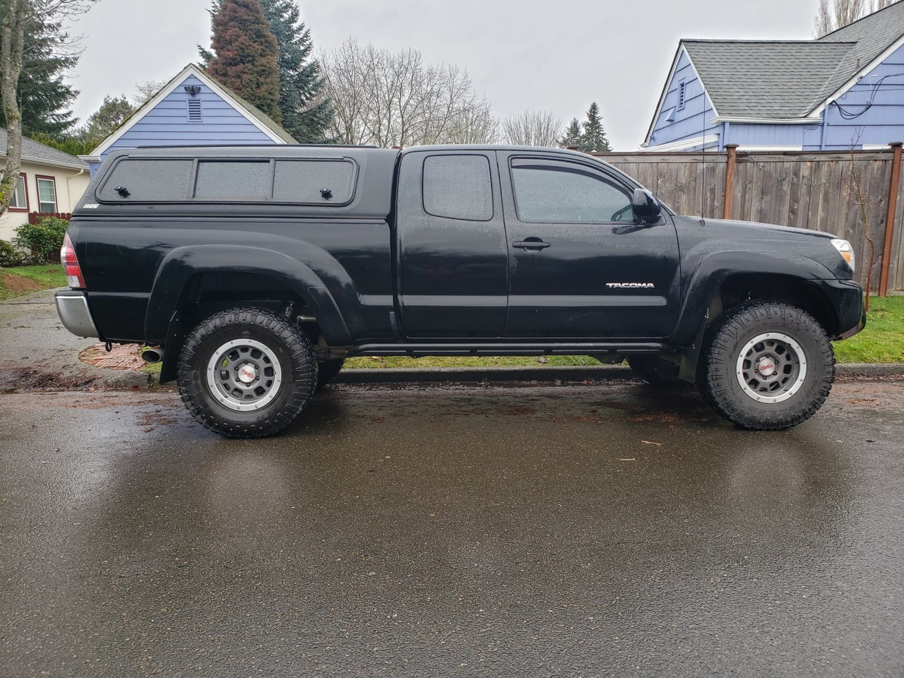

    Got a pic of it the way it sits? And how's the ride quality with that set up?

    2014 Tacoma Baja
    Ride quality is great IMO. The E rated tires are a bit rough though.

    That looks like the exact height im looking at achieving, maybe a little bit less.
    And yeah E tires are a bit stiffer, if i went with new tires i'd maybe go E just because of the gravel roads around me would probably eat up a C tire.
    What size you got on there? Looks good

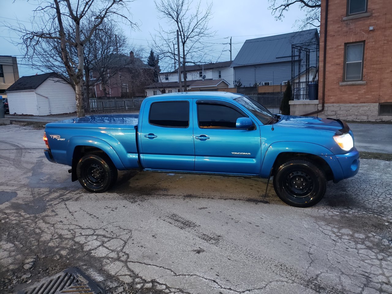

    This is my truck for reference, had it for a month and a half now and im pretty impressed with the tacoma

    I do like the E rated tires for the durability for sure! My tires are 285/75r16 aka 33". Currently, I have Goodyear Duratrac tires and I am not impressed with them, they are lackluster on wet roads. I will probably purchase Toyo Open Country AT3 next time around.
