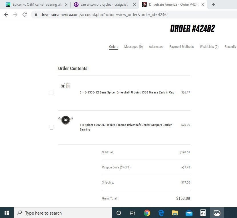

    Can someone please tell me the part numbers and which ujoints i need for the front two on my 06 tacoma 4x4? Double cab 4.0.

    I have a 06 Tacoma DCSB 4x4 and here's a screenshot of the parts that I bought. I ended up not using them because I went with a one piece driveshaft. 5-1330-1x

    I just went through replacing u-joints, all of mine were spicer 1330 or other brand equivalent. Word of advice, if the joint stops pressing in DO NOT add more pressure. That ended in a trip to a driveline shop to have a new yoke welded on.

    NOT Correct.
    Front shaft uses a different size U-joint than the Rear shaft.

    My front u-joint turned out to be the same size as the others. Not sure if the yokes got changed at some point but the 1310 and the 5-153x were both too small. The 1330 fit perfectly.

    Interesting.....
    My '06 Sport has different sizes on the front and rear shafts.
    Perhaps the Access Cab with long bed uses a different shaft combination.

    Doubt that. the 1330 is significantly bigger and wouldnt likely clear in the small area in front of the tcase.

    Well, a 1330 pressed in fine and hasn’t given me any clearance issues. The 1310 and 5-153 were too short by a significant amount.
    Edit: If there’s one further in front of the transfer case than that might be the one you’re talking about. The one I’m thinking of connects the front part of the driveshaft to the transfer case.
