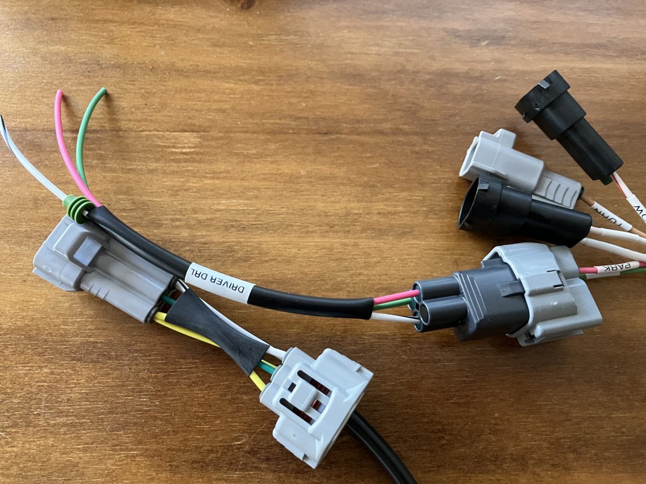

    Exactly, so why did you order one? If you intend to mate to a conversion harness, I'd modify the conversion harness directly to mate to your SR.

    The new adaptor harness has a female 4-pin (3 Wire) for the DRL just like the TRD headlights. To mate to my SR harness I would be cutting the 4-pin off the adaptor harness (like I did with the TRD halogen lights) and just soldering to the wires I added since there is no SR connector for this
    This will work but makes it a pain if I ever want to remove the lights. Also I should have ordered this connector when I originally did the TRD halogens so I wouldnt have had to cut this 4-pin connector off the lights.

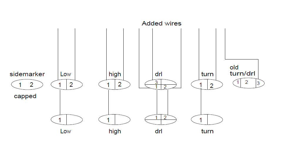

    I already have a 2-pin for turn that I de-pinned the 2 conductors from the 3-pin with 1 conductor still hanging out in the old 3-pin.
    This is my concept below. There is no gender exchange going on here. Will be straight plug and play.

    The idea is to run the configuration above so in the case that I ever want to switch back to TRD halogen lights, I simply disconnect the adaptor harness and the TRD halogen lights are ready to go. I have no desire to ever put SR light back in the truck and I'm probably wasting money here for the male 4-pin because I dont see the new LED lights coming out either - unless I was to trade it in.
    The drawing above was a quick reference. I realize the ground is missing on one of the connectors (high?)

    Bottom is the conversion harness?
    Assuming I'm correct on that then a 2 way there works and I'd stay female on the truck side and male on the harness side but I can see how you want to minimize work. I'd have your parking light signal (from that 3rd wire you aren't using) feed in directly and then add the new DRL signal to that, in a 2 way connector, and you're good to go with one crimp and a gender change on the conversion harness.
    It's kinda silly to use a 4 way for 2 wires. Makes sense on a TRD truck where it's already there but no real value on your SR.
    Basically I'd either stuff these:
    Into this:
    And feed to 3 way male on the conversion harness.
    Or, do a 2 way, female on the truck, male on the conversion harness:
    And cap the 3 way female with a male for waterproofing.
    NOTE, per the circuit above, you're using a low beam to turn dim mode on which is cool but not quite the same as TRD behavior. On a TRD truck, the parking light signal is active when the stalk is set to parking lights, triggering the sidemarker and the lower light/TRD/PRO emblem lights, then the C goes dim once low beams are on.
    So, I'd probably route the parking light signal as-is to your parking light input and just keep your 1 "high" or "bright" drl input on the drl signal since you already have a clean relay ensuring that goes off when low beams are on. Hence, I'd recommend using a clean parking light signal to feed to the light, either from your sidemarker or your 3 position orphaned wire.
    The upside to a female on the truck side is you have that wire ready to go, and you even have a connector, just need to mod the conversion harness.
    But, I realize I may not have explained this well and my preferences may not be yours on how to do things. If you want the plugs, they are SUMI-PG2's I believe.

    Ah, this is a potentially valid reason to do as you are planning. However, I think every single one of us who has gone OEM LED quickly determines that we'll never ever go back to that halogen headlight. I hear you, though, you want to convert your truck to a "TRD" trim as far as headlight connectors. That makes a little bit of sense given the work you've done so far to cleanse the DRL feed.
    I would re-think your low beam vs park to feed the "dim" input, I'd want my sidemarkers on w parking lights.

    I can agree with your bottom statement. I have yet to install the lights, so you're probably right that I won't like this functionality and change it down the road. This is all very good insight for future reference when I finally do install.
