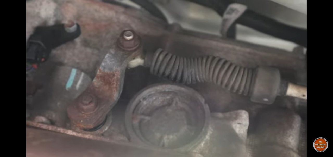

    Not sure what this linkage is called but was hoping someone could tell me and where to buy.

    That’s the automatic transmission shift linkage.

    That's surface rust. Remove the part, clean sand, paint, reinstall.
    Enjoy a tapas lunch with what you just saved.

    Oh hell yeah, thanks guys! yeah this one is surface rust, found the pic online, mines a lot worse.

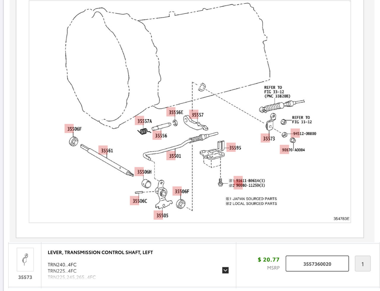

    Thanks TN, I have the manual for the truck too just couldn't find where it said the part name.
