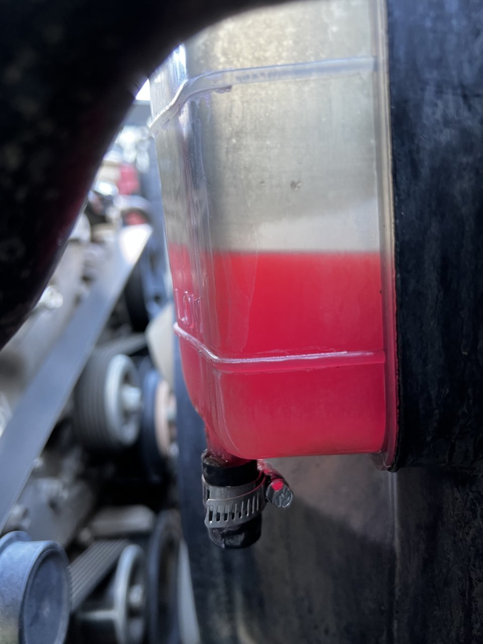

    Hello fellas
    anyone have the part # on this rubber piece
    That goes on the coolant reservoir
    thanks !

    you should be able to pick one up at any parts store...just vacuum caps

    Found the part # just in case anyone needs it
    90339-09011

    There is a reason most coolant caps are made silicon.
    While a standard vacuum cap will probably be ok in this situation as hot coolant is not in contact with it most of the time.
    I would rather have the silicone type if I were caping a component with hot coolant.
    Again, it’s not a big deal here.
    But there is a difference in regular a “vacuum” cap and a coolant cap.
