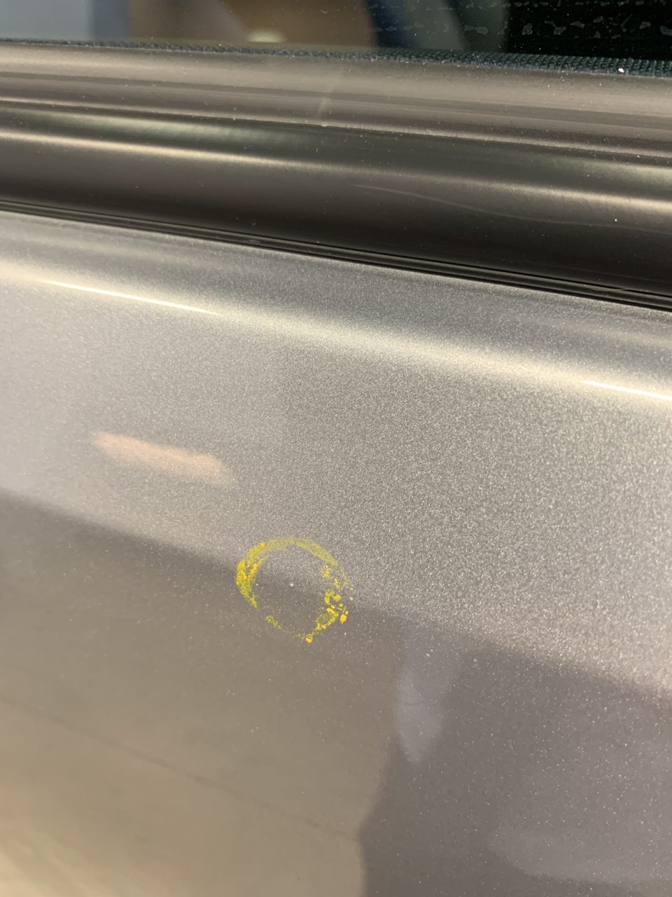

    i found originally found a bad spot in the paint on my New Tacoma the day after I bought it. Upon further inspection there are a lot of particles on almost every panel, over 20. I’m sick about it and don’t know what to do. Toyota came and looked and will fix it, but then I have a new truck with body/ wet sanding done all over it. Even if they repaint the truck it does not come with a warranty and will likely fade or peel in 3-5 years.
    What are my options? I think I should be able to return the truck. It came off the truck w 0 miles. I realize no paint jobs are perfect but something odd happened here. The dealer. Toyota. And I agree.

    Pic for your reference

    Bad paint doesn't make the truck a lemon. If Toyota is having it repainted, then I don't see the problem. The paint on Toyota vehicles in notorious for being weak. Let them do the repaint and move one.
    EDIT after picture posted: I have a couple of those on my paint as well, but I drive freeways every day and it already has rock chips alot worse than that in year 1. I would not have even complained about that in the paint unless it was huge or in large clusters.

    There are a few clusters of 4. I get what your saying but it doesn’t seem like the quality I expected. The Toyota guy said repaints peel after 3 years all the time.

    It is dirt particles trapped in between paint layers. Probably was a spot touched up either at the factory or dealership. I personally wouldn't worry about it. You have 3yr 36000. My Dealership warranties for life of ownership if they paint. Always remember if it is sanded and buffed they have removed life off your paint job. I Painted for and ran a Paint shop at a Toyota dealership. You rarely ever see one come off the line that way. Its been re-coated somewhere.
