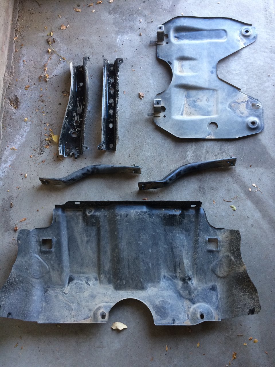

    What are the 2 items on the top left and the 2 items in the middle called? I can’t remember for the life of me, I’m going back to stock and need to order bolts for those 4 items and need a name to give the guy on the phone. Thanks!

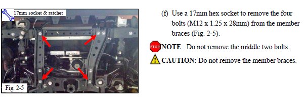

    Member braces... Here's your bolt sizes
    Edit: Attached source of information (Pro skid plate installation instructions)

    But Jesus, that's like $200 in parts... Are you just taking a skid plate off? Might be cheaper to leave it on.

    I got the bolts ordered from Toyota for 70 bucks, I’m going back to stock and selling my skids and sliders and lost some of the bolts for these items lol.

    When I added the TRD skid plate to my '17 sport I only needed to remove the factory plate and a hand full of screws...those in the middle weren't part of the install instructions in my case

    I have the b a m f trilogy skid, I couldn’t remember what exactly I took off and on lol.
