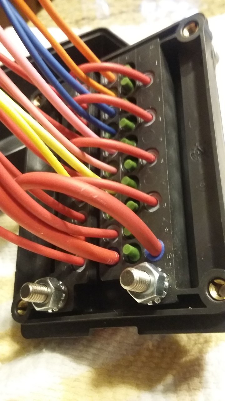

    @Sandman614 I'm just getting around to setting my Bussmann RTMR up. I ordered 1 relay with an additional 10ga lead to power up onboard air however it looks like the 10ga lead is in the switch position and the 18ga is in Accessory position how do I correct this problem
    thanks
