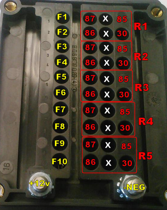

    I'm not putting anyone on the spot but I just got word of another person not knowing that the Bussmann box needs grounded. Please refer to these pics

    Guilty. I couldn't find the original write up.

    Is the negative the ground?

    Correct.

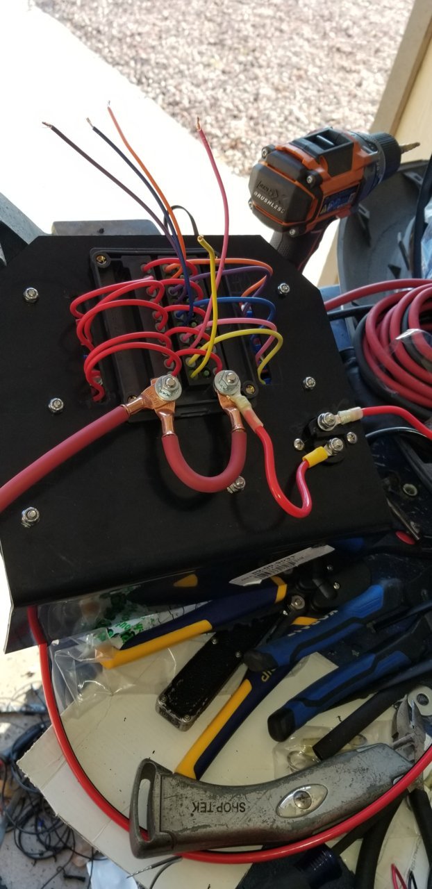

    I can show you what not to do. Lol

    Cool. If you have a picture, let's check it out.

    So the jumper red wire is were the ground is supposed to go. On the right. I was lucky and nothing burned out. So now all my red wires are on the left and the ground is going to the lug on the right
    I'll try and get a pic of the correct wiring next week.

    Also, that Neg lead is only for the Neg side of the relay coils right? So that wire can be a much smaller gauge than the Pos lead as I recall

    I believe so. Mine is 6g but I used it for all of my grounds and it runs to my battery.
