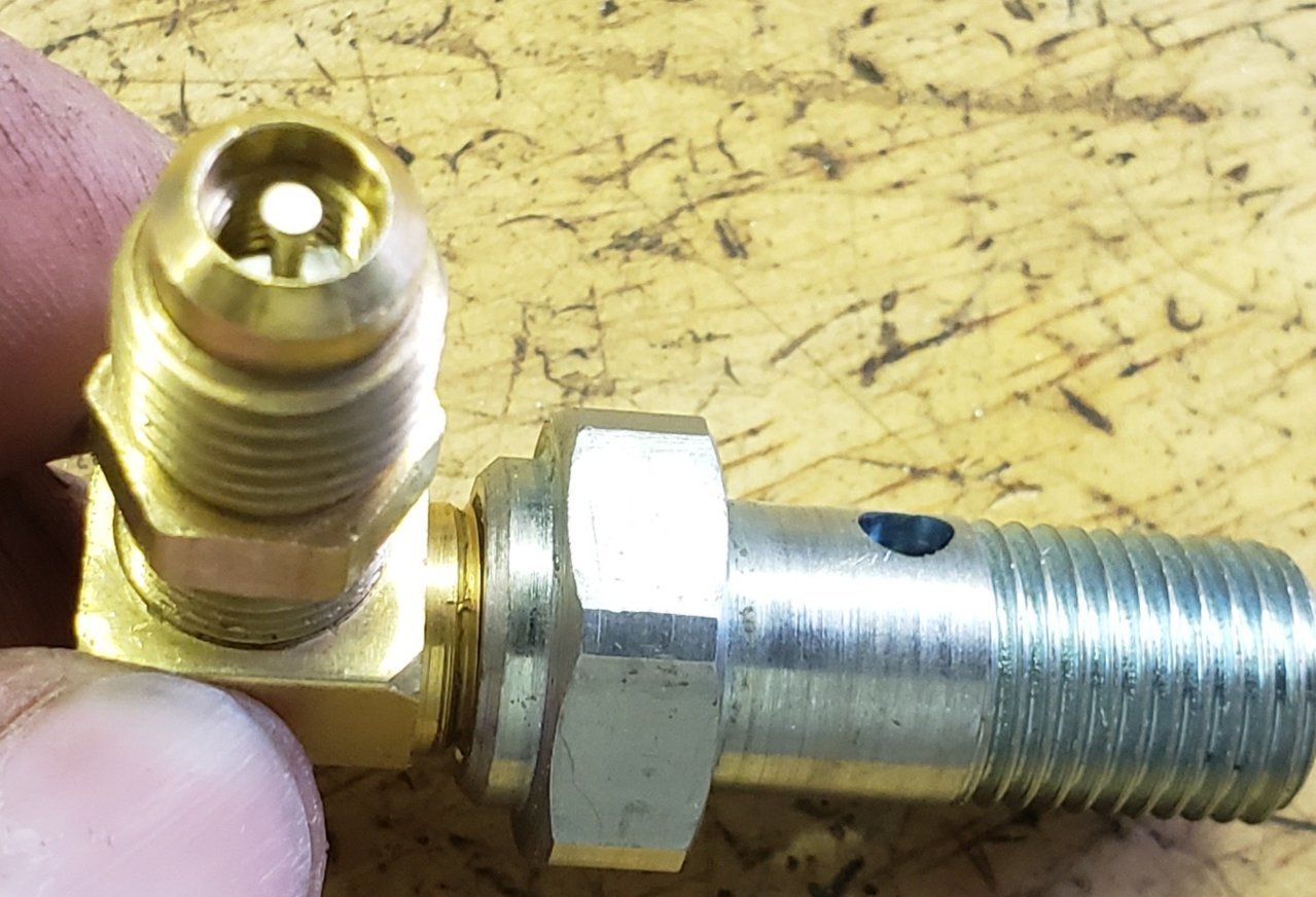

    Through three separate threads here on TW I was able to piece together the:
    1) Russell tapped banjo bolt (Amazon)
    2) street elbow (Amazon)
    3) Schraeder valve (dieselorings.com)
    I understand there are surely other sources but this is what I used. Criticism welcome but links to products (or specific ASIN) or it didn't happen.
    1) Russell banjo bolt was ordered as Amazon ASIN B000CPJI8I
    2) street elbow was ordered as Anderson Metals on Amazon ASIN B003U94022
    3) Schraeder valve was ordered from dieselorings.com as their part #13-005

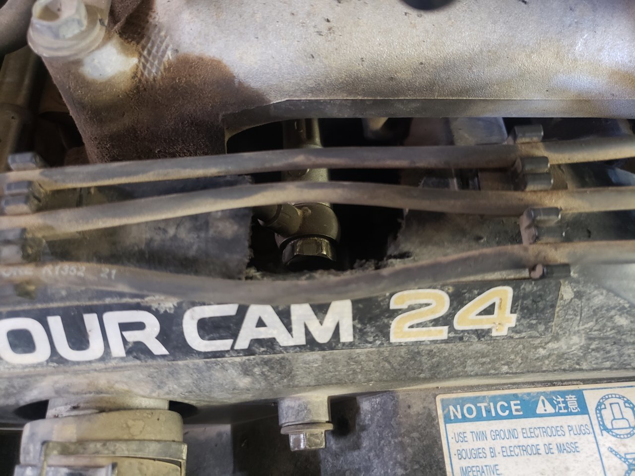

    After pulling upper rad hose clamp and timing cover forward and you'll need to remove the banjo bolt (17mm) from the LH fuel rail and then:
    1) install the Russell banjo bolt (18mm)
    2) install the street elbow (13mm)
    3) install the Schraeder valve (7/16" deep socket)
    I failed to get pics of it installed! Too busy!! Use Permatex #2 or PTFE tape on the pipe threads and check for leaks if you plan to drive it while monitoring fp.
    I also used my OMT to clearance the upper lip of the timing cover-- there's really no other way to run the hose of a fp gauge down there.20220816_214017.jpg 20220816_095854.jpg
