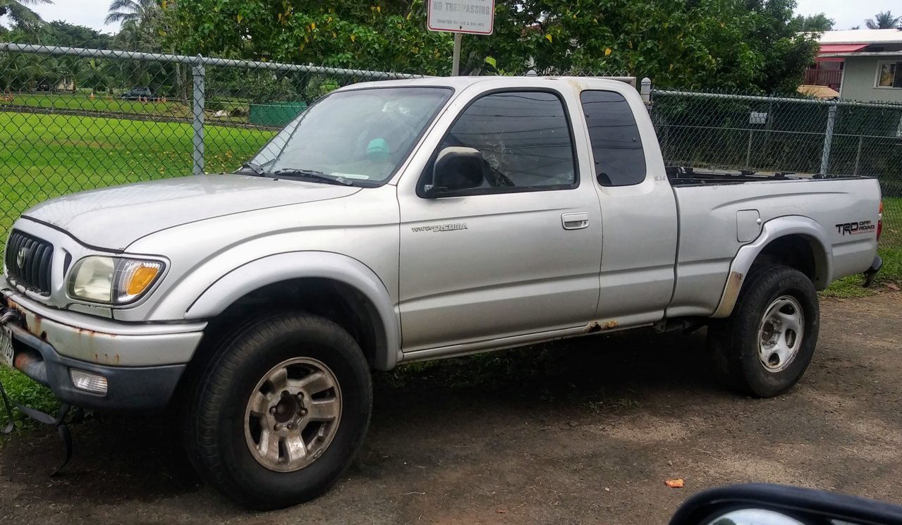

    20191105_141135~2.jpg Will parts from this truck fit my 2001 double cab prerunner?
    I do not know what motor it has in it... I'm more intrested in the steering rack, fenders, brakes, lights, etc... My motor is strong.

    Actually, it is a prerunner V6.

    Well yeah, it's a first gen. 100% of those parts will fit your truck. Especially since it's the 2001-2004 model revision with the same front end and interior.
    Don't need the title for a parts truck.

    the bed looks like it may be worth 1000 bux unless rust is worse than I see.
    Frame shot? If not, I wouldn't part it.

    I'm pretty sure the frame is shot. Look at the condition of the front bumper and rockers. Hawaii, too. Ocean spray.

    See the seat belt tied to the front? That's a make shift tow strap... It's not running. it been sitting there for months. it's going to scrap after I strip it.

    Oh yeah. Good eye.
    Go to your favorite U-Haul and rent a tow dolly. Unbolt the rear driveshaft so the transmission isn’t spinning.

    Before you tow it, check the frame for rot. If it’s in anyway rotted you need to flatbed it. It isn’t safe
