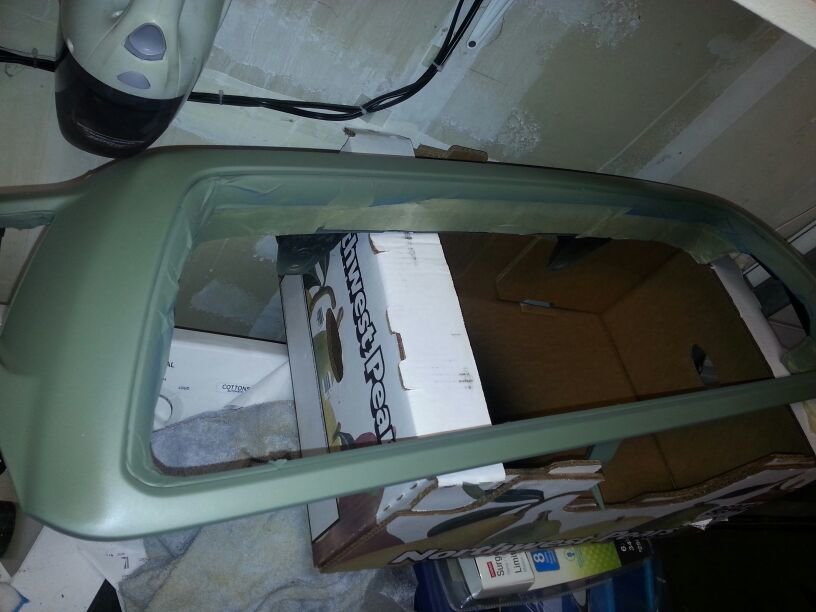

    I borrowed 1 when I was color matching my own OEM chrome grille.... I the fit is OK but not perfect. The grille comes in 2 pieces iirc andnu gotta plastic weld em or epoxy them to stay together.
    Just get some sand paper, rough up ur OEM grille, get some self etching primer, some duplicolor paint and clear coat and u should be happy.

    oem chrome..........excuse the NO SWAYBAR lean :)
    sanded (barely) and used self etching primer (grillcraft mesh removed)
    colormatched and grillcraft reinstalled............sorry I dont have a better pic yet
    happy to help....................worst case, get a partsgeek and use it as a loaner grill until ur done colormatching your OEM grille. I just happend to be lucky enough to borrow a loaner from DTF
