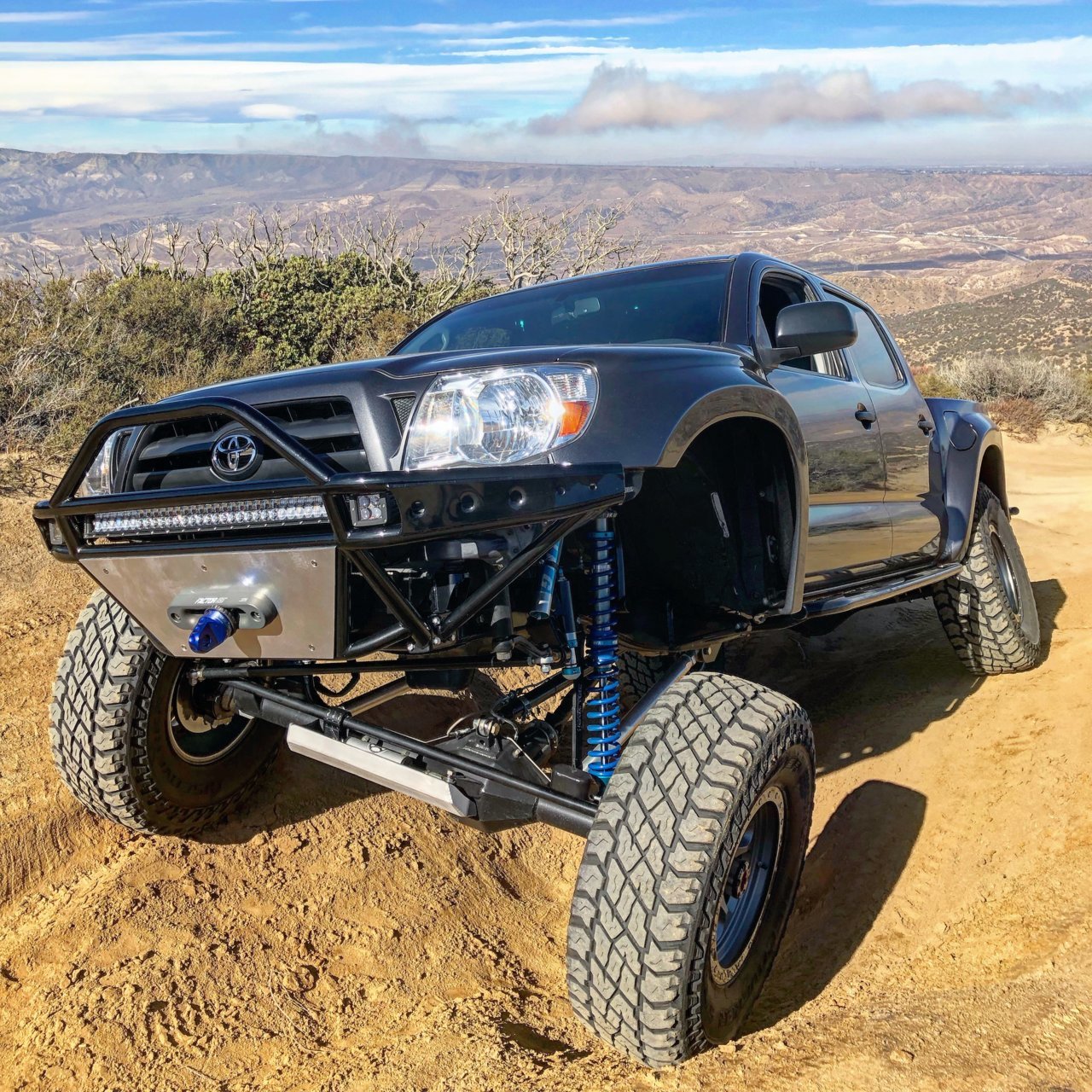

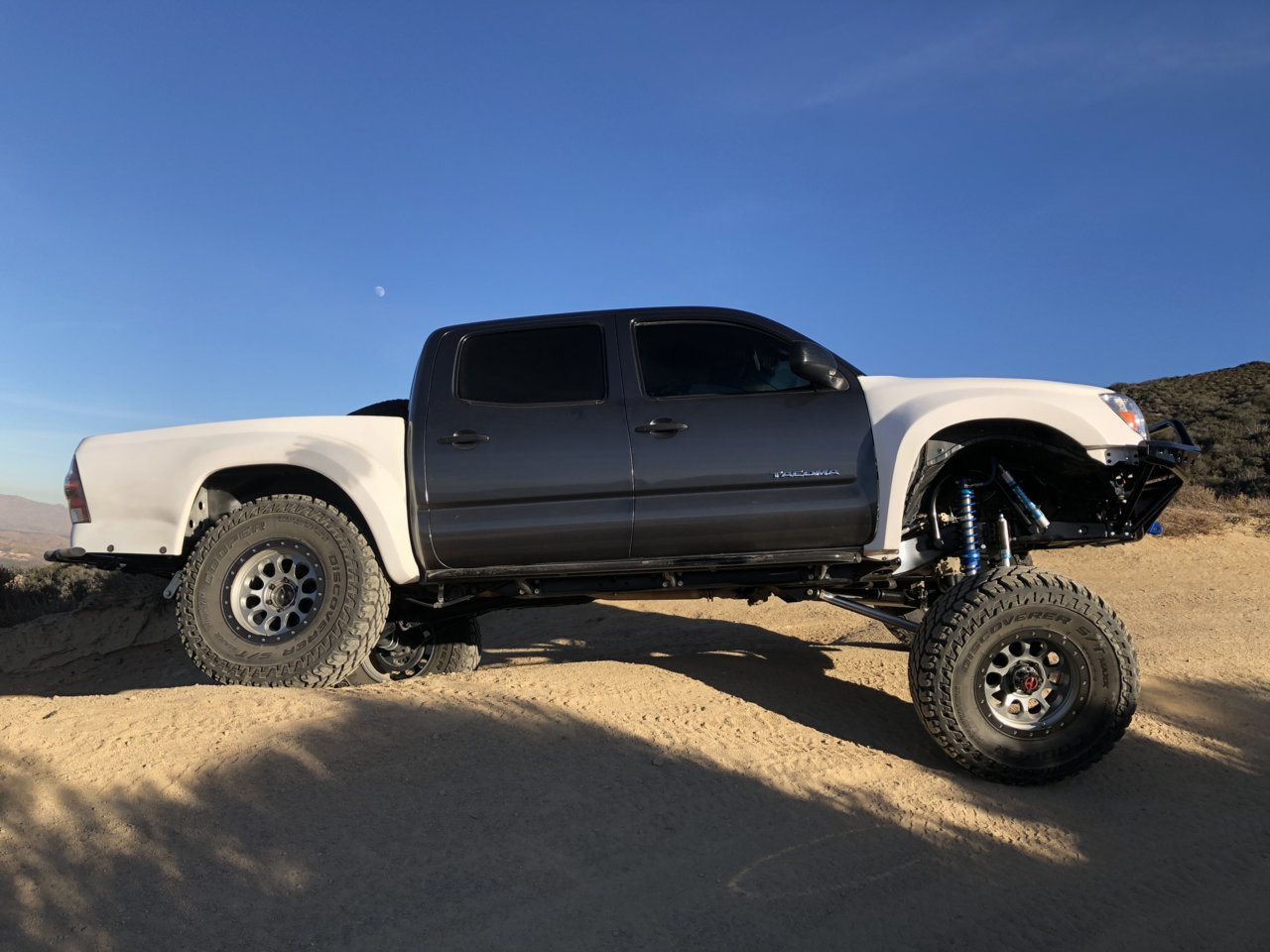

    Hello, Just wanted say thank you for looking at my build and sharing what has been two years buying parts and saving mucho $$. The goal for this build is a do it all daily driver! I go wheeling almost every weekend and camp on the trail when work schedule allows.
    https://www.instagram.com/throttle231/
    2011 DCSB TRD Off Road V6 6 Speed Manual.
    Build Pictures on Page:1,2,5,6,8,9,11,13,14,18,20,22,23
    Front:
    • Complete 67" wide Diamond Front Axle,FJ80 High Pinion 3rd Member, 5.29 Gears, ARB Locker, Hy-Steer Kit, RCV 30 Slpine Axles, Locking hubs.
    • Custom 3 Links
    • Custom Link mounts
    • Custom steering mounts
    • Custom Frame Plates
    • Custom Shock Hoops
    • All Pro Full steering kit
    • King 2.0 x 12" Dual Rate Coilovers with reservoir
    • King 2.0 x 2" Bump stops
    • Hydraulic assist.
    • McNeil Front 4" over fenders
    • Front bumper will be one-off build
    • Front Cali Raised (1) 32" Light Bar (2) 3x2 Pods
    • Smittybilt Gen2 Winch with Synthetic rope
    • Factor 55 Fairlead
    • Factor 55 Prolink
    Rear:
    • Archive Garage Custom Deaver Leaf Pack
    • Archive Garage Hammer Hangers
    • One-off Cantilever set up
    • U Bolt Flip kit
    • King 2.5 x 10" Bypass with reservoir
    • 5.29 Gears
    • Custom rear bumper
    • Rear Cali Raised 2 6" Back up light Pods
    • Rear Cali Raised Amber dust Pod
    • McNeil Rear 4" over rear fenders
    Tires/Wheels:
    • (5) 37" x 17" Cooper St Maxx
    • (5) RAY 10 Matte Gray
    Electronics:
    • S-Pod with custom rocker switch
    Protection:
    • Custom one-off rock sliders/old man steps.
    Part-2 wish list;
    • Link the rear??
    • Diamond rear axle
    • Marlin Crawl box
    • J.E Reel Drive Lines
    Current status...
    This is what she looked like before the adventure.

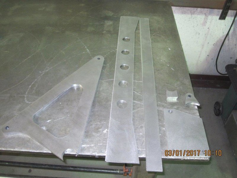

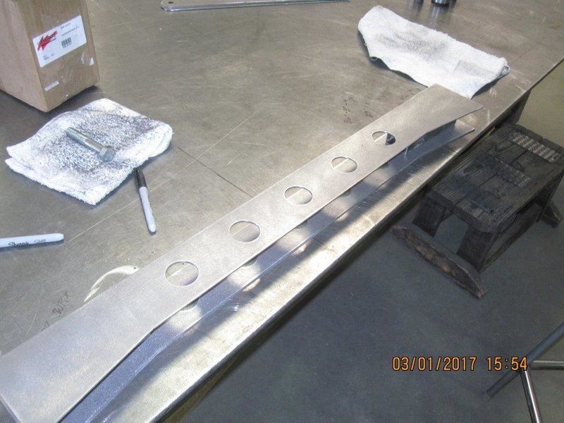

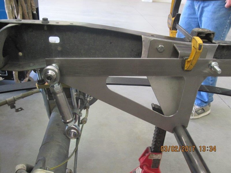

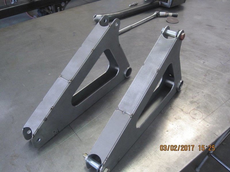

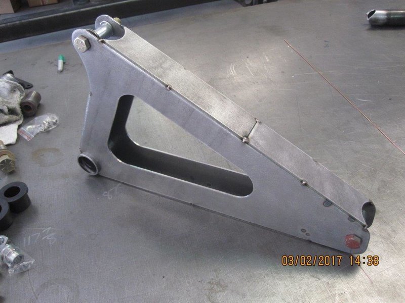

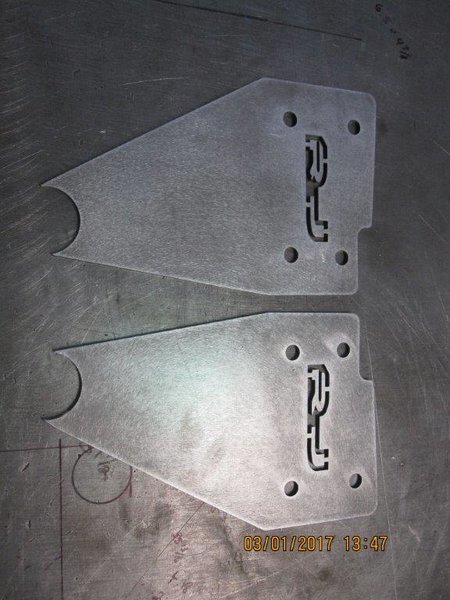

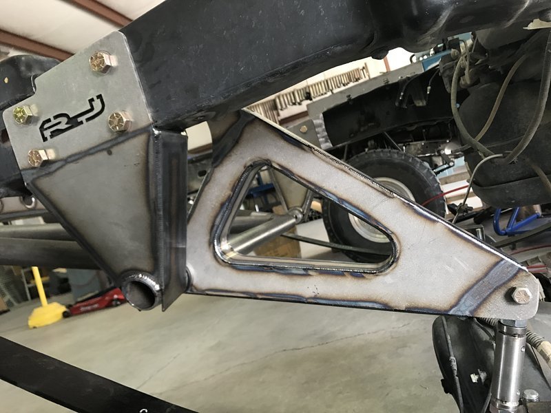

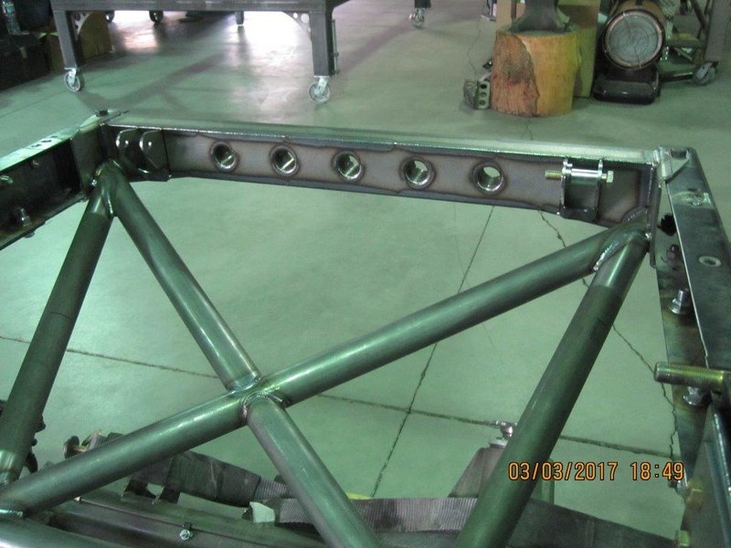

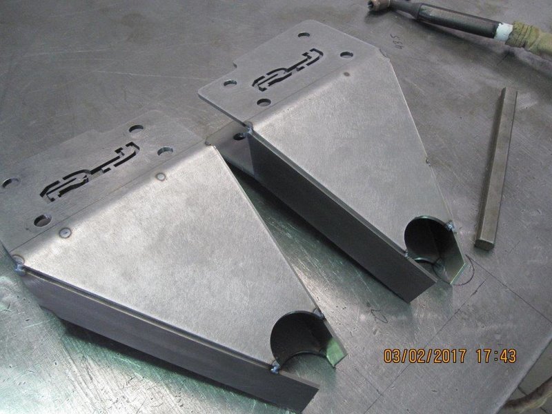

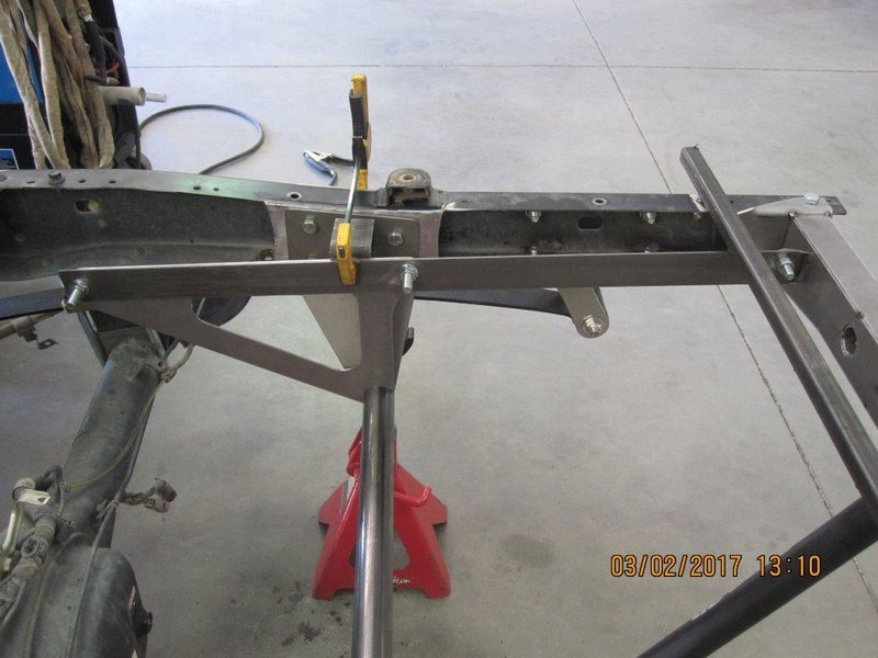

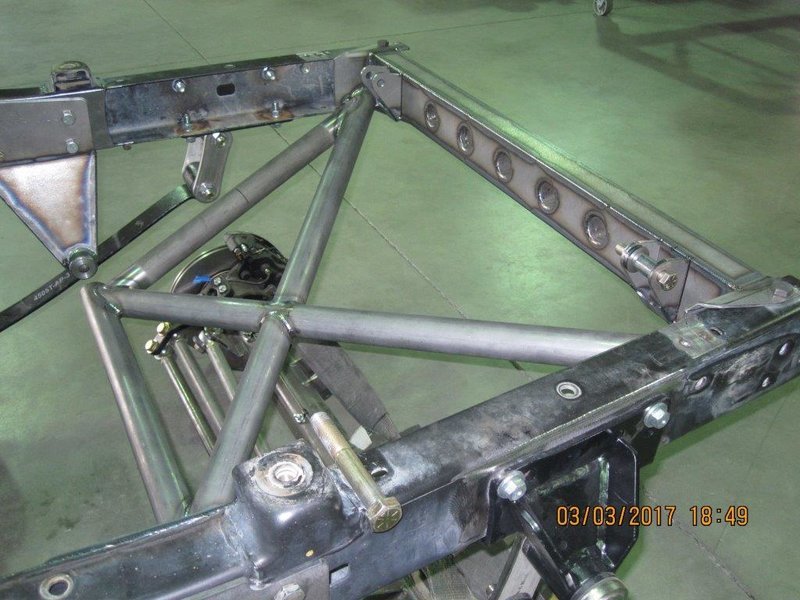

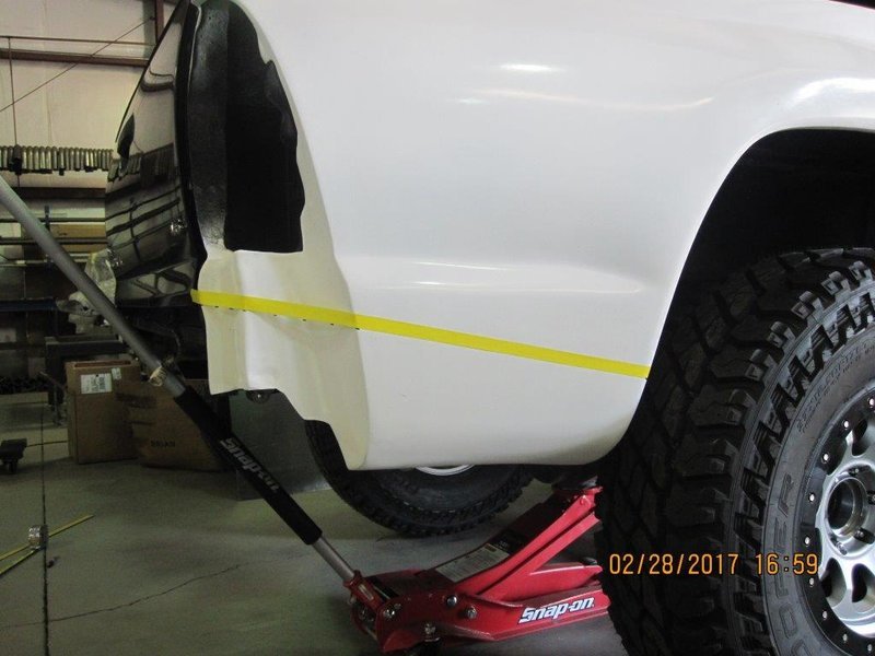

    Then the wallet started hurting...The rear was started...Its a one-off Cantilever Built by RJ Fabrication cycling at 13" for now. The kit is all bolt in and was designed to pull 18"+ with spring under or Linked only using a 10" shock.
    Next batch of pictures are different stages of design and build.

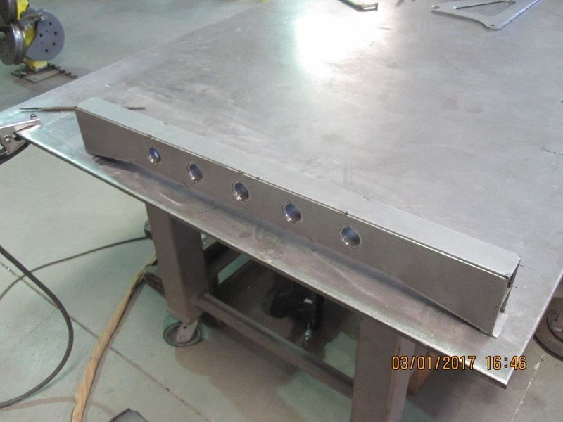

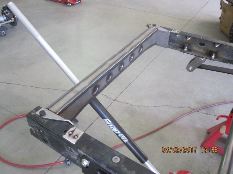

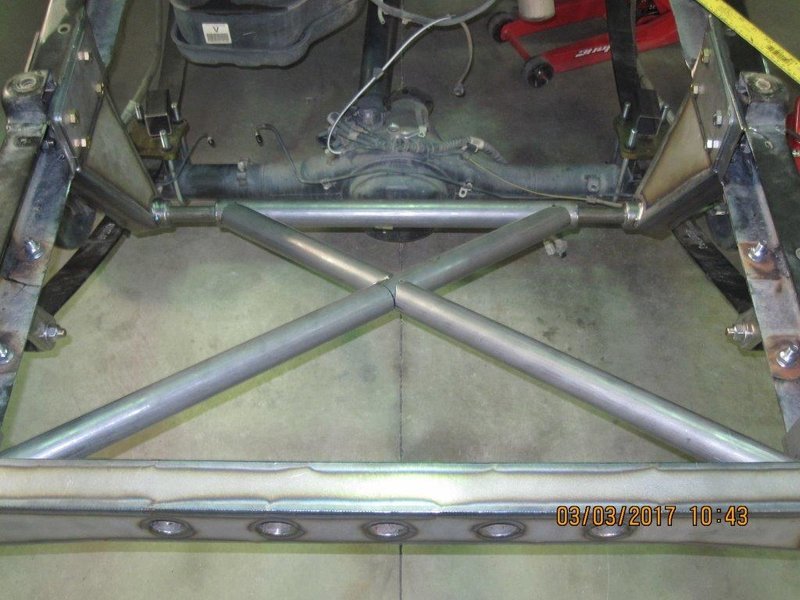

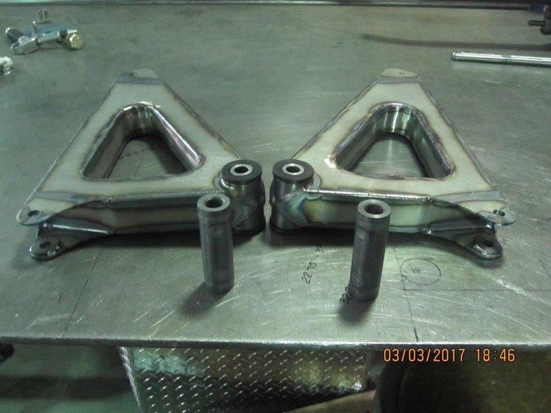

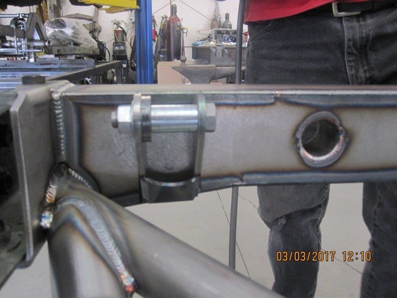

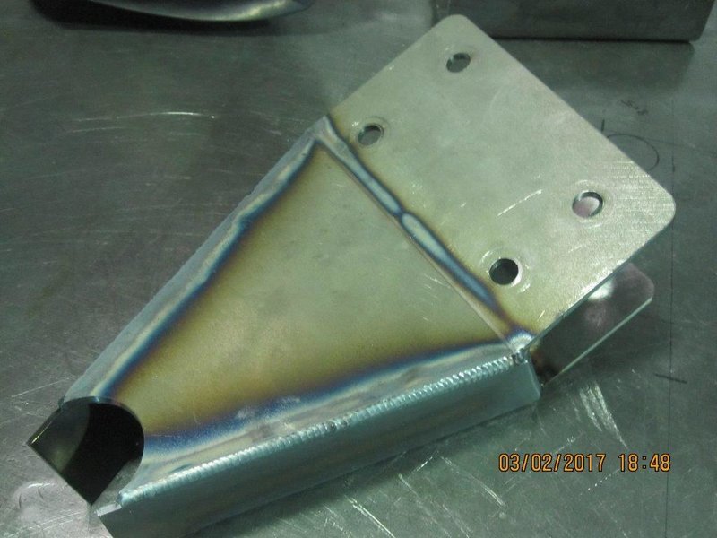

    Let the TIG welding begin...
    037.jpg 064 (2).jpg 065 (2).jpg 069 (2).jpg 071 (2).jpg 085.jpg 067 (2).jpg 076.jpg 088.jpg 089.jpg 080.jpg

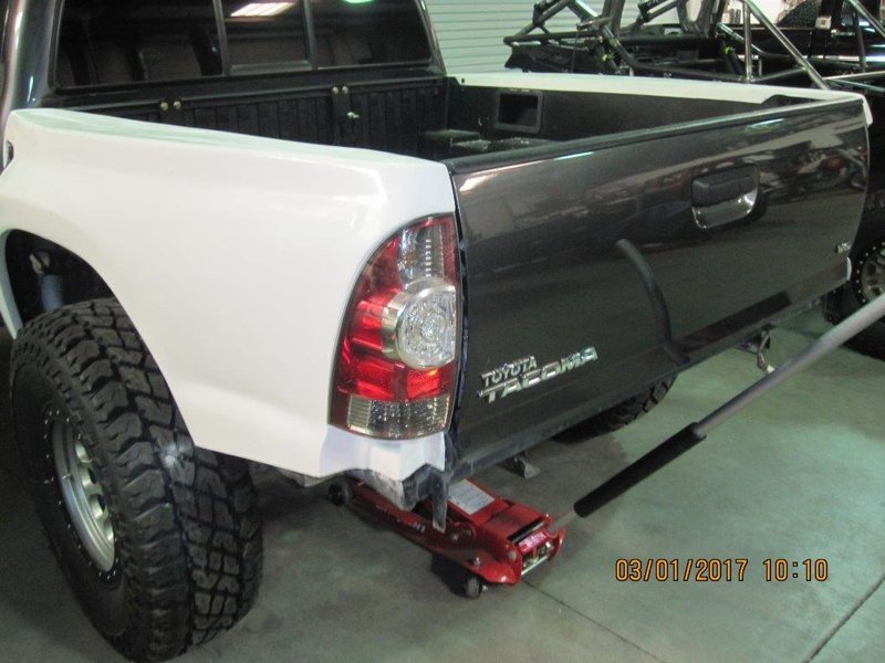

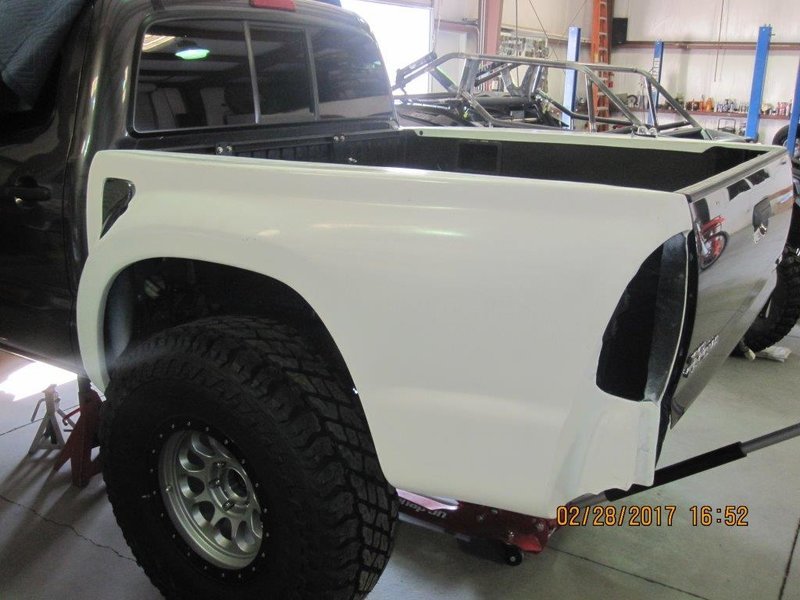

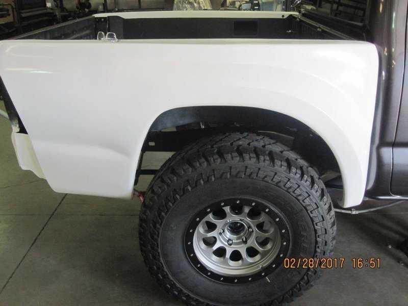

    Still more clean up needed and mount the Bumps/brake lines/gears...The Rear Glass was fitted and behind the wheel cut up for clearance. A custom rear wrap around bumper in works...
    Under the tail light bumper cap notch will be filled in flush with brake light...
    Below shows how they look trimmed up...
