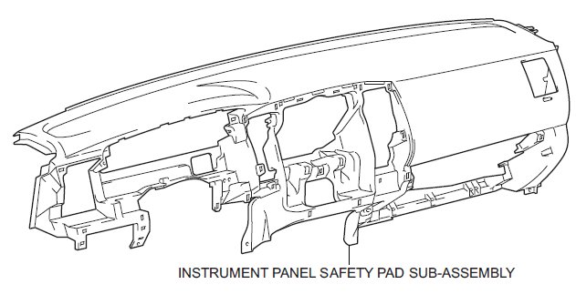

    I just bought a 2006 4x4 Tacoma that is Salvage title. The passenger airbag went off and ripped through the dash. Can the dash be replaced?

    Replacement is not an easy job.

    Yes it's just very expensive. The air bag, sensors, and the dash have to be replaced.

    Mostly right.
    Air bag and dash, but the SRS ECU will have to be reset to factory ($50).
    Sensors don't need to be replaced unless they were destroyed physically in the accident.

    Thats actually helpful to know, thanks!
