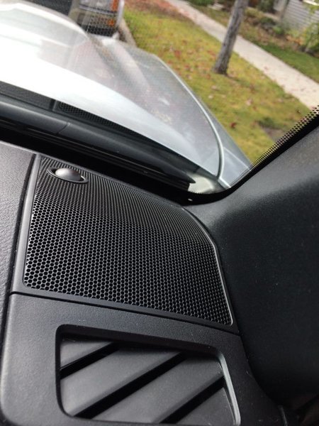

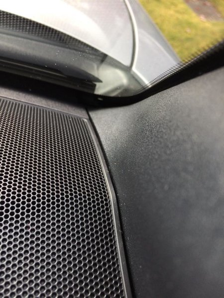

    The plastic on the A pillar comes into contact below the speaker cover plastic and makes the creak.

    That's my guess of the general area also. Once it gets above about 60F, no creaks but anything below and it'll drive you nuts. I can push on the dash and it makes the same sound.

    Exactly! If I have a passenger in the truck and they push on the speaker cover, it'll stop.
