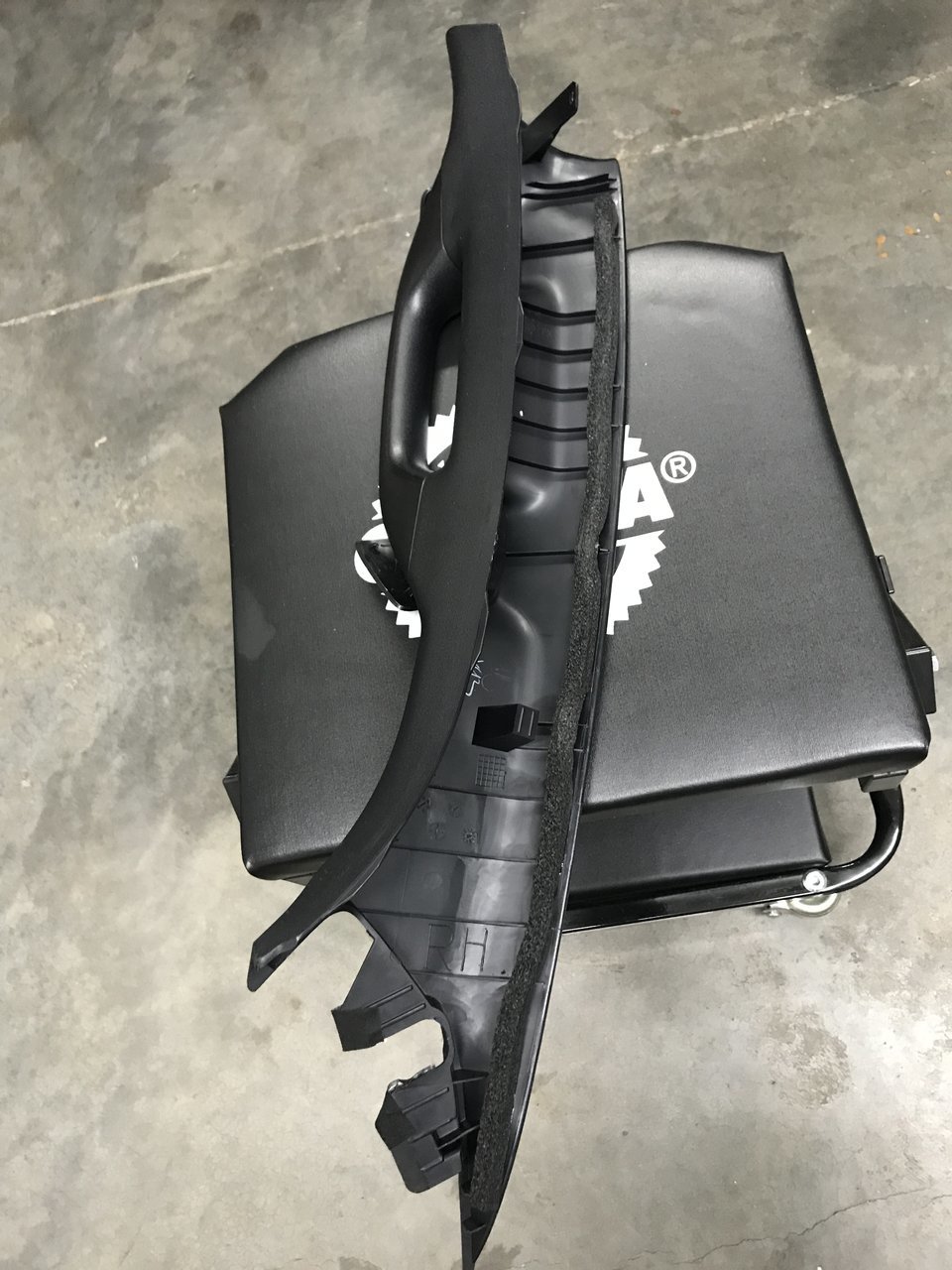

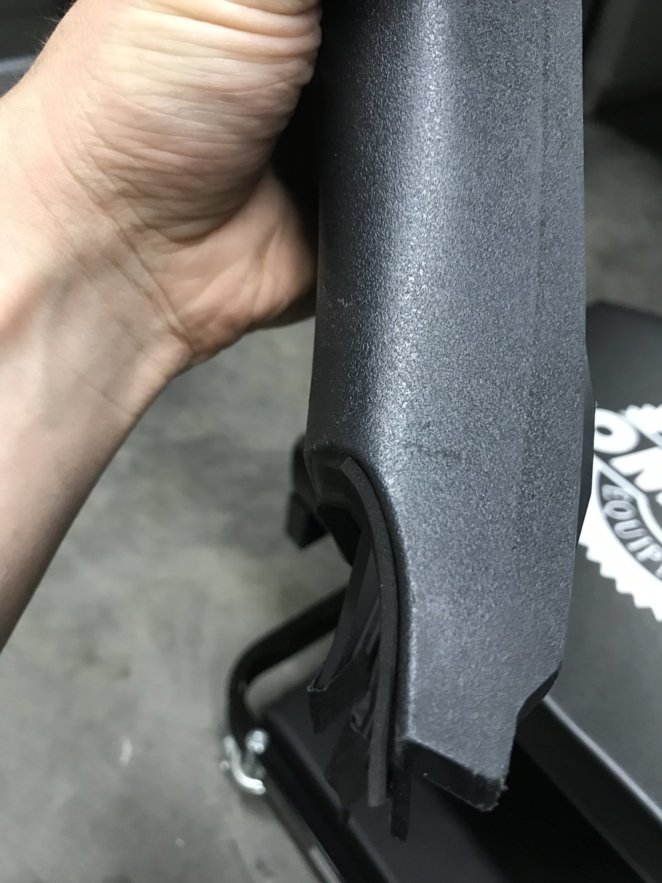

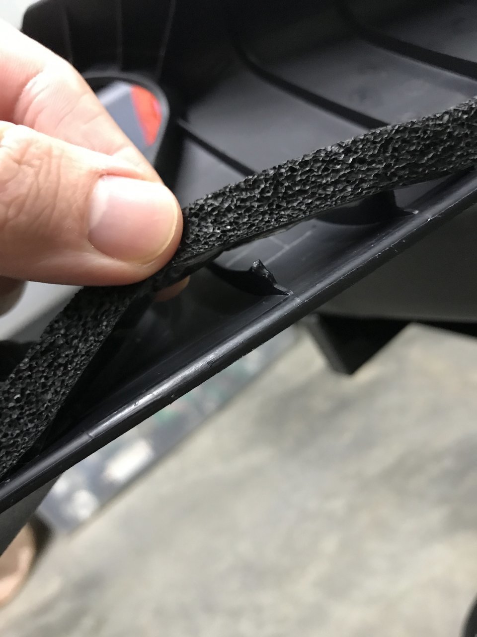

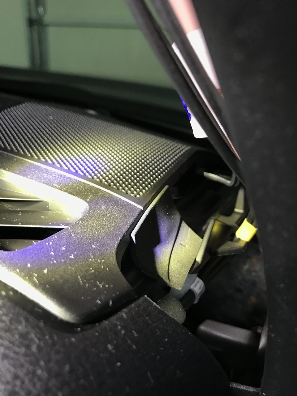

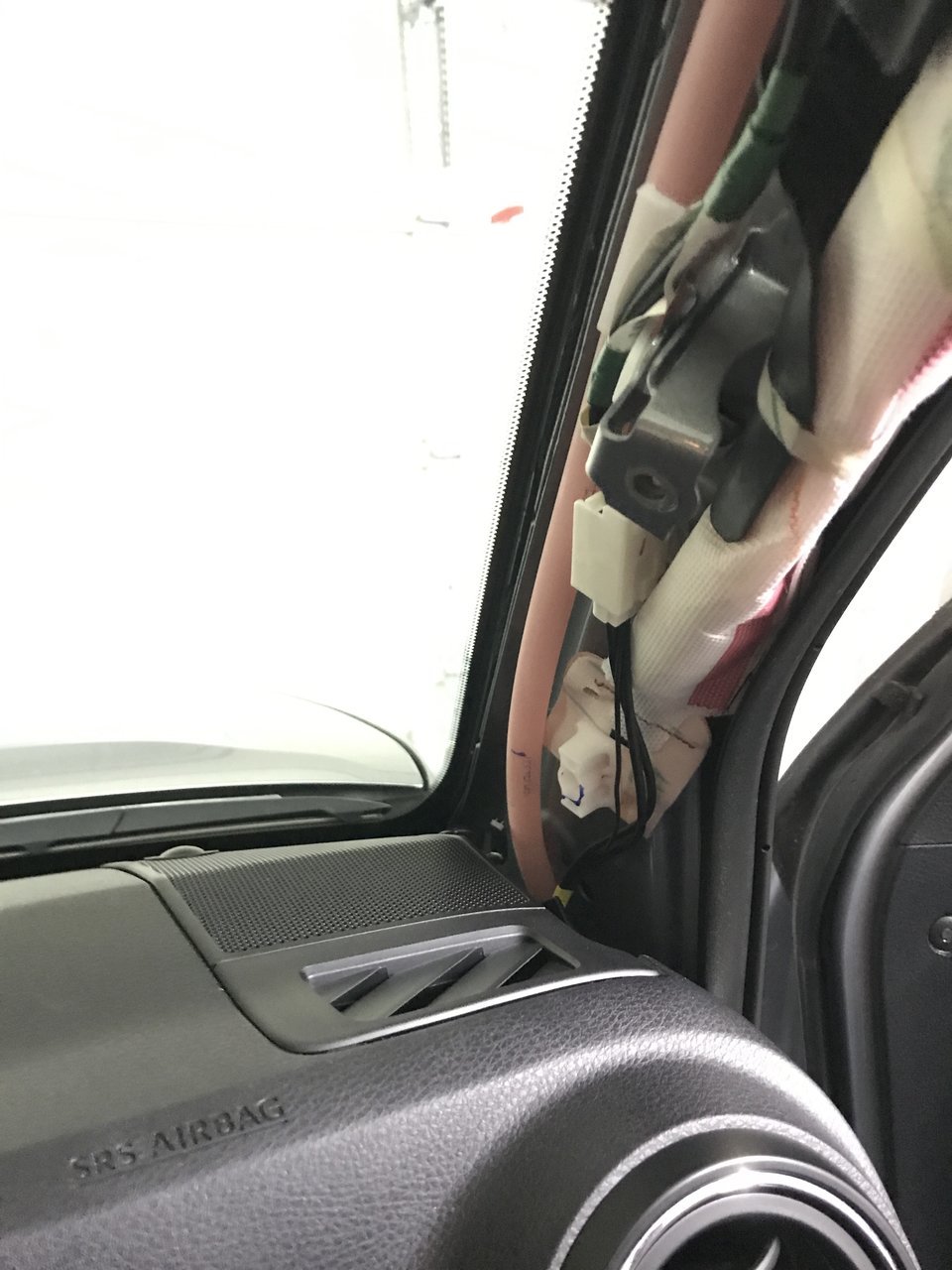

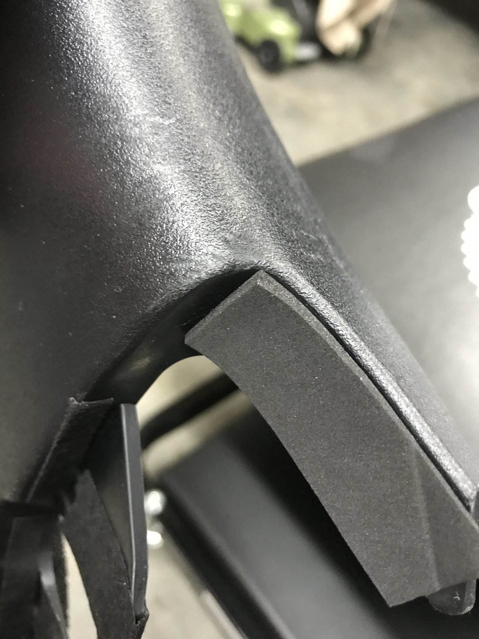

    IMG_6827.jpg IMG_6828.jpg IMG_6832.jpg IMG_6834.jpg IMG_6831.jpg IMG_6830.jpg
    I decided to fix it myself. There are no "clips" that snap the A-pillar into place, only the (2) 10mm bolts in the handle. This allows for play near the speaker cover. Aside from that, the cheap foam lining that they use to dampen the trim does not make contact and or adhere with all of the plastic. When I tapped this area, it sounded like the "rattle" that we hear when it's cold. I bet it gets brittle when it's cold and just rattles between the plastics. I used some double-sided tape to adhere this, then added some 3M foam in areas to make it more snug. BOOM!

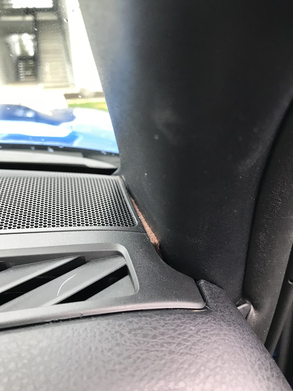

    Since I was upgrading the tweeters I decided to hit this as well. Only had brown felt but nobody is looking there anyway :oops:
